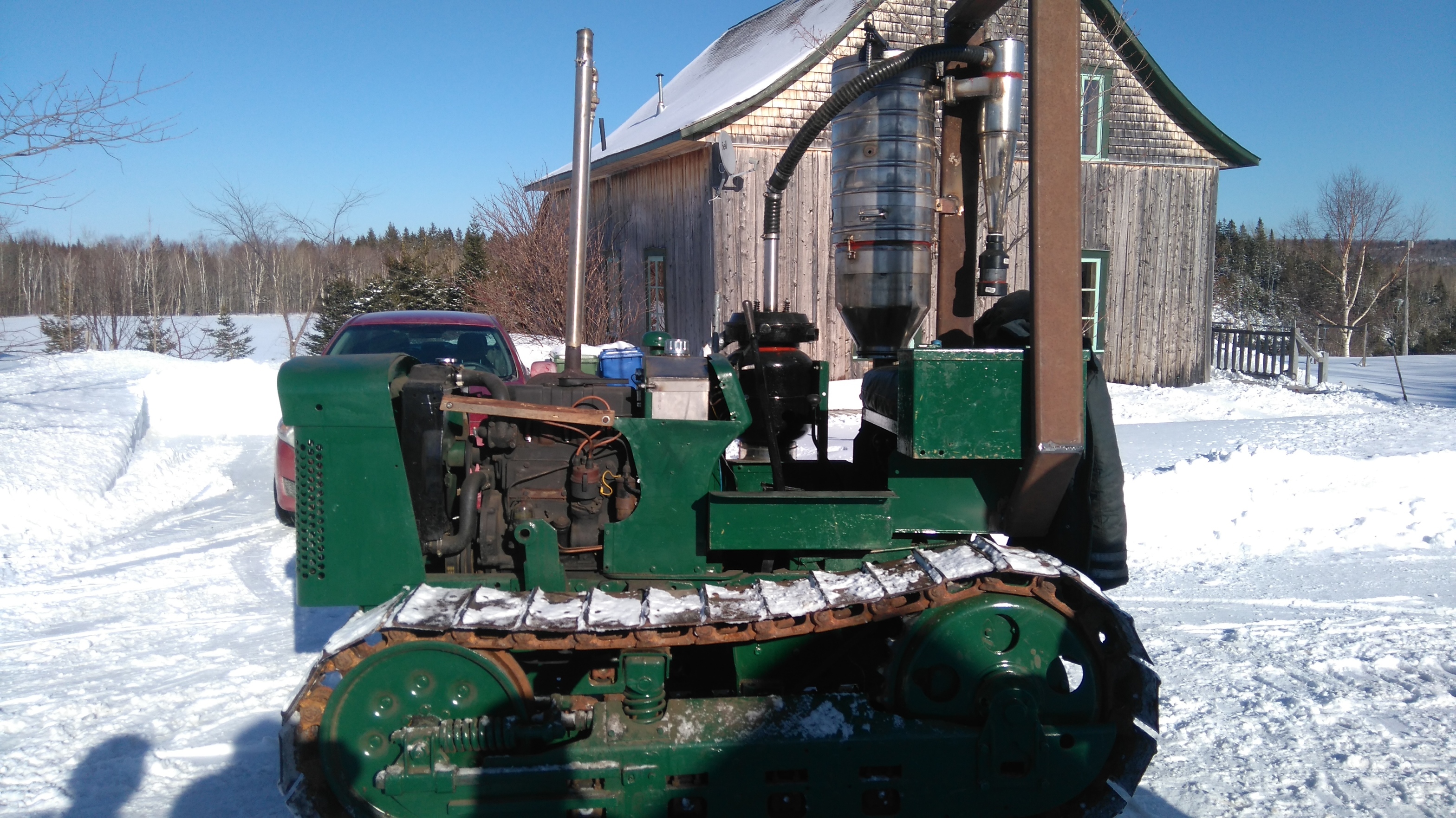

Finally concluding a first try on my tractor oliver
I started on the coal gas very easily. (This engine is not running very well with gasoline).
After 20 to 30 minutes of operation, the hopper was nearly empty.
Can I recharge the charcoal into the hopper without stopping the engine of my tractor?
I have some pictures. I will try to load here if I find how to do this.
I had to immediately share this event with you.

What a neat looking small dozer and running on coal gas,too. It’ll be nice to see pics of your build.
What a fantastic looking unit you have , makes me wish we had kept our little crawler now .
If this is charcoal unit then as far as I am aware you have to stop engine to refill your hopper . but it will restart almost immediately once the lids back on and the air is sucked out of the hopper .

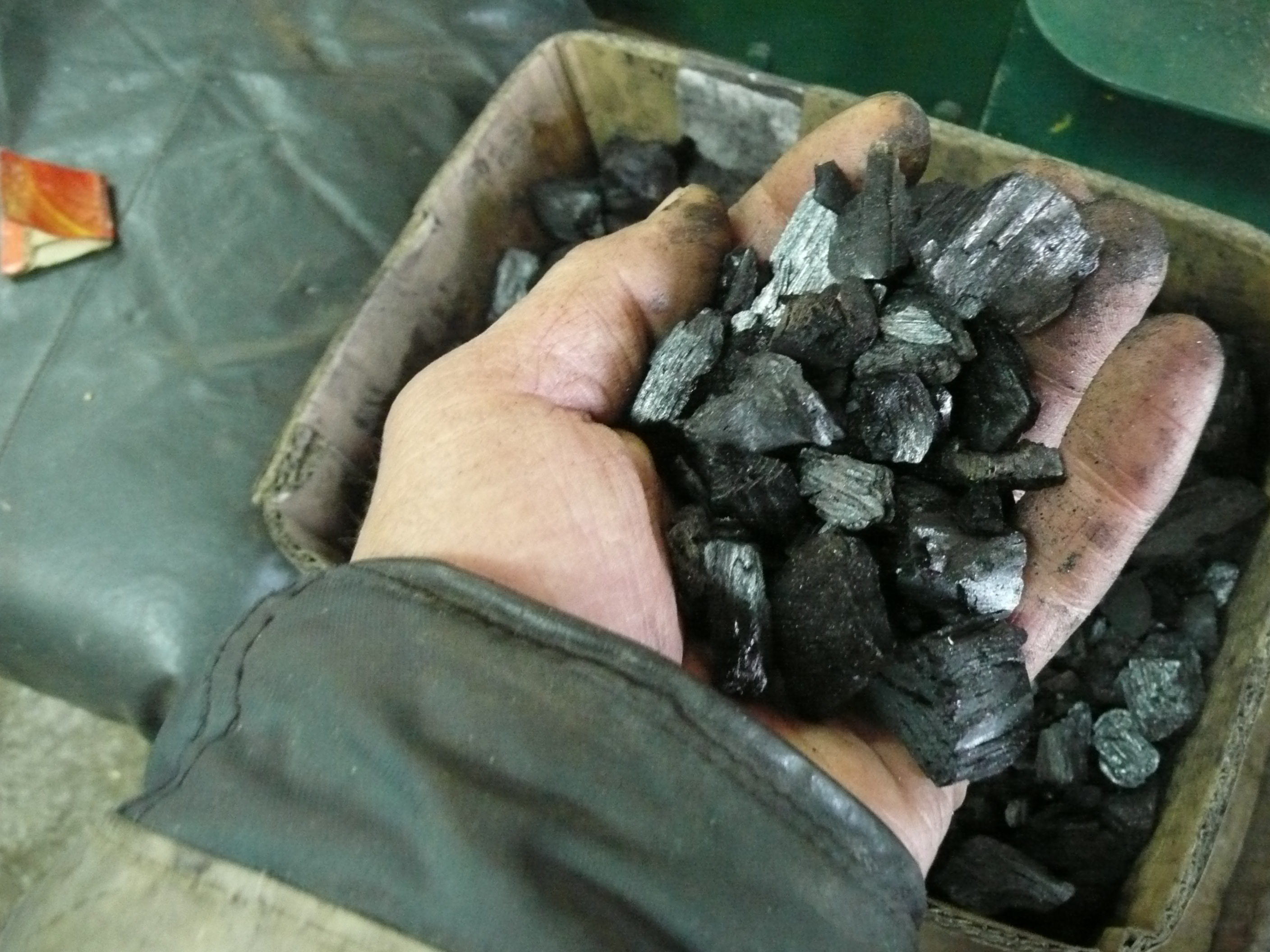

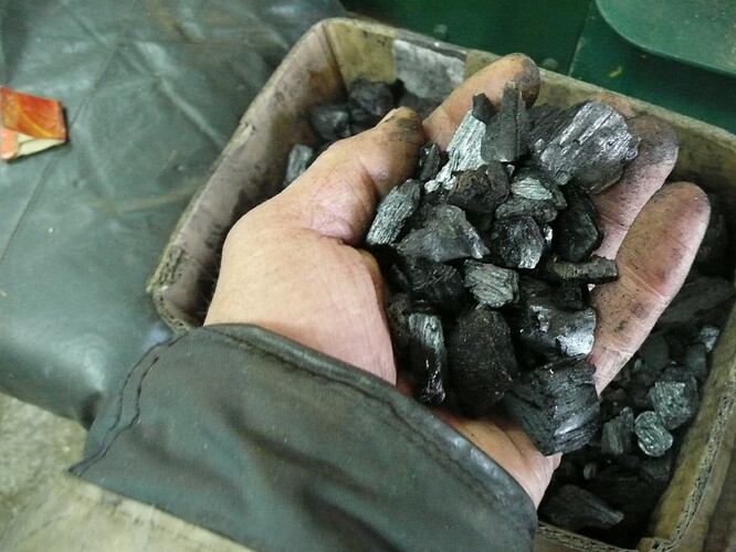

Coal was burned very quickly. is this normal?
Aproximately 20 liters of charcoal 25 in 30 minutes
Charcoal is made of spruce wood

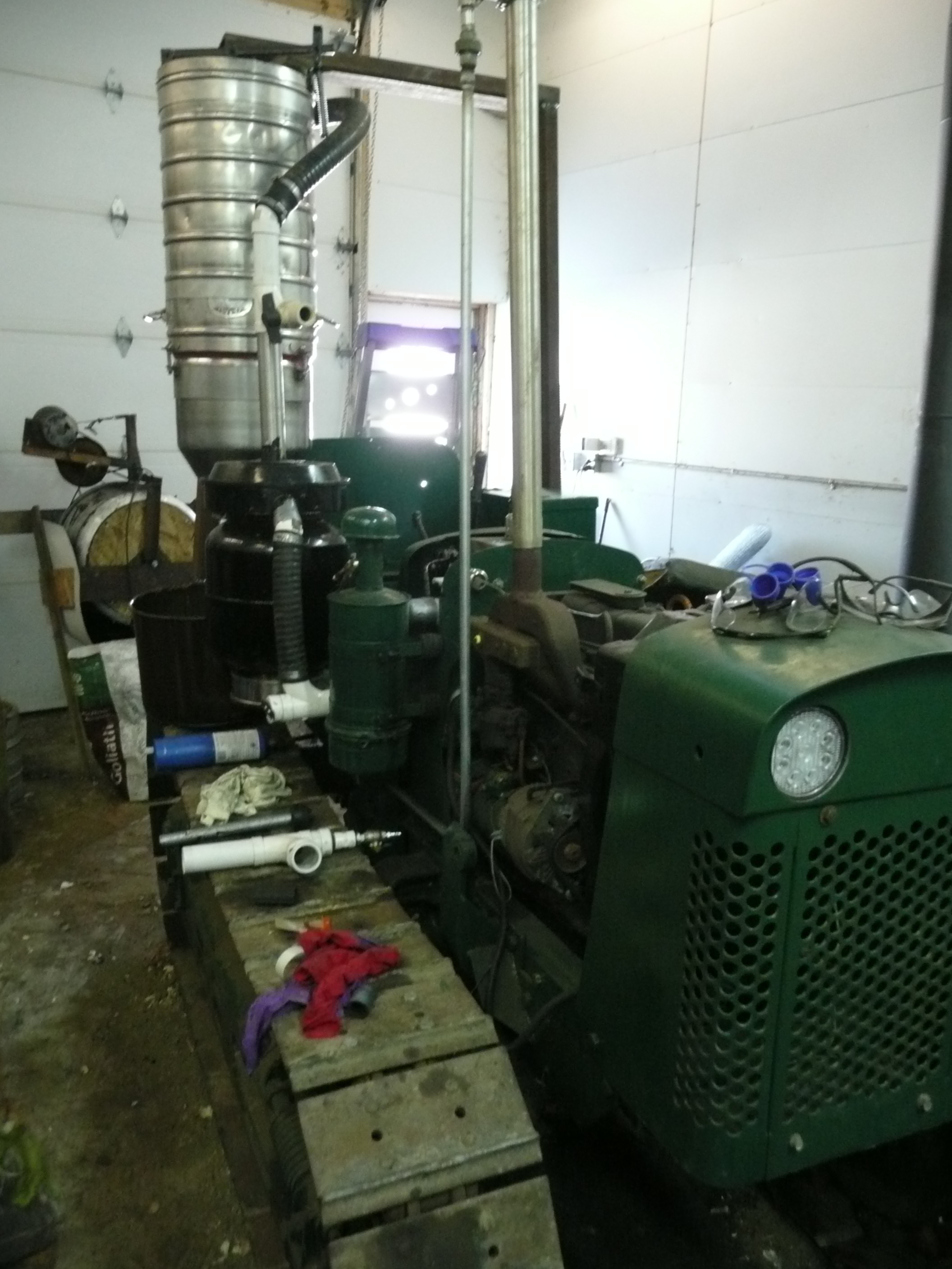

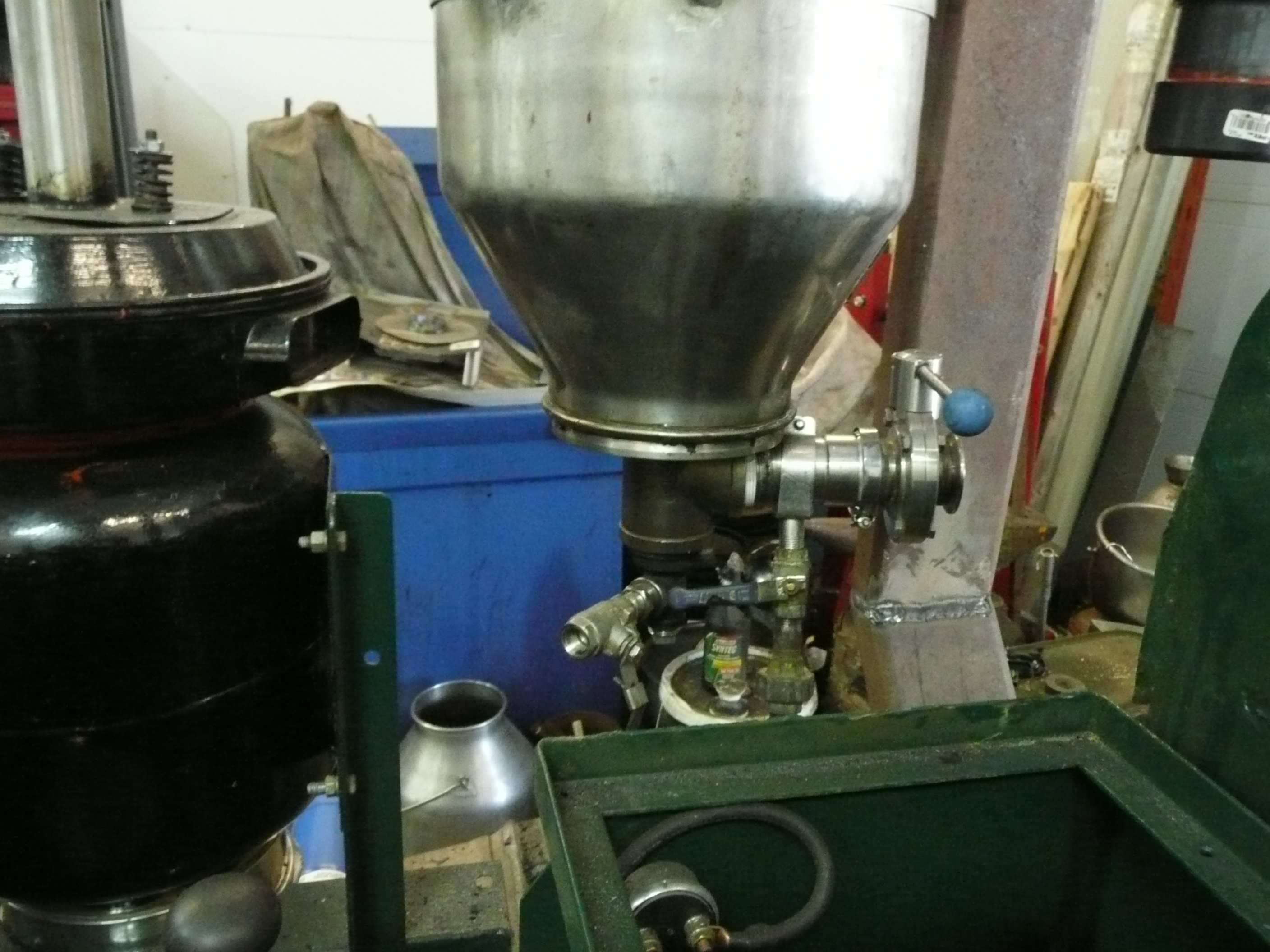

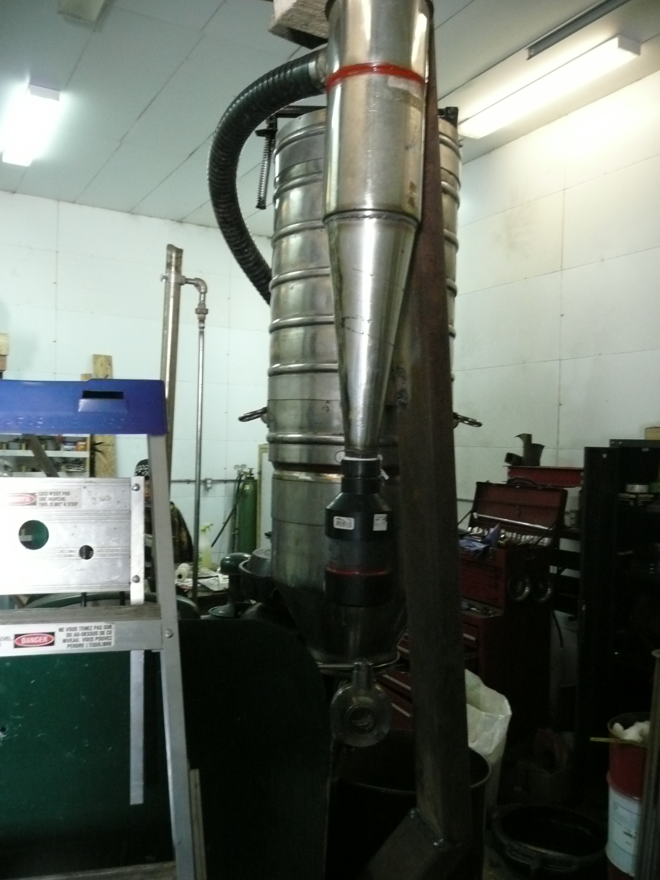

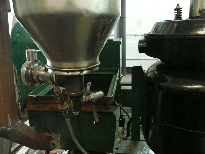

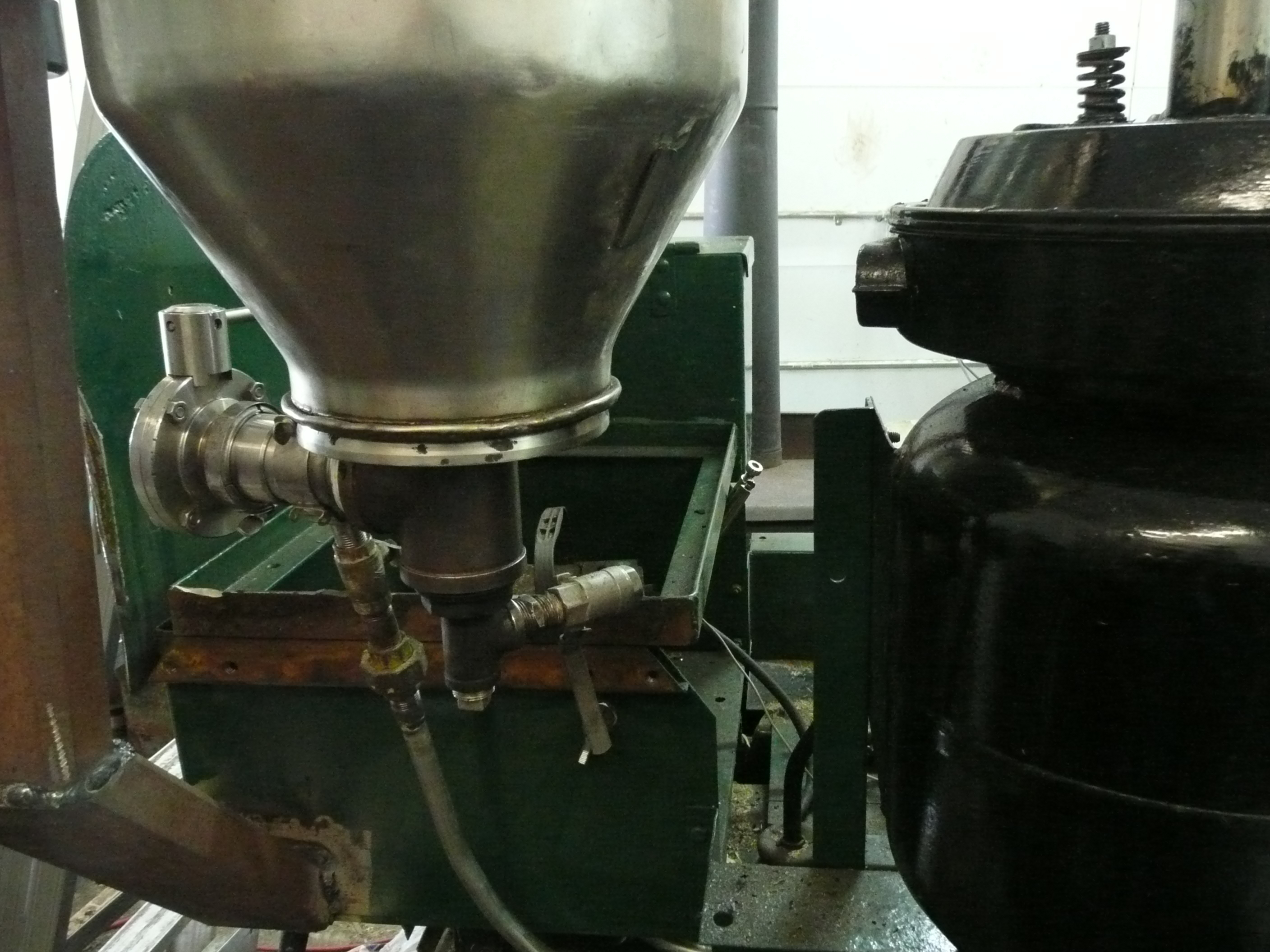

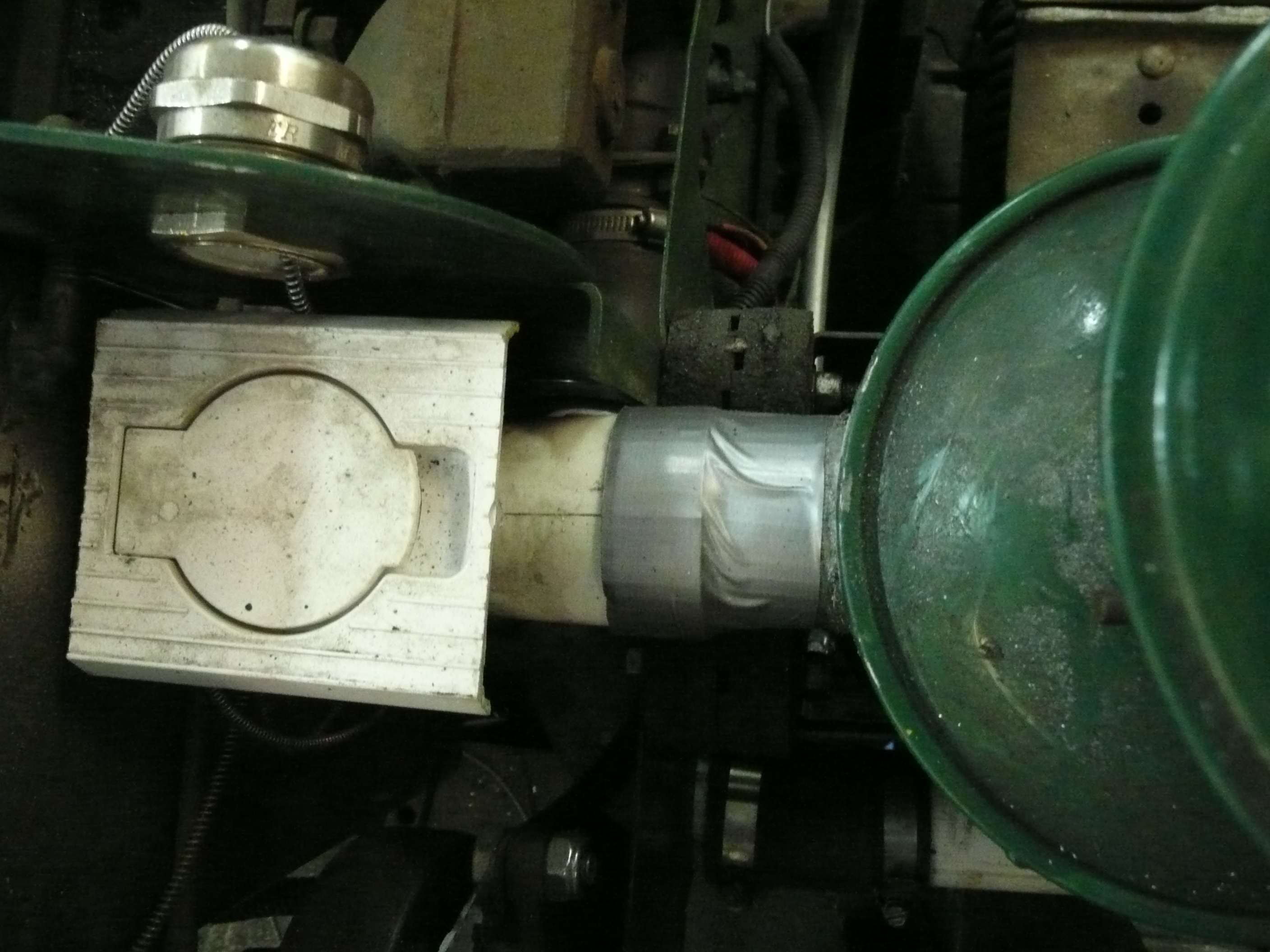

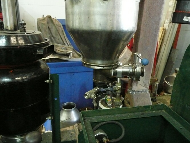

mixer protection valve (central vacuum connection)
Overview of the installation
coal spruce
valves; air inlet and exhaust inlet
Hi Trigaux looking at your charcoal it seems too big. Shrink it to nothing bigger then 3/4" no smaller then 1/8th with a good cross section of all sizes. I think you are getting too much CO2 escaping un converted hence the short run time beautiful build though
David Baillie
That’s roughly 3-19mm for those of you who live in countries with the superior measuring system. :wink:
thank you David for the remark.
I sift my finer coal for the future
