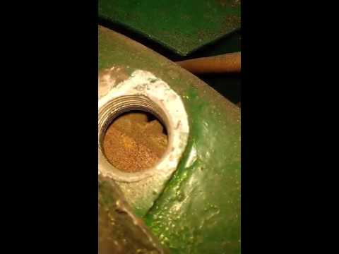

I do not see marks on the pulley or flywheel
Here is a video of the flywheel. I do not see any landmarks on the stationary part of the tractor
Thierry
Trig; My guess is that you found the Top Dead Center mark on the fly wheel. With that centered in the hole, now go to the distributor and make sure the rotor under the cap is pointing directly at the #1 spark plug post on the cap. Now you have the markings at the base of the distributor where it bolts down. That should be on “0”. Now if you want to advance the engine 5 degrees, you turn the distributor until it is at 5 degrees on that marking. Tighten it down and you are good to go. ( 5 degrees was and example. I don’t know what it should be set at.)TomC
I just remembered that that mark may be off by one revolution. If the rotor is not close to pointing to the #1 cylinder on the rotor cap you may have to turn the flywheel around one complete turn to the same mark. Sorry.
Tom thank you
I’m glad you are able to deduct all of this video
For me it is can not be as obvious
I thought I understood you. I will try this adjustment soon.
I’ll keep you informed
Thank you again for your generosity and your time
Thierry
Was it just me, or were there 2 sets of marks on the flywheel? It seemed l like it turned a lot, and found one mark, then turned comparatively little and found another mark. I’ll try to watch the video again and catch the timestamps.
:EDIT: it might not have been a mark, but it looked like there was one that moved past the hole at 0:41-0:42, just before coming back to the polished 00 mark.
Brian I haven’t watched the video but some tractor flywheels have a make at top dead center and a second mark at the fire advance location. If that is the case normal the fire mark will have an F infront of it. The service manual should cover these details.
