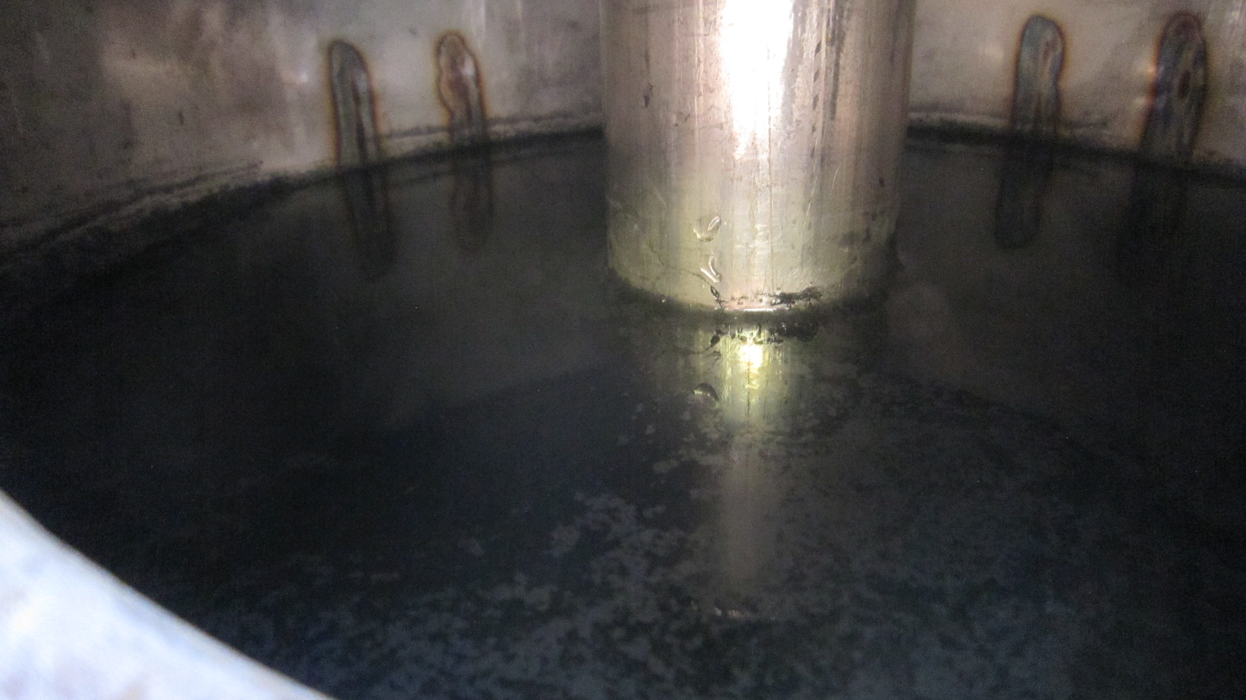

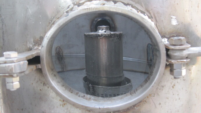

water bubbler after work…
water bubbler in construction without fine nets yet, backon top the hole of the starter bypass.

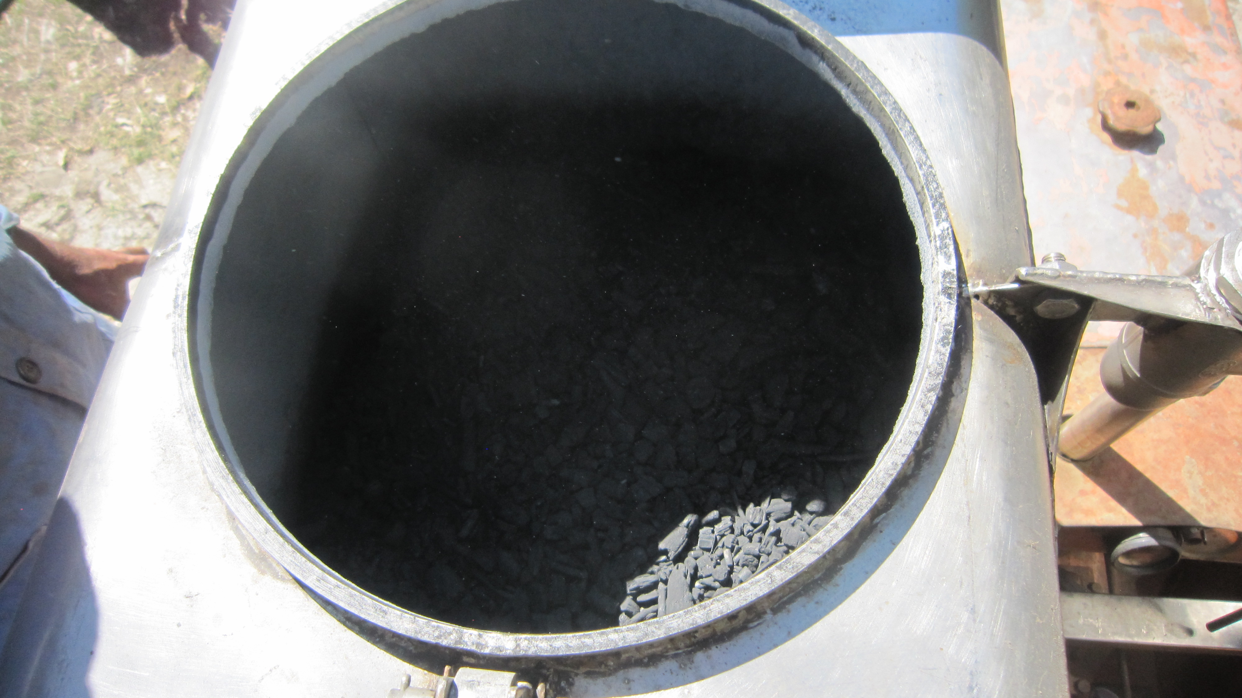

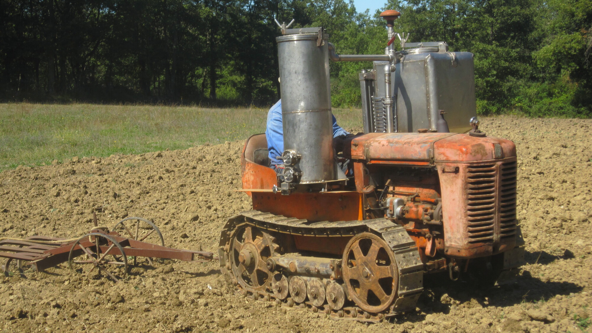

coal consumption after 2 hours of work, the hopper was really full before starting …27 cm in level consumed…

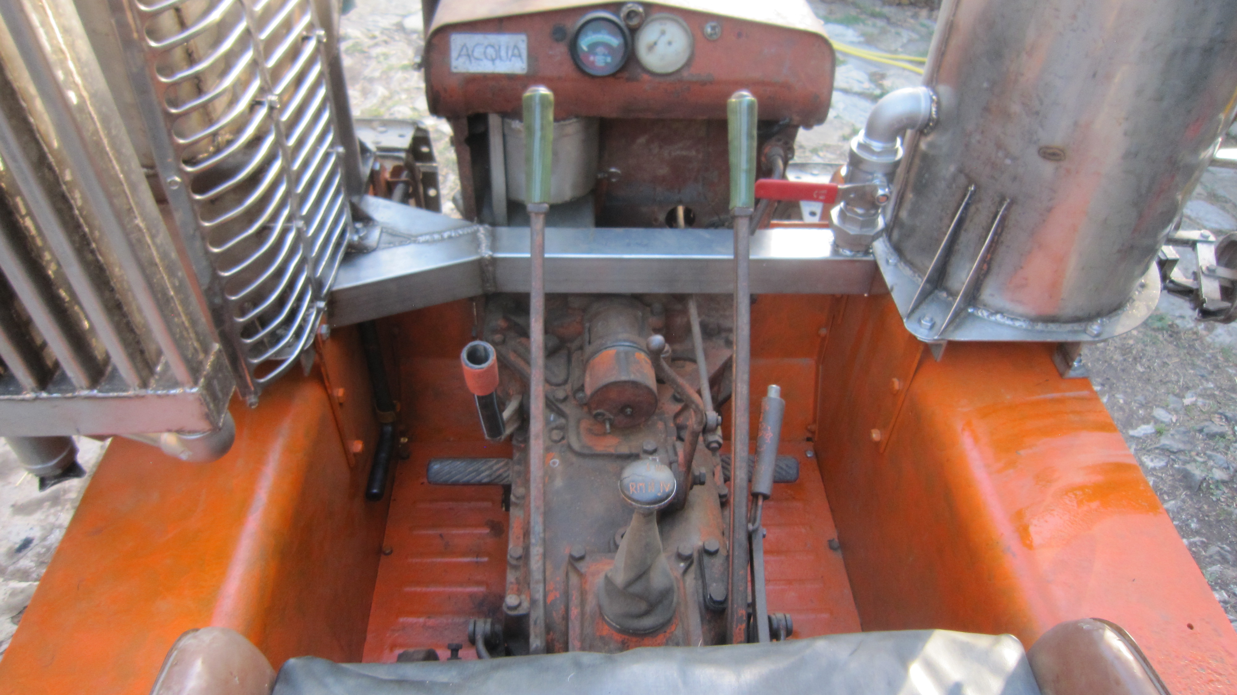

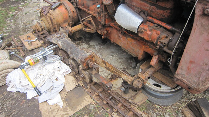

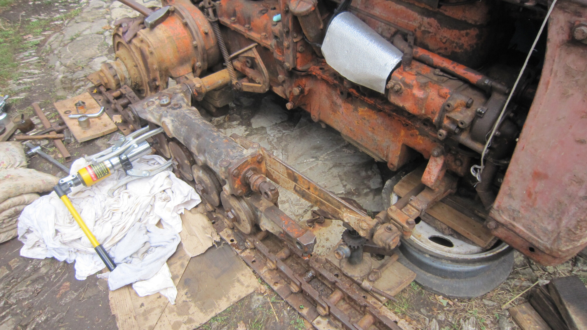

recently we finished restoring the cart of the crawler (with the help of a hydraulic extractor , a good friend brought me…) and constructed a water bubbler in the filter bottom with starter bypass…

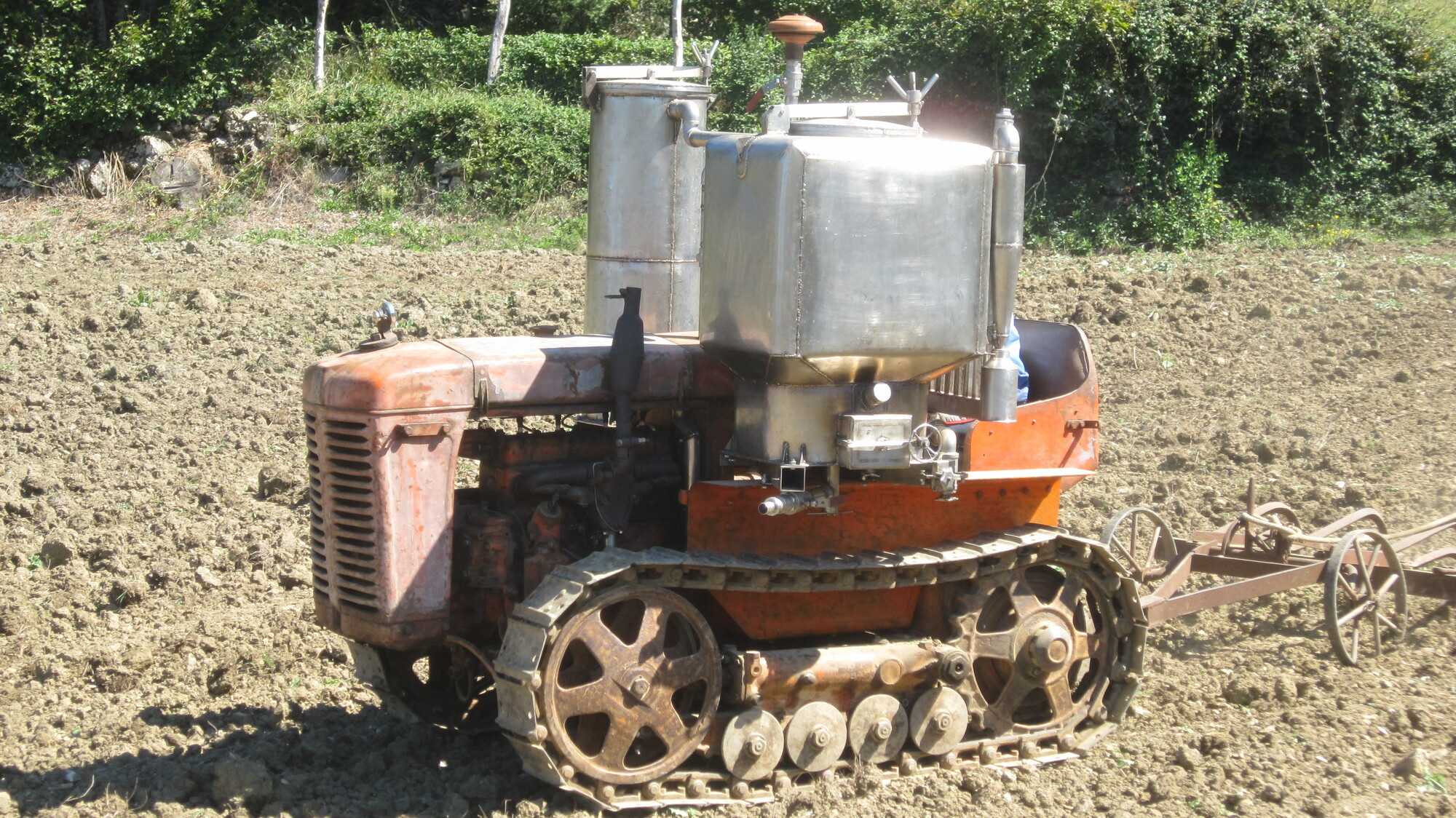

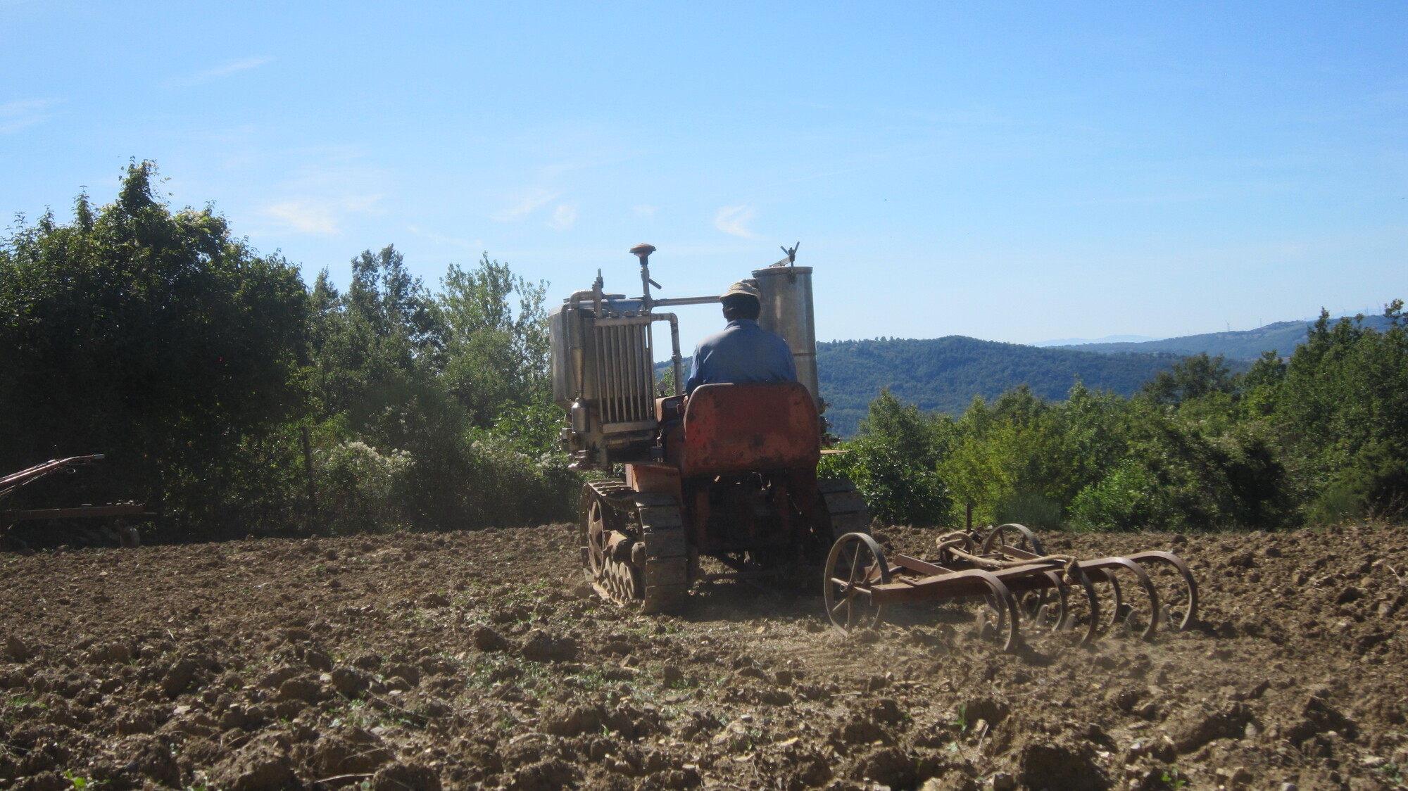

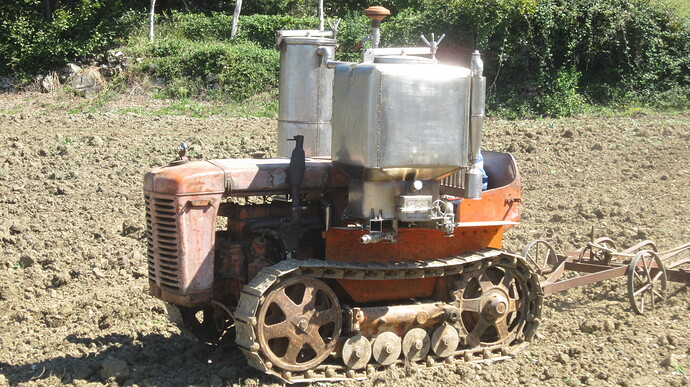

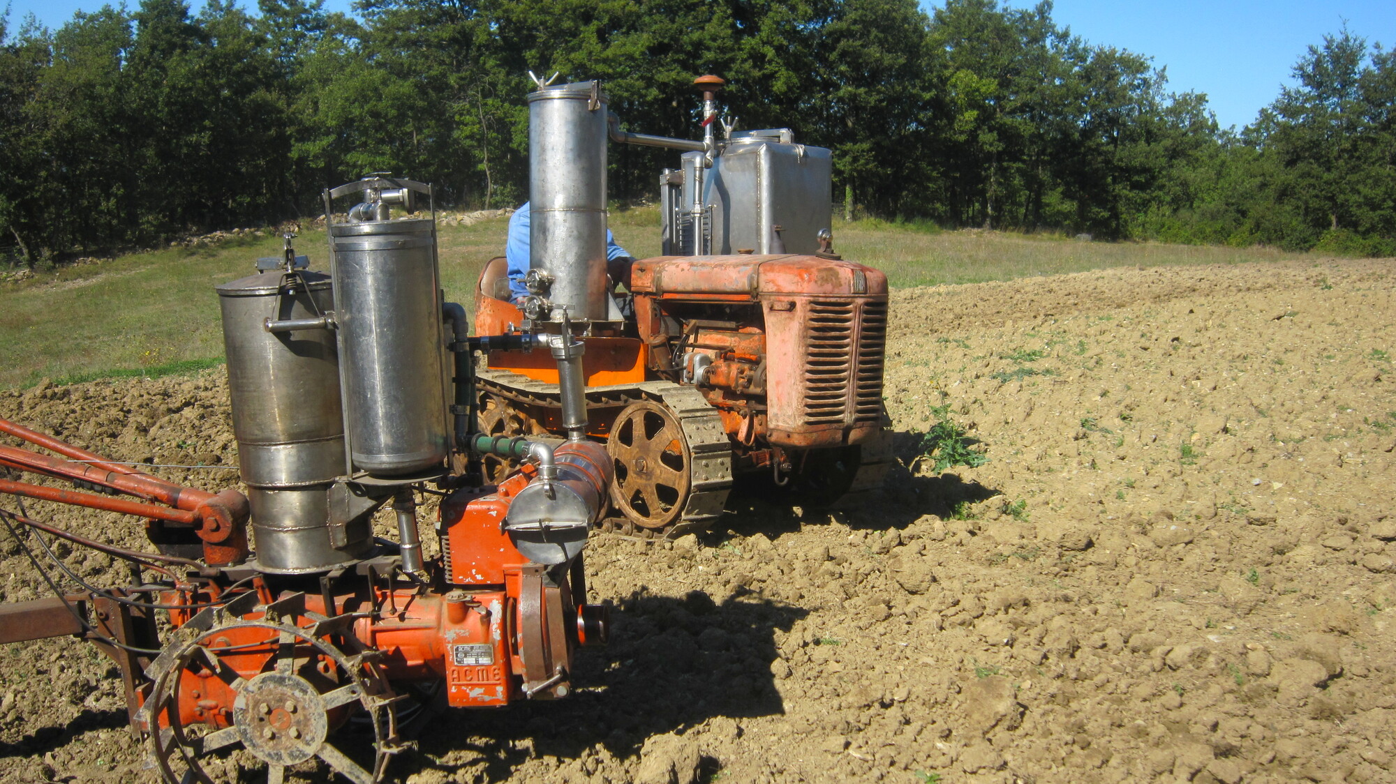

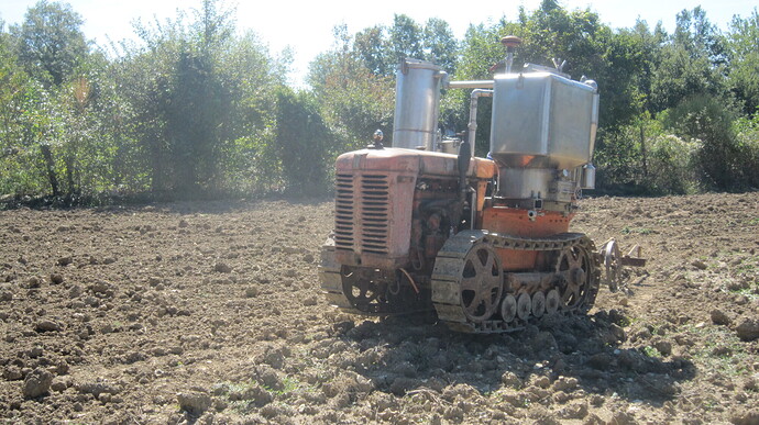

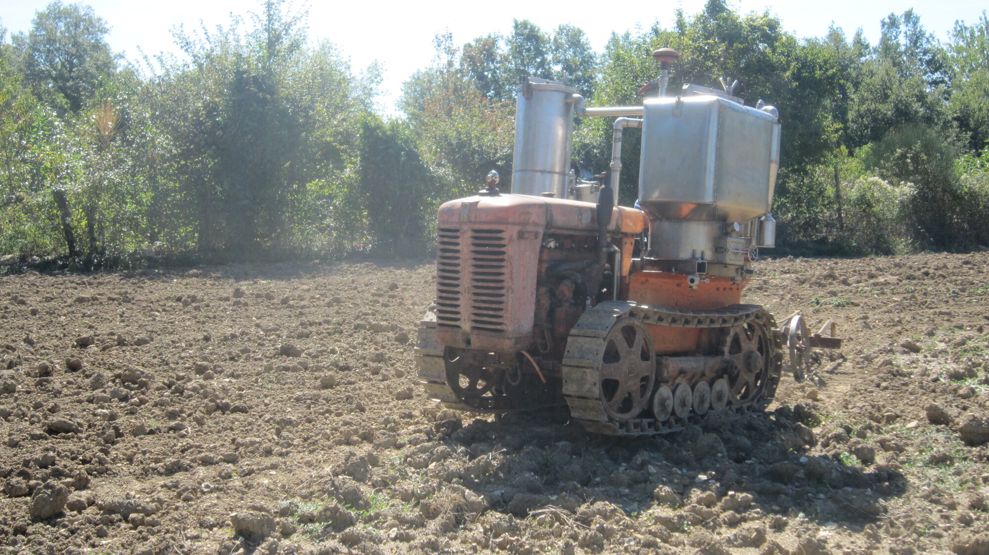

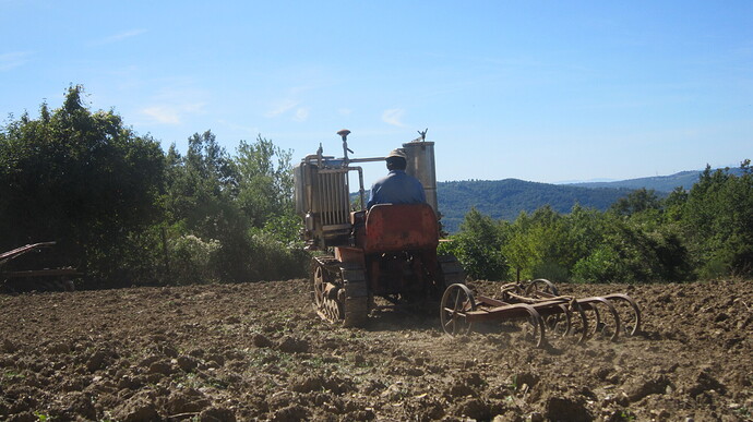

today the tractor goes to real work…after plowing and some rain a lot of weeds are grown on the field…first we tried with the motorcultivator and the horse harrow, but this morning we have had difficult with starting, probably the valves need some grinding…so we decided to try the crawler with the horse harrow, because his harrow - a heavier tool- is not ready yet…

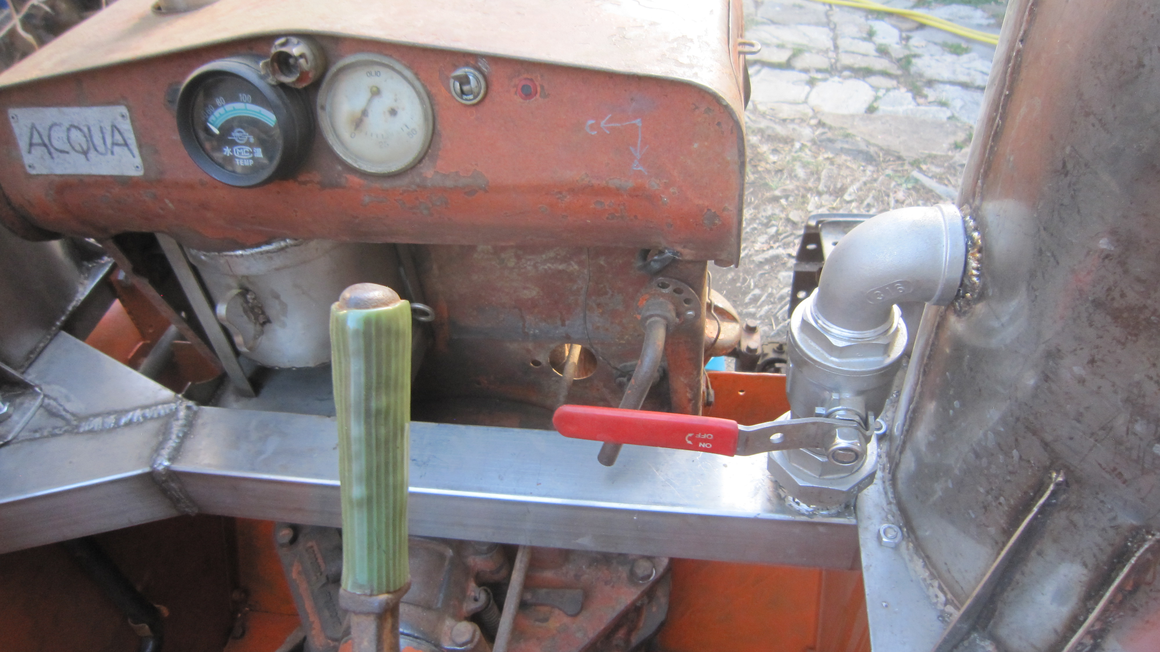

some more pictures…the bypass valve for starting…so gas must not be forced through the water, what is also impossible with a hand blower

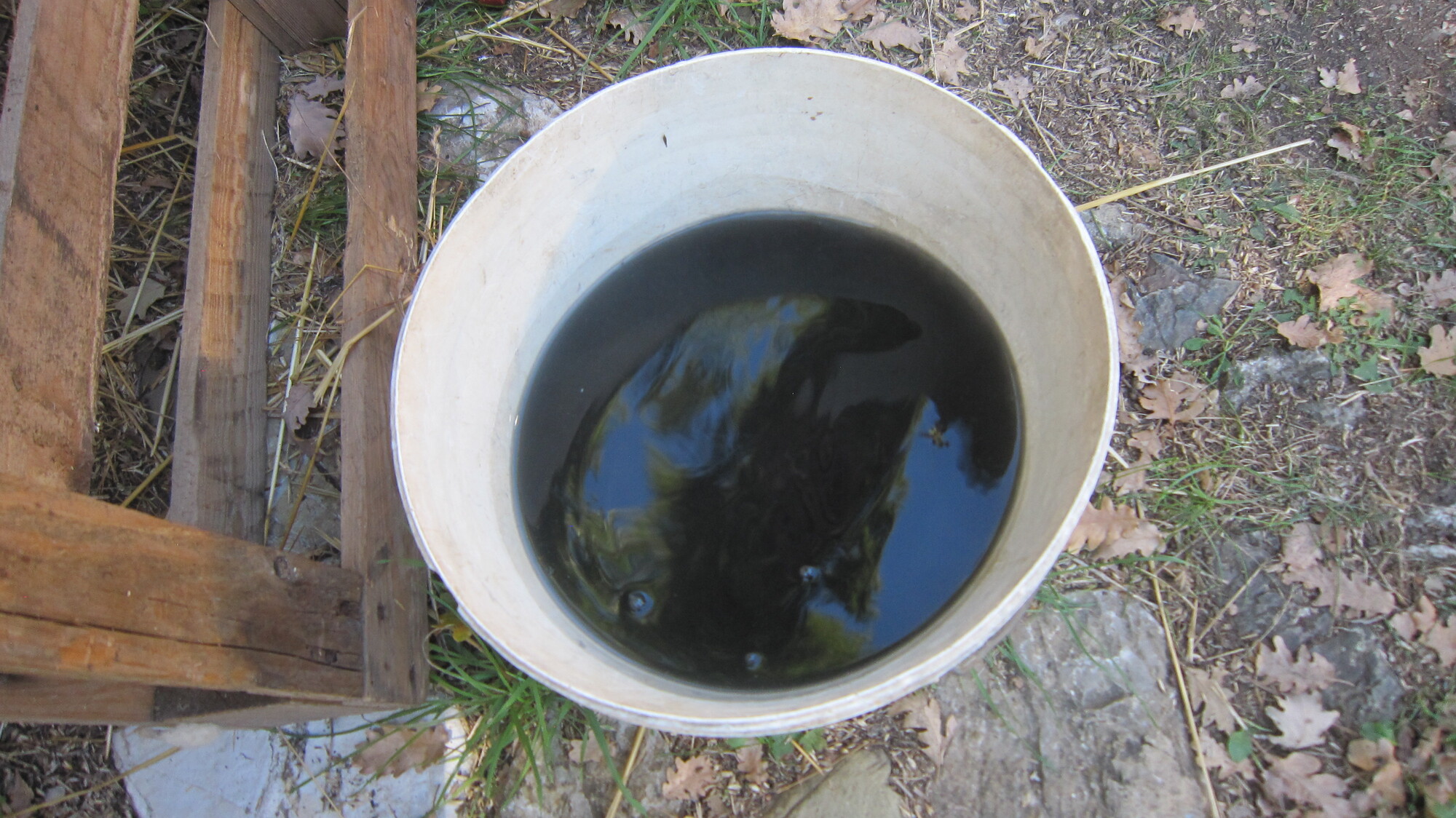

water from the gas bubbler

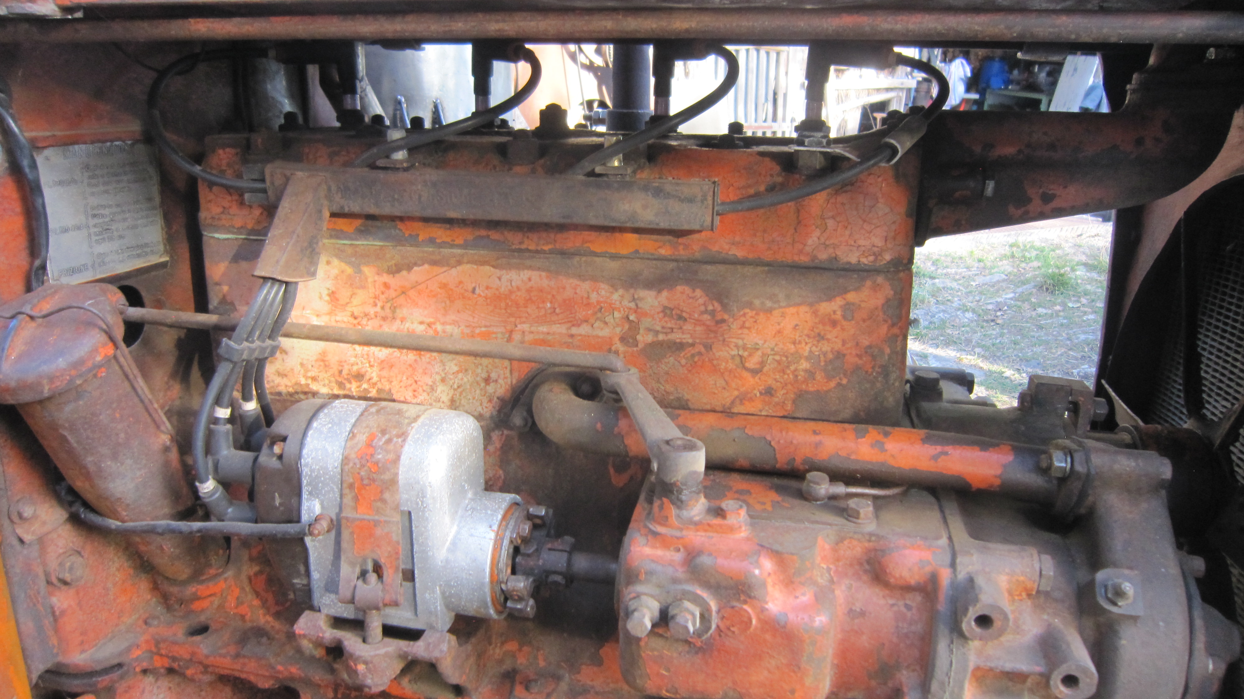

magneto and regulator box…thanks for tips to göran, tone, steve , sean and others to bring it sparkling again…
