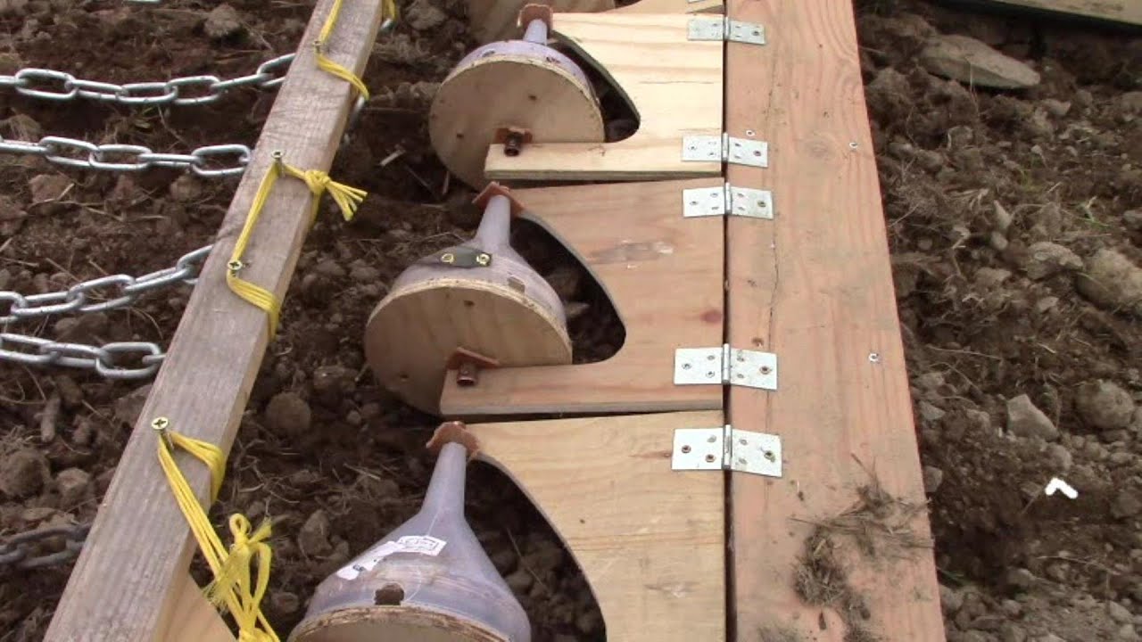

Are you looking at a seeder like this?
we typically use grain drills which is the seeder plus disks for opening and closing the furrows.
If you are trying to make like the box style, you don’t want to use metal for moving the seeds, it tends to crack and damage the seed. They use a plastic or hard rubber now. And you can probably make a mold and use recycled plastic to make wheels to fit over the shaft and use like polyethylene or polypropylene which in the US is milk jugs and milk caps both will soften allowing for reformation.

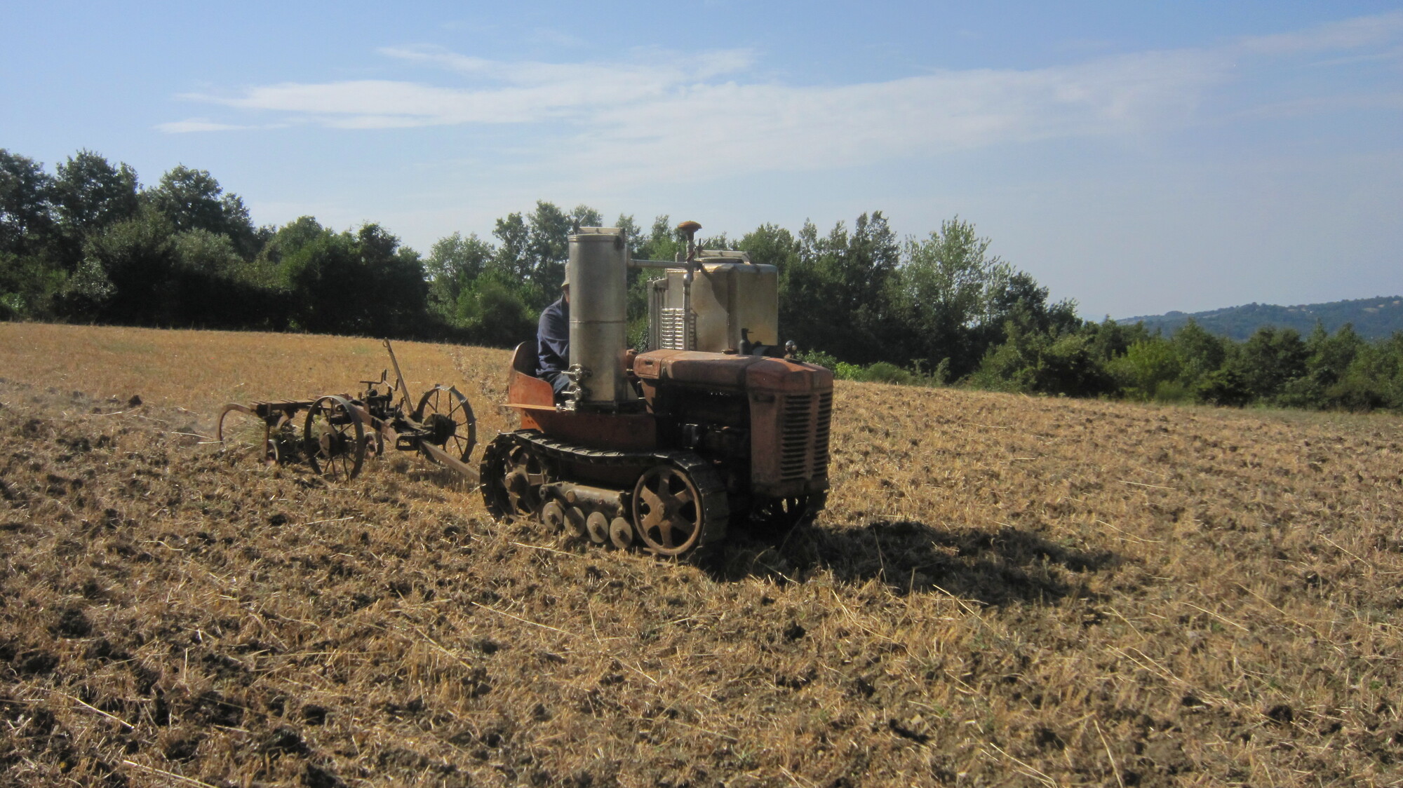

some work on the field, now is good because the weeds dry out without roundup…

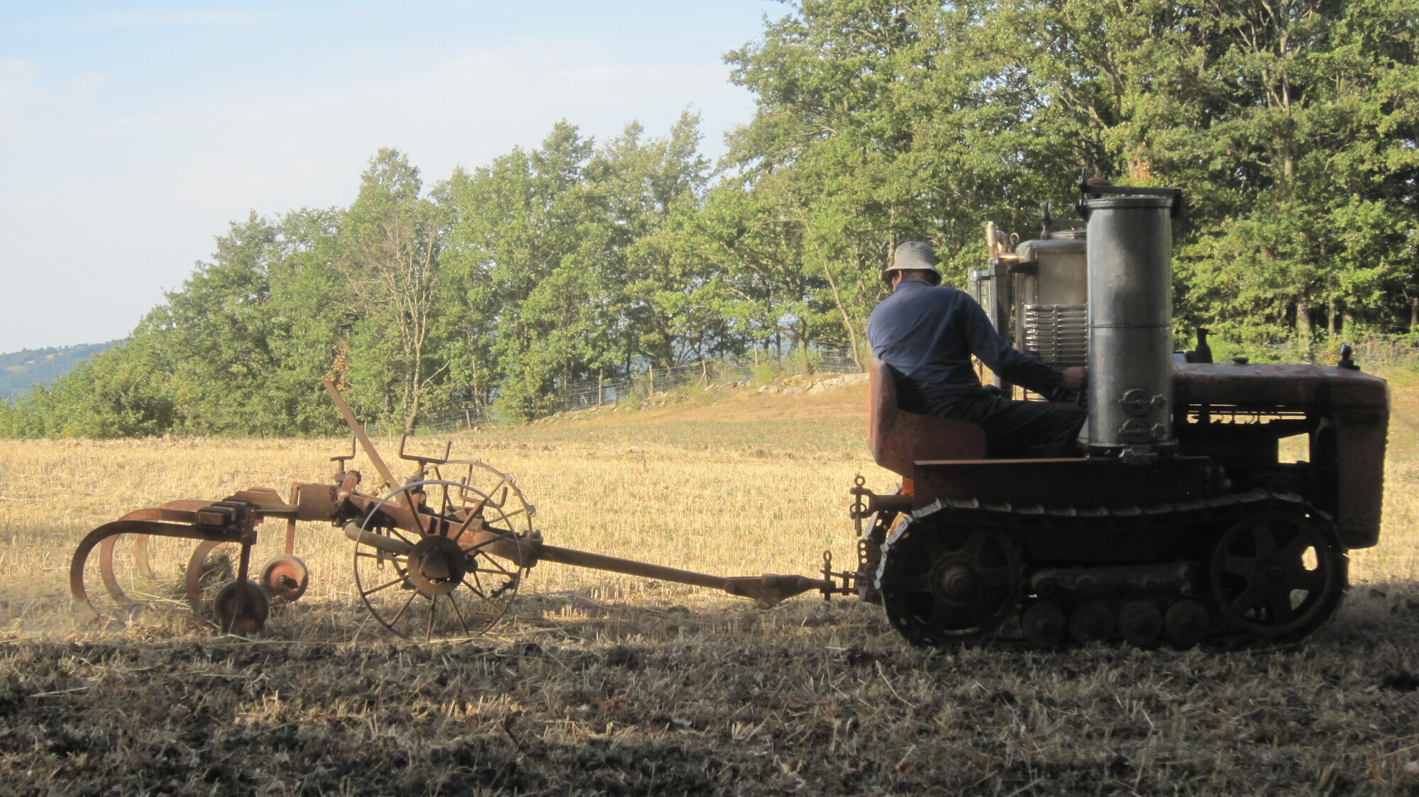

3 hours running time, and the hopper was not empty yet…work must be done in the early morning, because with raising temperatures the cooler water goes up to 90 degree celsius

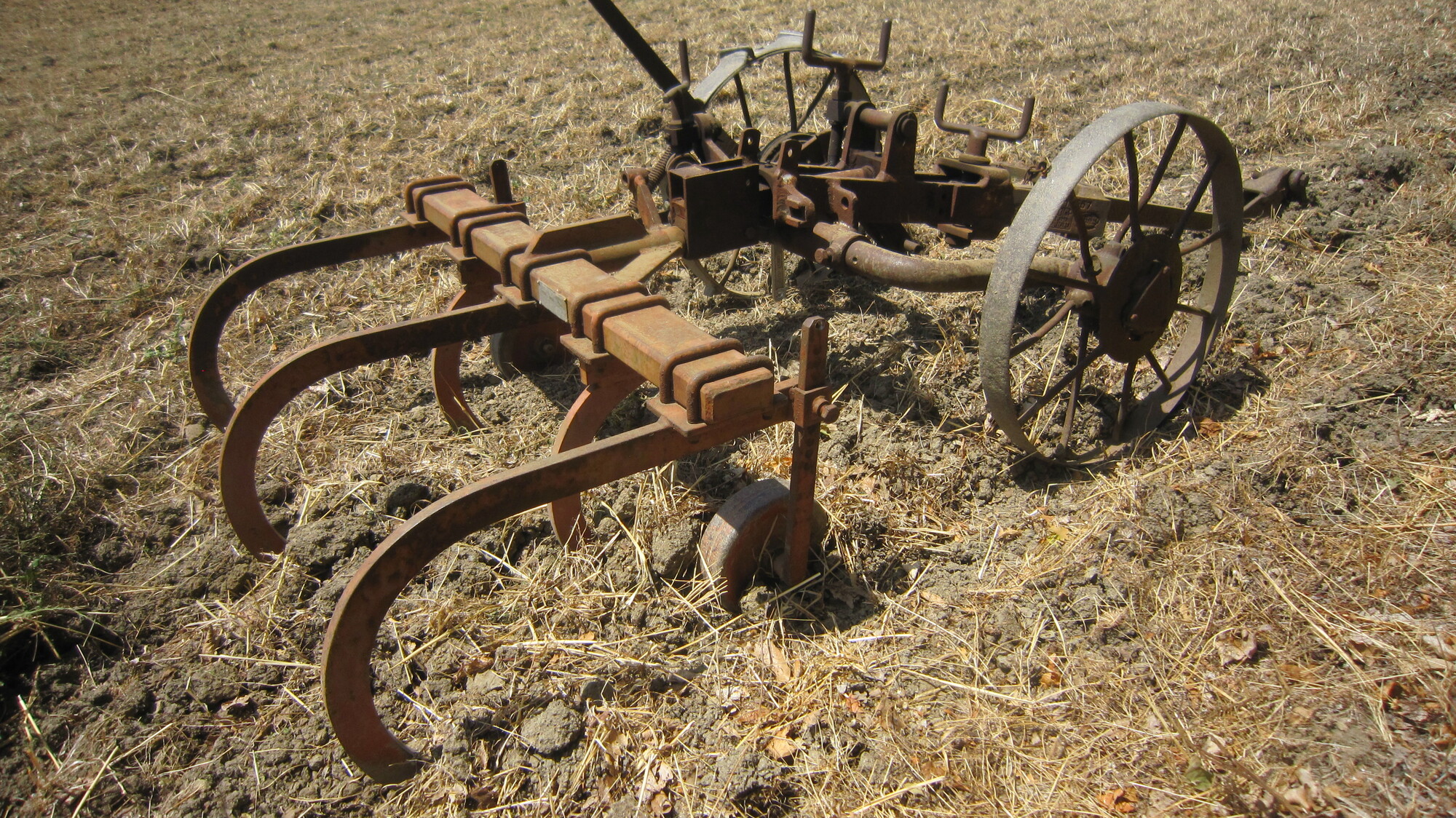

this time comes to work the old tractor harrow…

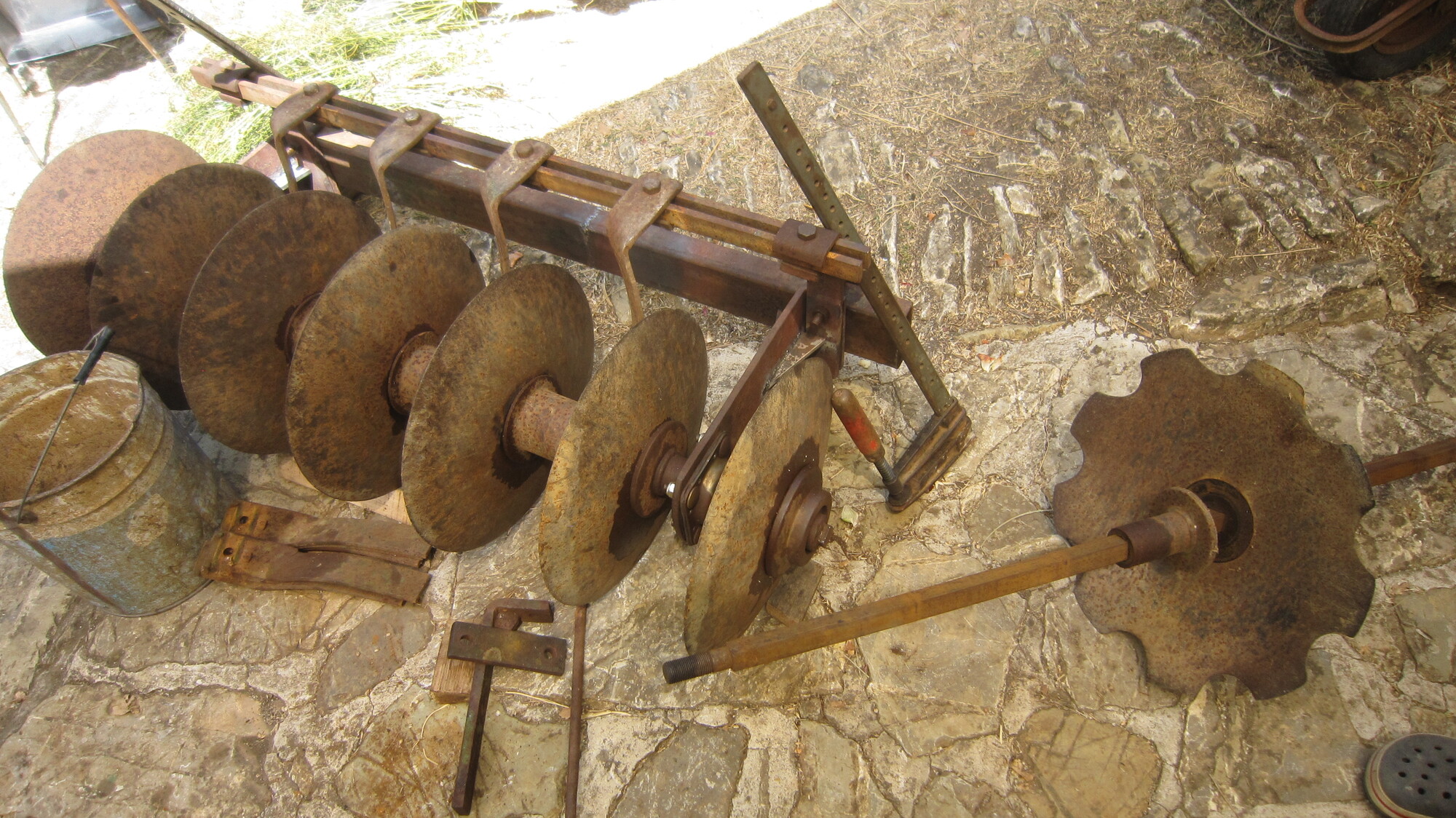

the next tool is a disc harrow, actually in restoring phase…1,30 m wide
Hello Giorgio,
Thank you for sharing your work and the photos of the harrow.
I am planning to build a harrow using scrap steel from large utility poles.
Your various harrow designs have given me plenty of ideas, thank you very much.
