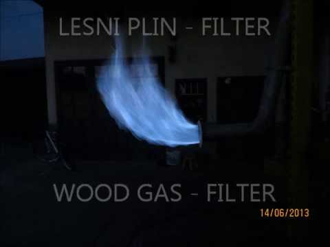

Ot occured to me, and the German guy allso mentioned it, if everything else fails you culd build a electrostatic filter. They are not that complex and are amazingly efficiant at extracting both tar and water from the gas. Only downsides is they are rather big (no problem for you as you have enough space) and they require some power to operate.
This is the system my friend used. You can see how effective the filter is, the feedstock gas was full of tar and when he starts the transformers every trace of tar is gone.
Yep thats the same guy, Marko.
