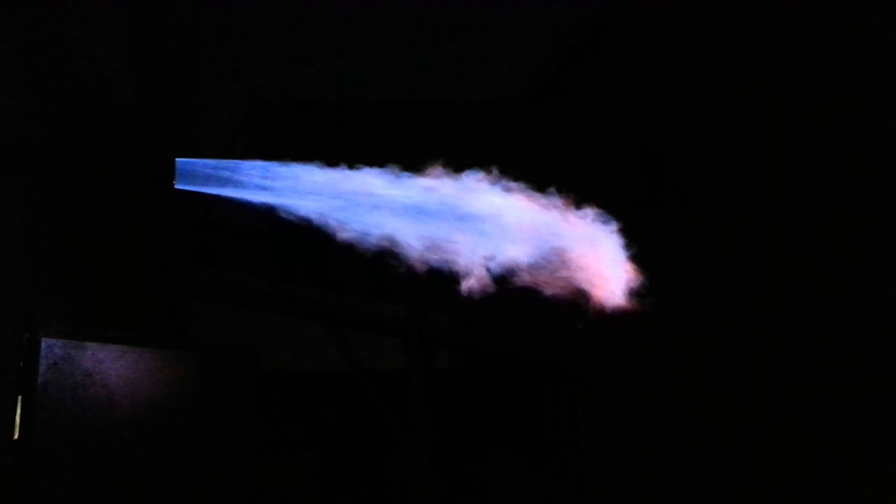

la flamme de l’usine ci dessus, de 3 ml de long sans maintient de flamme des heures sans interruption 1.3 KW/Nm3 en moyen, je t’es demandé le litrage des cylindres de ton moteur, car j 'ai un doute sur les m3 de syngas que tu utilise à l’heure.

I may not be the one to comment on this. I watch the two fellow develop the Drizzler and when they went to the open top, I bailed out. I will say what everyone else is saying-- dry fuel, dry fuel, dry fuel. In the video where you said you could not keep it flaring, when the blue flame went out you could see a cone shape cloud. To me that is moisture. When your woodgas production slows down then it can’t overcome the moisture that is in the gas and the flame goes out. My guess on what is happening is— you start out with ? percent moisture. The closer you get to the center of a piece of wood the higher percent you get of moisture. ( when wood dries, unless forced, it dries starting on the out side and goes to the center, the center holding moisture the longest.) So if you start the pyrolysis process, the material gives up the correct amount of gases to give you a flare. Then as you get to the center of the chip pieces, you get into the higher moisture and that higher percent of moisture over rides your gas.
