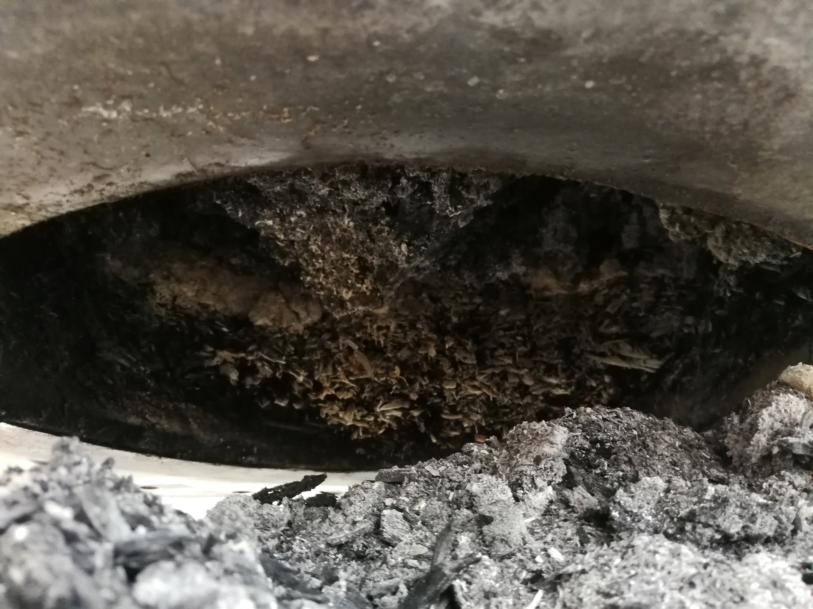

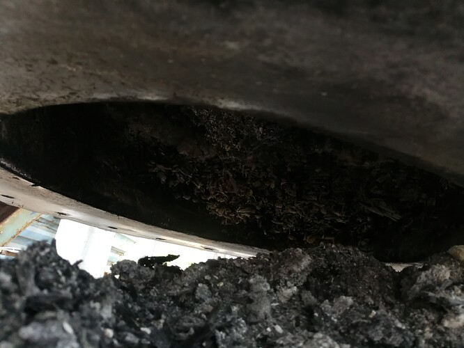

Just cleaned the gassifer before firing. see what i found. This is the reason for chokingâŠ
Is this slag?
I noticed you have a auguer on the bottom of the gasifier. Is it operational? I ask becouse if it is it culd be made to run occasionaly to move some char/ash out preventing your problems.
I just installed an augur we have to see in next gassifer firing

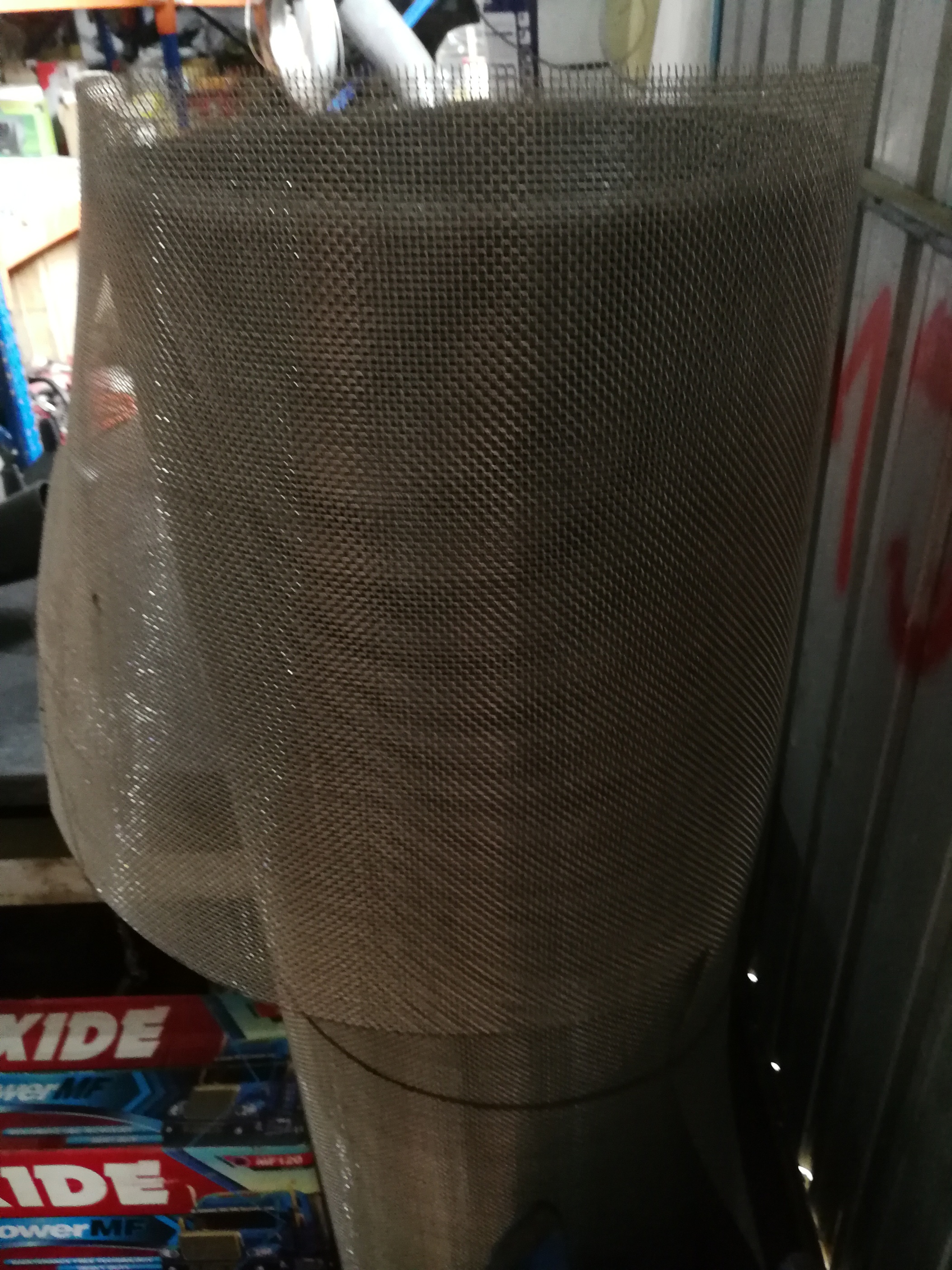

Guys i am installing stainless 304 mesh. The size is having a hole size of 0.5mm
If you are putting that at the bottom, you will most likely need some way to shake it to get material to flow through it.
No i am not putting this to the bottom. I am still keep it as a drizzler gassifer but this mesh will sit on the gas extraction outlet.

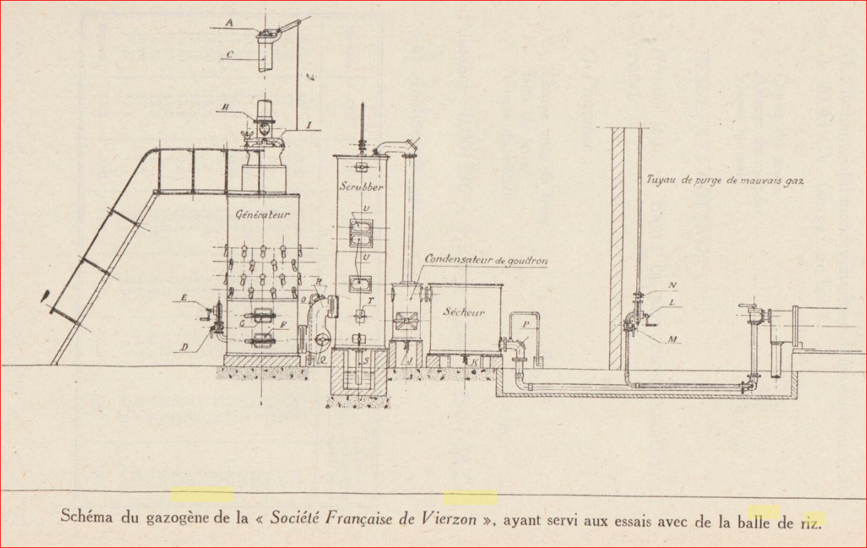

Faazi,in view of the image of your gasifier, so that you are a background that resists air variation, I think that a casting of alumina in its make is necessary.
In 1926, he used 50% wood and 50% rice husk less than 10% moisture, and the inside of the gasifier is refractory concrete, despite this device, he had only 1000 calories/Nm3 of syngas, so it takes well put all his chances on his side.
