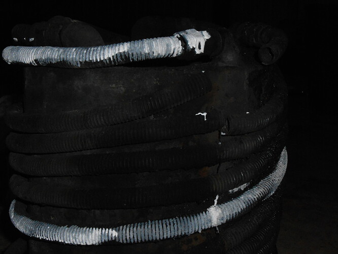

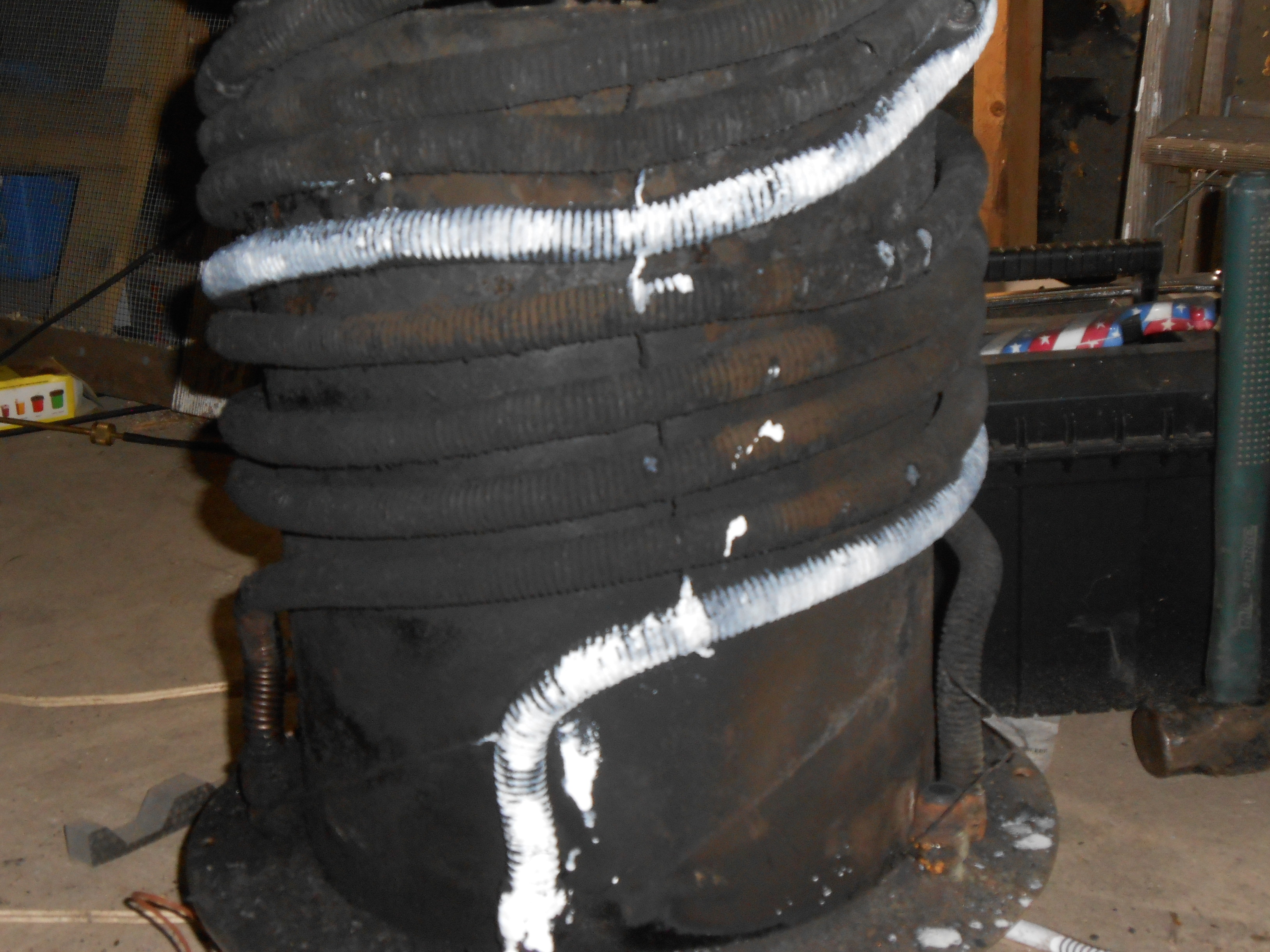

Took apart gasifier multiple burn thru of preheat tubes . I had been running for year with air from lighter tube .

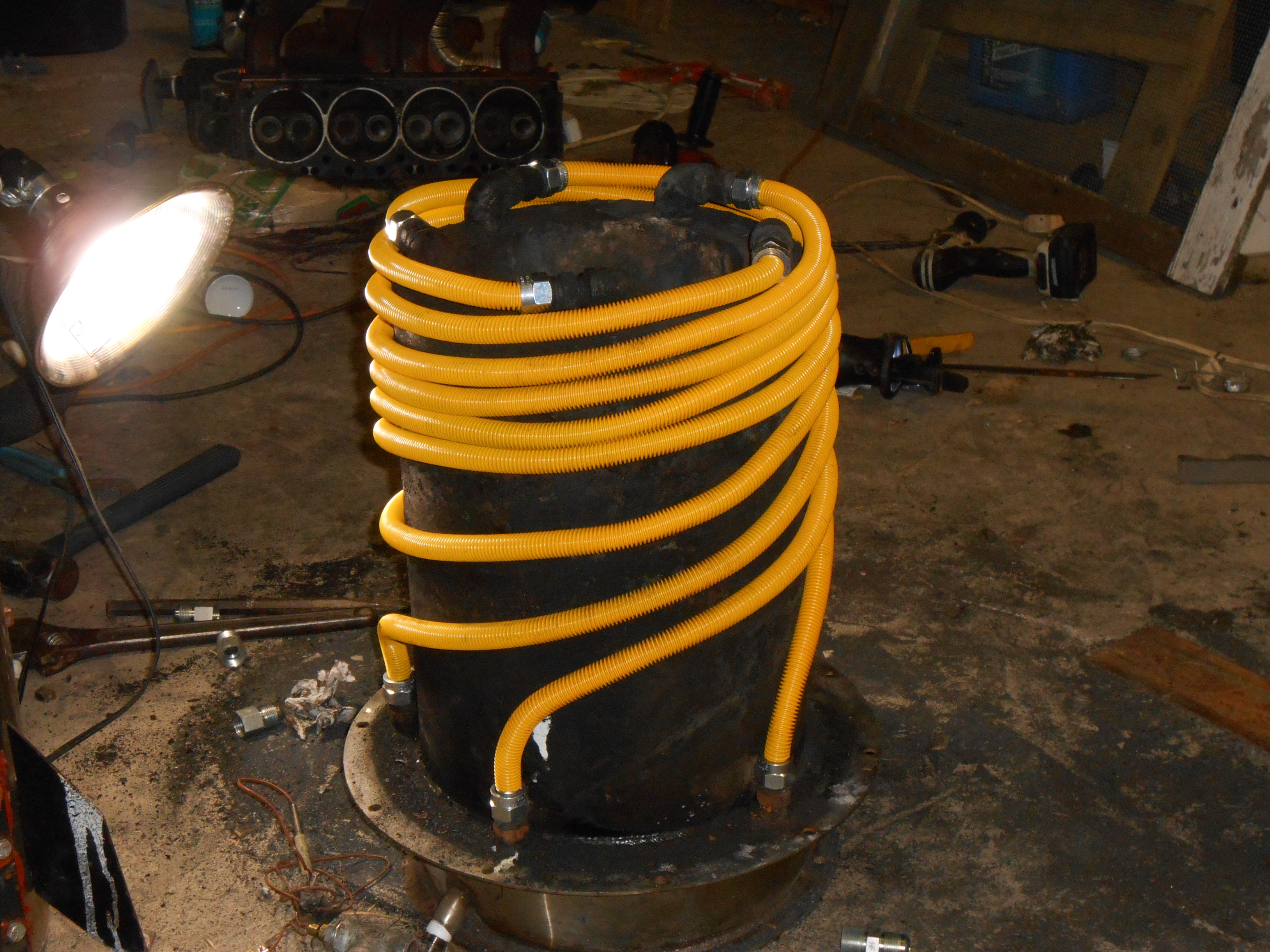

air line spec 72 inch 3/4 stainless steel x 5 . This is rust shale crumbles when touched .
wraps 1 1/2 times around . wood gas passes coil to cyclone . caused blockage of gas flow .

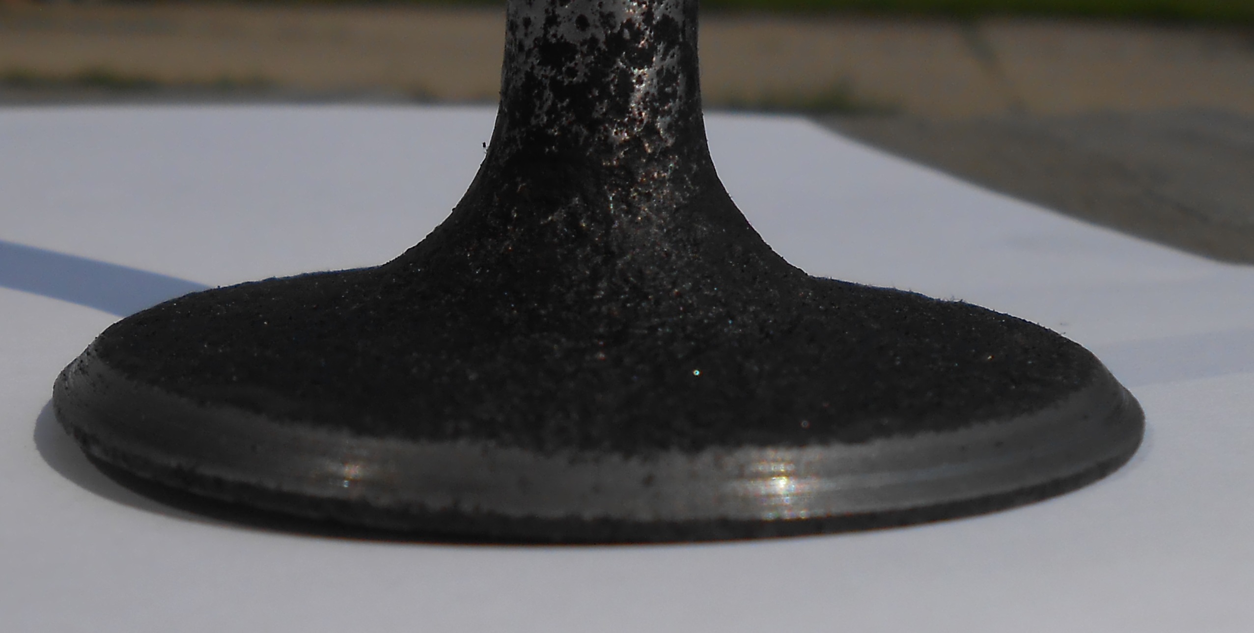

lapping valves , seeing a lot of pitting on valve , which is rust not tar . This occurs on intake valve , on cleaning exhaust valve there is a spiral pattern on stem near flute that must be original machining . .
can not remove rust pitting from small area of valve face , rust goes through whole intake valve .
That sounds like a manufacturing defect.
I do not think you can see the exact spot , It is a rusty valve . have I lapped the valve more then I should ?
!/8 inch .
Pretty much ALL metal was cast (poured into a mold) at some point. To me that looks like a batch that didn’t get flux, so it is shot through with oxide inclusions. Flux would have caused those inclusions to coagulate and float to the surface as slag (sometimes called dross).

Have new head gasket . Waiting on parts to rebuild gasifier to stock configuration . 72 inch flex gas lines 5 of them . breach burn through in gas line caused wood gas to burn inside gasifier causing more damage to gasifier . On first use , perhaps unit was shipped with this flaw ? Some 300 of these units were sold . I was not supposed to get one of them . I paid for a newer version , but I was shipped a total piece of crap sealed in tar . $34,146.00 ALL POWER LABS INC , 2013.

replaced air lines with what I could buy after getting wrong item from other vendors . will need to cover threaded ends with fire clay , retort cement . Does heating incoming air actually reduce tar ?
