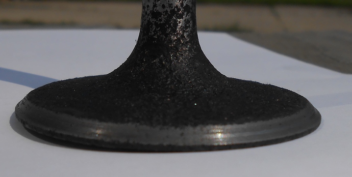

I don’t know your engine or it’s history. Did you replace the valve in the picture? This guy has a lot of good tricks for engine repairs. https://www.youtube.com/watch?v=SK2R2LdkLKs

valve is in cylinder 3 . bought oil pressure gauge .valve
cylinder walls looked clean did not fill with oil to see if rings held oil . replaced head gasket . still trying to rebuild ,

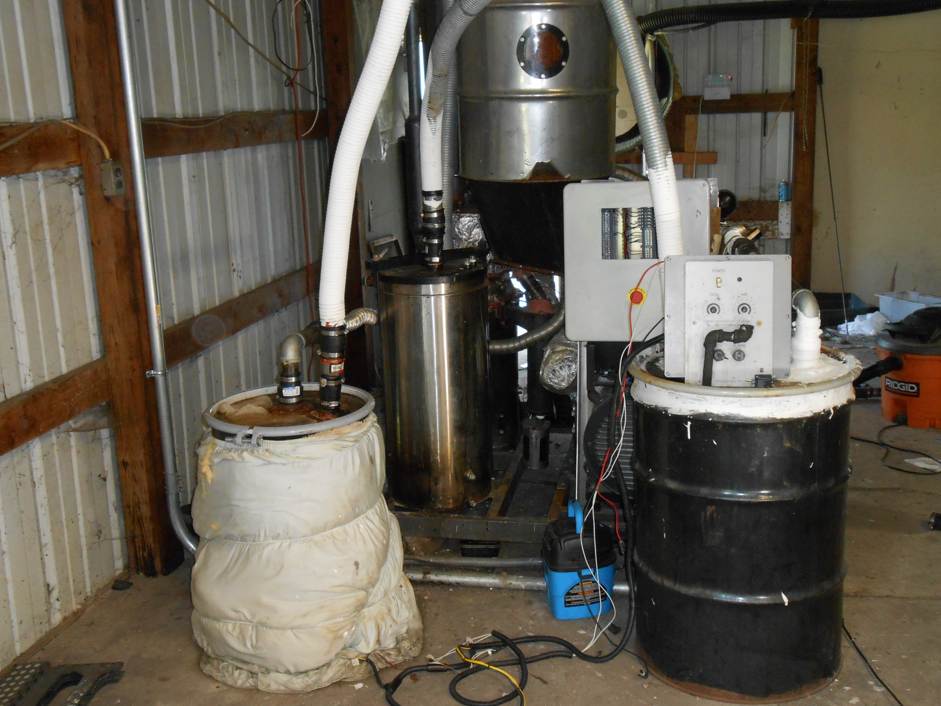

will have flare after engine , If I get flare I can shut off flare and start engine , 55 gal hay filter , looking for foam sock filter to put in 55 gallon drum . I was going to be cutting Alfalfa now to fill drum . bought fittings for big loop of pipe to cool wood gas.

I’d pass on the alfalfa. Too many small leaves that may end up further down the system, and the stalks are quite coarse. Use wild grass instead.

I’m amazed that valve is holding pressure somehow. I would not have reused it.
I’m with Garry Tait about the alfalfa. I would use some long stem grass. Alfalfa is really good for cows, but …
It has been two weeks , ran engine with two cylinders 127 amps at 48 volts oil pressure under 50 . Permanently removed carburetor replaced with 1 1/2 inch ball valve . put dried flowers in hay filter , have foam filter in hay filter . sealing filter drum with paint . Done a lot of leak sealing to gasifier . Almost put together . Need to make fuel .

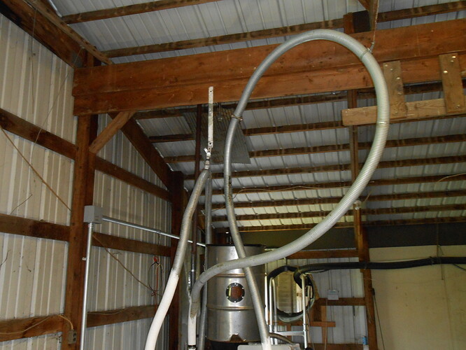

I believe that preheat helps reduce the chance of tar. You don’t want to introduce
cool air into the heart of the system, although it works, it has to take heat away from
the core to heat that air. That takes heat away from the gasification “process” and
could lower the temp at the nozzles thusly impacting the core temp. Maybe not a lot, but hey
conservation of energy is critical in this process for max clean gas production. I went through a
whole rigga ma role just to do essentially what you’ve done. It’s a GOOD move despite the
PITA.
Do you have to? No, but this is heat (energy) that is not available to the
gasification process itself.
It’s a good move. The only problem I see is the meltability of your tubing. I used copper for mine.
Any holes melted in your tubing will detrimentally affect the core temp and thusly your
total good gas output, imho. Then a tear down and put in metal pipe anyway. Watta PITA that’ll be!
Go to the Small Engine section and check out “My first small engine run” on page 456 for a
pic of my setup.
I have to say it is well worth the effort!
Pepe
that was my June 2 post . I painted this with high temp paint sealed threaded ends with muffler paste . Original tubes failed at threaded end because they were not sealed and burned trough and leaked air and all gas burned inside gasifier .
I plugged air pre heat and used lighting tube for air without pre heat producing a whole lot of tar . It produced gas that could run engine . I have now replaced original air pre heat . have not run gasifier since .
