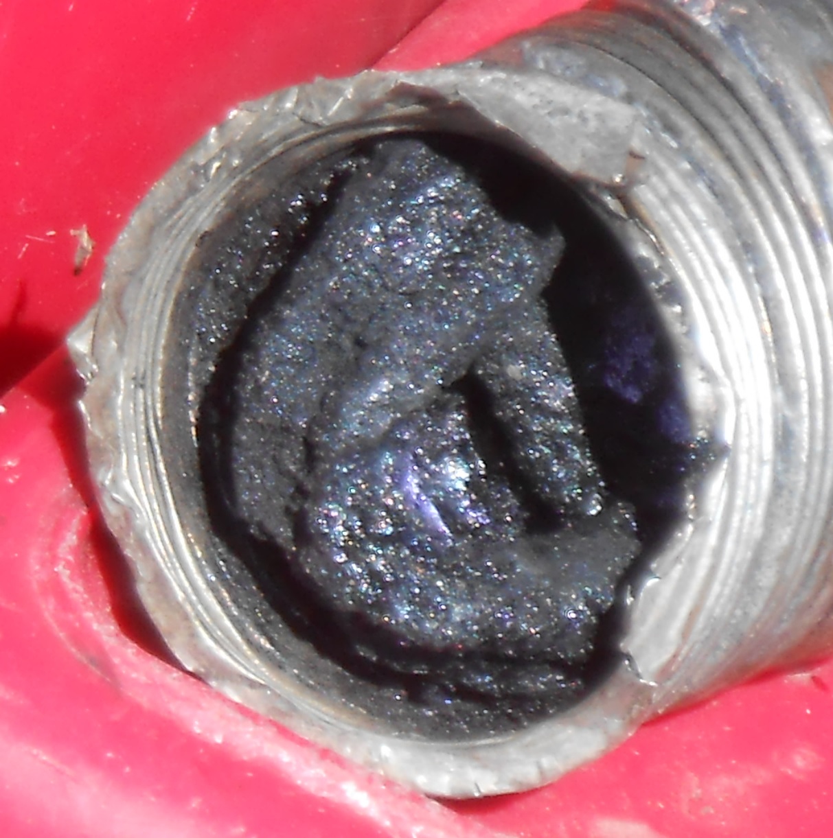

Pipe from cyclone . donut ball of tar . opened gasifier chipped out fuel from gasifier . used 1/4 inch screen , put fuel held by screen back in gasifier . used both propane and map gas torch to light gasifier . had successful run , low power 48 amps at 48 volts . I think I must have developed leak on engine side of intake manifold . air mix pulsing air , very low vacuum .

Have one just did not install it . Like you I had to use over head hoist to dismantle , reassembly gasifier . When I bypassed hopper heater I found a tube blocked with a donut of tar so it could be the hopper was not sealed but was path of most resistance , when the normal path got blocked gas flow went thru hopper bypassing cyclone . I have put extension on auger , tried brazing . side of cast to steel took . side of cast to stainless steel did not , should try nickle silver brazing rod . Just trying to put it together again .
