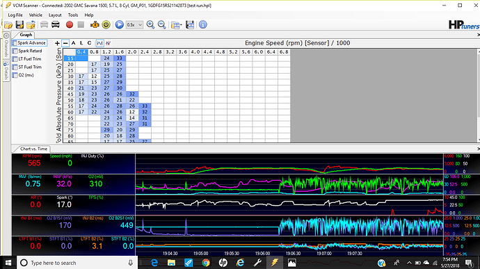

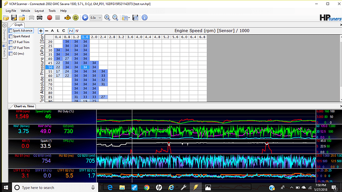

its been a couple but work got very busy just went through inspection all good to go had some time to do some road testing on petro only .

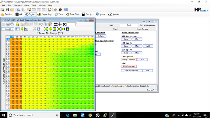

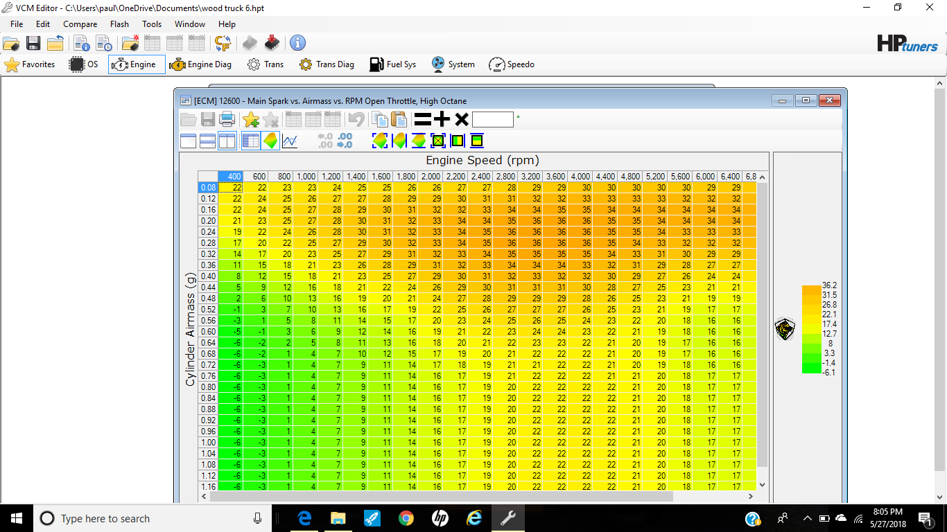

the first table it the main spark the second is where I’m getting my advance from I have a switch on the air temp sensor when on gas it follows the factory timing .
when I flick the switch the temp goes to -38 and the first 3 rows I have set it to add 20 degrees here is a couple of screen shots of this.

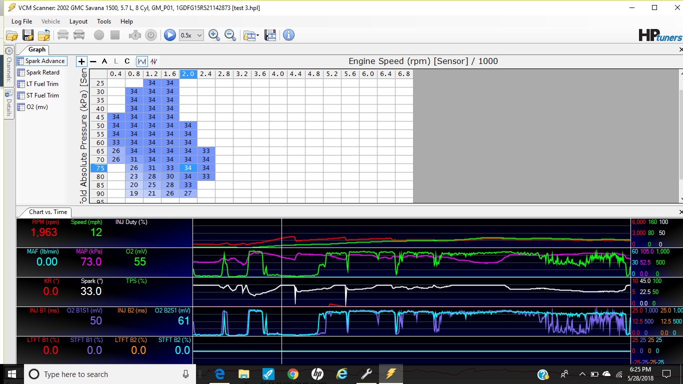

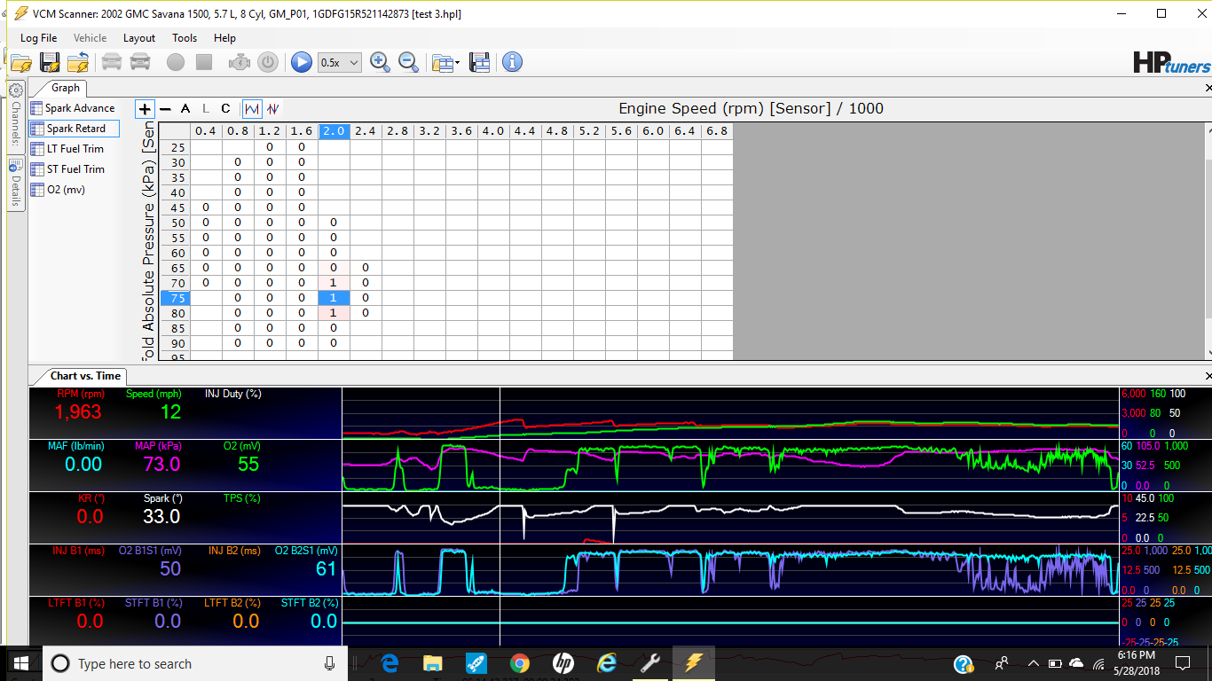

I got a few runs on wood today and had some spark retard showing so I guess I have room to lower timing here is a screen shot around 1900 rpm just before first to second and the same with second to third that shift you can see some knock being picked up.
