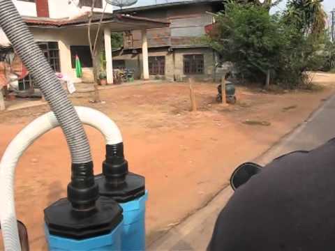

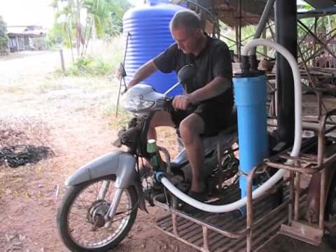

After a lot off kicks, the engine runs and gave me a great feeling driving without dyno-fuel…
monday i will post the video’s, here is a still picture, ready for take of
The engine was very weak, ( clock stopped counting at 97800 Kms ) with a lot of engine trouble, still managed to drive it with the gasifier
Engine Honda 110 cc with half automatic 4 gear

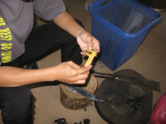

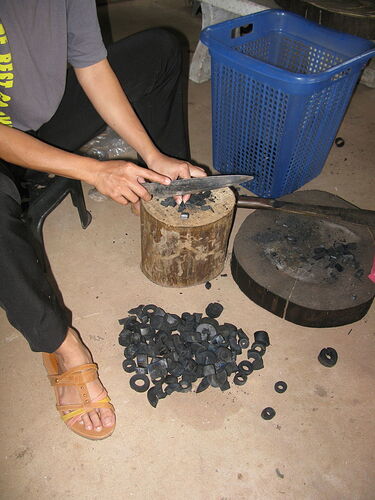

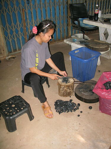

Preparing the fuel for the test drive
Bamboo charcoal, cut in small pieces and meticulous checked with a caliper

No one there would even think there was anything unusual with that bike, except a Farang (westerner) riding it.
Do you think you can carry enough fuel to do a visa run?
