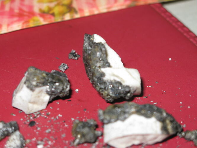

During start up with the bamboo charcoal on the bike, i did find the nozzle tip was covered with molten charcoal from the excessive vacuum pulled by the vacuum suction blower.
Changed the tip and reduced the airspeed during startup. another lesson learned.
