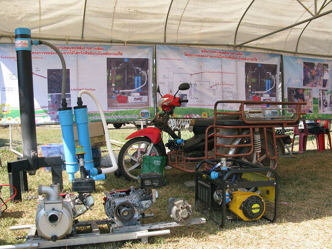

Back home from the exhibition… for those who cannot wait … https://www.facebook.com/renewableenergythailand
a lot of pictures, a lot of comments..
response was great, i did meet the Governor, the are preparing a budget for the kick off of the project, i will know more about that tonight…
i keep on improving, will post some new stuf next days, might be interesting for some, or already old stuff for others :wink:
i did run 4 engines, 4 strokes, with 100cc motorbike, 160cc waterpump, 200cc car generator and 220cc electric generator.
all went well.

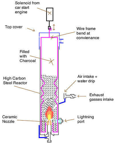

working on a vertical feedstock-grate shaker, based on a solenoid from a car start engine and on a modular nozzle system which reacts on the vacuum in the reactor.

the test bike evening before show…

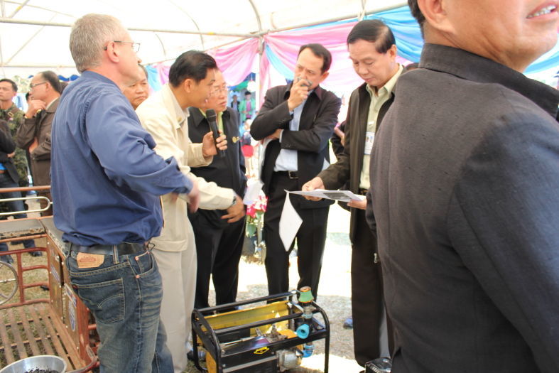

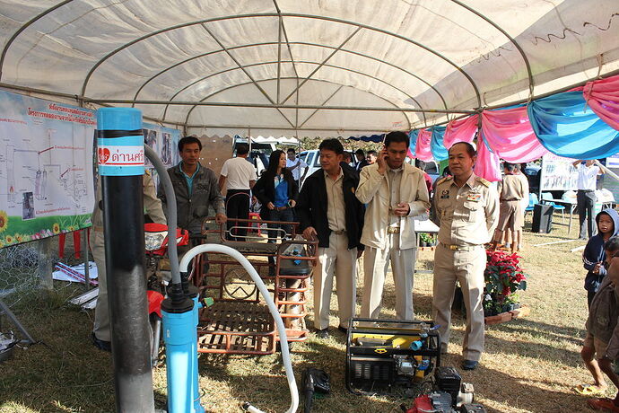

the governor and his staff
the general ( deputy of the governor) giving his felicitations for the initiative

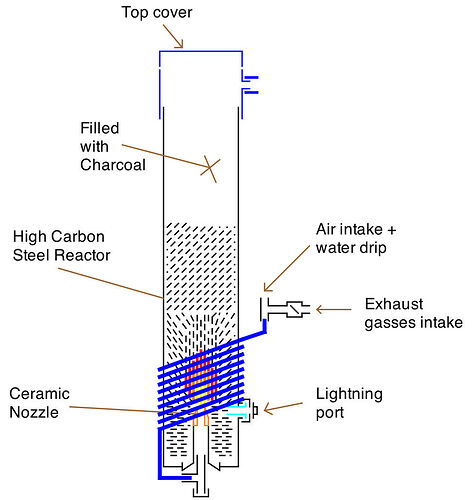

Drawings of the latest modification i am implementing..
The blue lines at the bottom of the reactor is the stainless coil surrounding the reactor wall.
Have not find the fitting plumbing yet to connect the easy way…
This is my idea to start with a “feedstock agitator”
Basically a set of vertical steel rods, bended at strategic places and form, which are vertically moved by either a magnetic coil or a small eccentric moving device
This is a idea i want to implement..

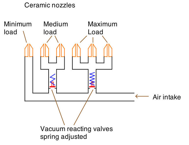

i did notice the effect of different engines on 1 nozzle size only,
i want to work on this set up to do more testing.
also thinking of modulating the mixture valve, adjusted by the intake manifold vacuum.
Hi Koen, Congradulations on moving up the ladder in the renewable energy competition. It is really great that you can show them something other than solar panels and wind turbines! You have really immersed yourself in charcoal gasification and are working to make it practical which I admire. Your design of a water drip prompts me to make a few comments. I tried this early on and abandoned it soon after as I found water condensing out of the charcoal gas. For example, I fired up my charcoal generator the other day using charcoal that was processed this past fall. It was stored in large paper bags in the loft of my shop. After running the gasifier for over an hour, I found water in my cyclone dust collector and in the final filter. This moisture had to come from the charcoal that never got wet, but must have adsorbed it from the air. In otherwords, adding more water such as a water drip would have just added more liquid water in the cyclone and filter.
In another example, I was running the Simple-Fire on a cool, humid day in February (winter in this part of the hemisphere). There was a lot of water condensing out that came from the moisture in the air. This moisture in the air goes into the air inlet and is reduced to H2 in the gasifier. This H2 is then burned in the engine which adds power. The engine pulls in moisture from the air along with O2 and when a portion of the engine exhaust is directed back into the gasifier, this water is part of the mix. A gasifier can only handle so much water and there may be just enough in the air or fuel to provide this.
Your proposed design has water dripping into spiral tubing where it is mixed with engine exhaust and preheated before taken up the air inlet nozzle. This will work so long as the water is converted to a vapor. There is a possibility of water condensing in the coil and somewhat plugging it. This is one reason I prefer the horizontal air inlet as any added liquids cannot cut off the air flow. A suggestion is to add resivour that fully incircles your gasifier at the hottest zone and then bubble the exhaust gas through it. This will add water vapor to the exhaust gas that is then directed into the air inlet.
I also see you are thinking about a vertical shaker. In my experience there has never been a problem with fuel bridging. I know your generator has a much smaller diameter than any I’ve used, but I use a three inch diameter fill pipe and the flow of charcoal through this restriction has never bridged, A long winded way of saying are you sure the shaker is necessary? Not sure what size charcoal you are using so maybe bridging is a problem and shaking is the answer. My experience has been with charcoal no larger than 3/4" in size.

Hi Gary,
Thanks for the reply.
About the moister you are mentioning…
Since i work with this really tiny gasifier and experience a lot of happenings, i can look deeper into the occurrences then joe average with less time on his hands.
I believe the moister comes , besides of to much water ofcourse,from the forming of CO2 in the watergas-shift-reaction , particularly when working with bigger nozzles and lower temperatures.
I have the same problems whilst i am using different sizes of small engines, but every time i reduce the nozzle, the moister fades away and the gas gets more rich/powerful.
Thats why i am going to try the multiple nozzles, making them depending the vacuum in the reactor.
Any excess of air will produce more CO2, therefore i try to maintain a minimum of vacuum on the reactor side of the nozzle.
Keeping the bed of glowing charcoal “thick enough” and at temperatures higher then 700°C should prevent the happening.
Also: The amount of water to air ratio, that can be added constantly should be not more the 6% by weight.If you superheat the steam +1200°C then you can eliminate the air and run on steam and charcoal only :wink:
The 6% should be decreased with the amounts of humidity in the air and in the exhaust gasses.
Another trick could be to alternate wet with dry, depending a temperature probe, but the output gas would alternate to …
Water vapor from the charcoal above the hot-zone will also convert the CO into CO2 and H2, changing the mixture into unstability

The shaker , or any agitating device, is recording to the same book, mandatory to ensure constant gas quality.
The bridging occurs in the combustion area and with this small reactor very noticeable. The shaker should work at regular base to prevent “chunneling” from the gasses in the glowing charcoal bed. I aim to keep the charcoal at the same density during the run’s to obtain an equal quality all the time.
The stainless coil has multiple reason; preheating the air with radiant heat, vaporizing the water into steam, overheating the exhaust gasses if used.
the bottom T-piece, the cap can be changed into a siphon for the excess water/condensate
