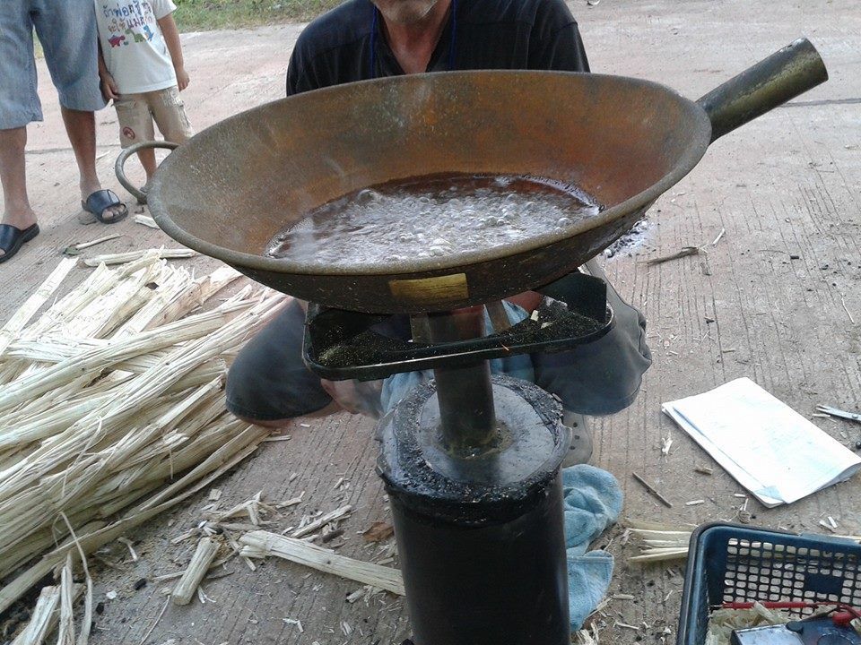

Based on TLUD
Also implementing a thermoelectric element, once fired up , this element takes over the fan
The charcoal obtained from this process is perfect for the gasifiers…
we tested sugar cane and rice husk already.
For the rice husk we make a modification in the TLUD, making it an BLUD ( Bottom lit up draft )
With the BLUD , you use all feedstock for making cooking gas, no wasted biochar…

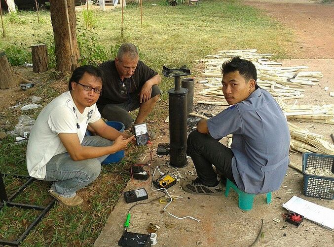

Koen, when you say thermal electric element, are you referring to a TEG? If so, where and how are you using it? How much electricity does it make? When I finish my truck build, want to implement that on my system some how. I bought a dozen TEGs and heat sinks to go with them.
My thoughts are to maybe use these with some TECs and maybe cool down the gas to lose a little more moisture before the engine.
Yes TEG.
On the picture my friend holds a voltmeter, we have about 1,5 volt and connected that to a upper to feed the fan from the cooker.
using the hot side near the heat source as close as possible ( 300°C ) and the sink, cold side, in the ingoing airstream at 30°C would produce 2 amps , 3,6 volts. its all about what TEG you use and where you install it.
Koen; Are these pictures taken in the Nong khai Technical lab? Is that all you have to work with? What about the welding etc. how are you doing that.TomC
This is in front of my house at the campus
These guy’s are from automation classes.
As we just started with the gasification group, there is a lot of planning ahead and budgets to ask for.
The little experiments i prefer to do them exactly where i do them now, closely supervised by me.

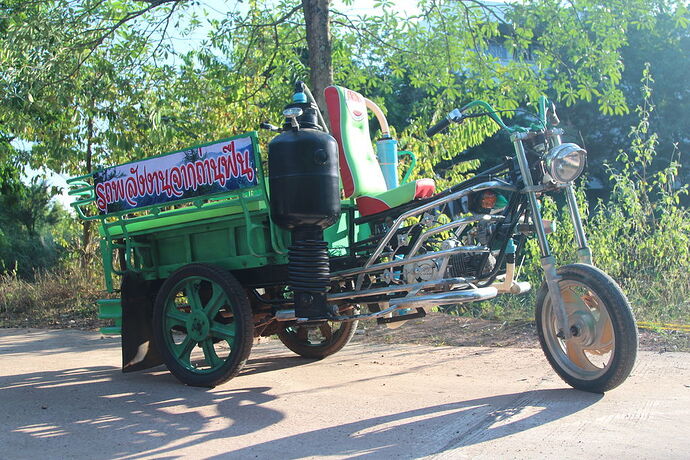

i rebuild their trike to my standard configuration.
Now preparing for testing with gasoline and charcoal.
calculated the nozzle size between 4 and 6 mm ( they tend to run on very low rpm )
stripped the tank, porting and valve timing
after the initial testing will modify ignition ( cdi)
still have to work on some wiring for the lights and the blower, but looking good so far
Very interesting! It appears that a loop of tubing under the reactor assembly is holding the whole thing in place? Do you also have some other mounting tabs? Also, those rear wheels are interesting, and seem to be very old. Some of the “spokes” have parts cut out? Are the wheels made of steel or cast aluminum? Thanks for posting.
The whole reactor is standing on a steel ring, welded to the frame of the bike, a second ring is holding the neck of the set, just below the filling cap at the top.
The tubing around the reactor is for pre-heating the water into steam, before entering at the bottom nozzle intake.
The wheels are steel, the cut outs are rusted away parts…
The Trike is old… many repairs to do before its to “our” standards, but for here this is normal…
