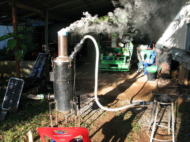

First testing from the dual set.
After this picture i redirected the fumes into the bottom nozzle and did start playing…
the color of the flame from the cooking set gives a good indication from the gas quality..
played with water as well, next i will also try used cooking oil :stuck_out_tongue:

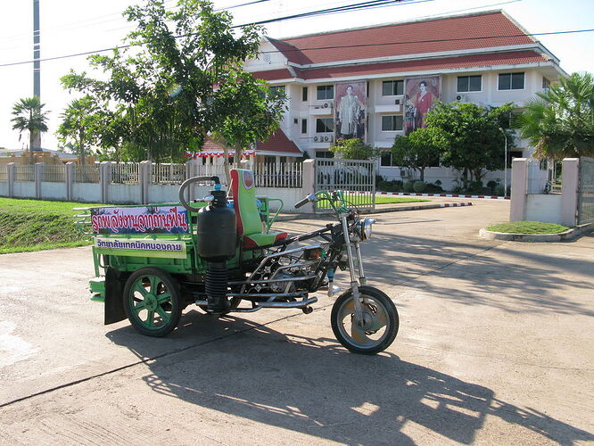

Took the Skylab Trike for a spin around the city
Amazing looks everywhere and no Charcoal at the gas station…
Here a picture in front of the provincial Police headquarters.
More pictures @https://www.facebook.com/media/set/?set=a.398030860344452.1073741830.234793800001493&type=1&pnref=story
I think you have a knack for making ordinary charcoal gasifiers look like extraordinary modes of transportation.
