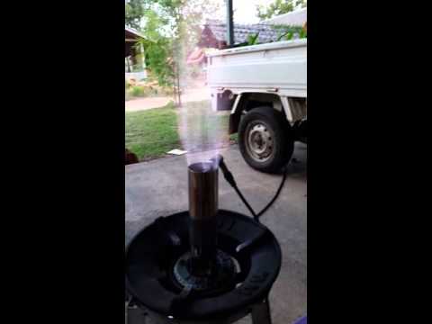

here i am testing larger steam boosts spraying 20 ml of water in the nozzle port…
remarkable effects on the flame
more experimenting… this is taken with another cellphone camera, amazing what it does with the color…
here playing with air mixture, how does it change the appearence of the flame…
when the pipe is reddish, and more air is mixed, the flame turned towards green color.
i think the green color was from the pipe metal…

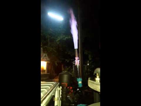

testing a new flare torch and electric igniter…
Overpull changes the color, no filter installed with this testing.
Igniter works, simultaneous with the little fan.
Damn, these little fans are strong and cheap…
Hi Koen can you give a closeup of the fan and maybe an add or package of what it looked like before or what it was supposed to be used for? Thanks, David
http://www.lazada.co.th/stermay-2-ht-202-inflatordeflator-black-1044908.html
Its this one i use, minor modification for the couplings i use
They have an 1" size in and outlet, i took out the plastic grid inside to enhance the flow.
