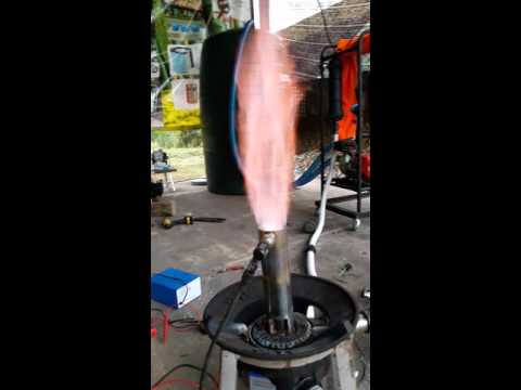

Look here how the flame color went from blue to red and back to blue after startup…
Its the gas quality rapidly changing in the small reaction zone
once a steady constant flow, within its limits, it stays nice colored blue

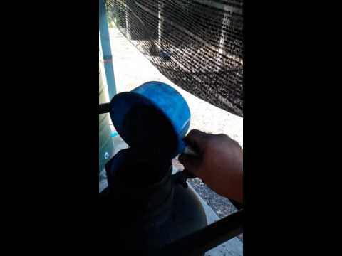

Koen, did you empty the charcoal so it could be dried because it was too wet? Thanks for posting this information.
Hi Ray,
No, not to wet, but i use this as a part in my training course here to do good maintenance for the farmers to use this.
if the charcoal is dry and clean, they can start it more easy, faster and it produces less smoke.
15 seconds for dry, 3 minutes for “wet”
If the whole content of the gasifier is wet, then it takes time for the gasifier to balance in.
But the whole is showing these effects, for others to understand their own builds.
