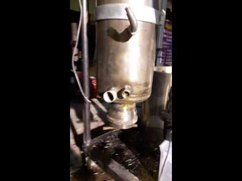

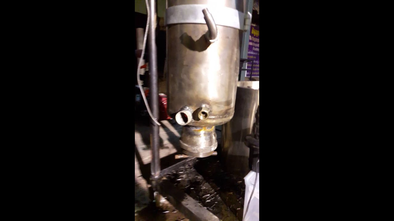

The fast startup from the cooking gasifier…
From “fire in the hole” till cooking flame… less then 45 seconds

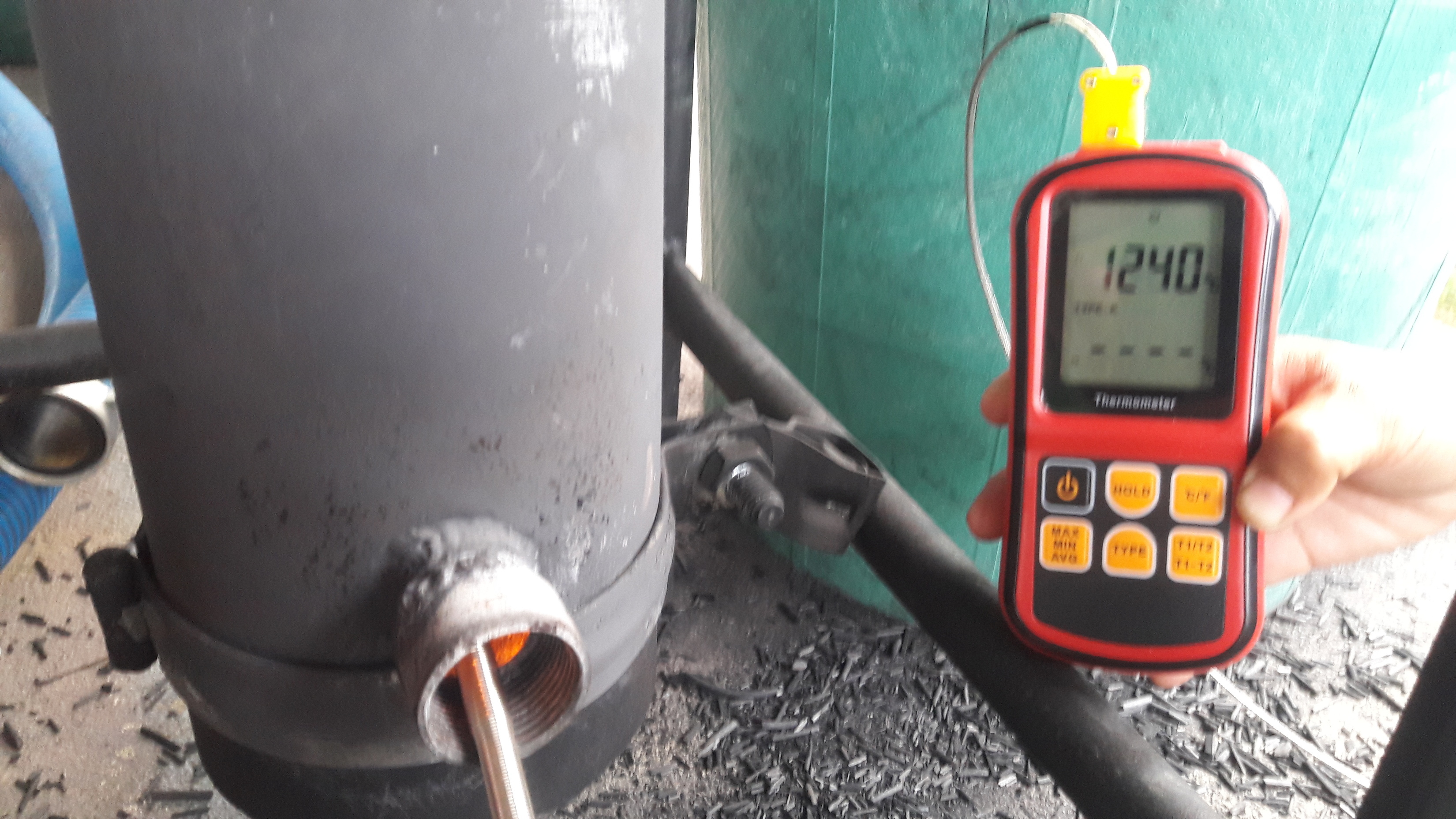

Hi Koen
I think I read in some topics in arrears, you Regulate your temperature reactor with a PDI, a thermocouple and a solenoid valve.
Or you find that sort of kit?
I find it reassuring to have a temperature control for my first test.
