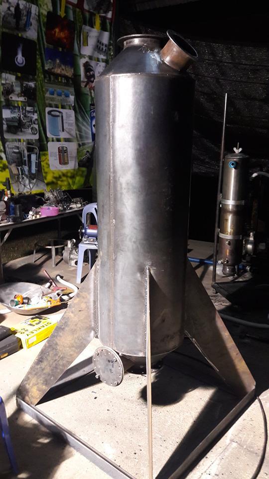

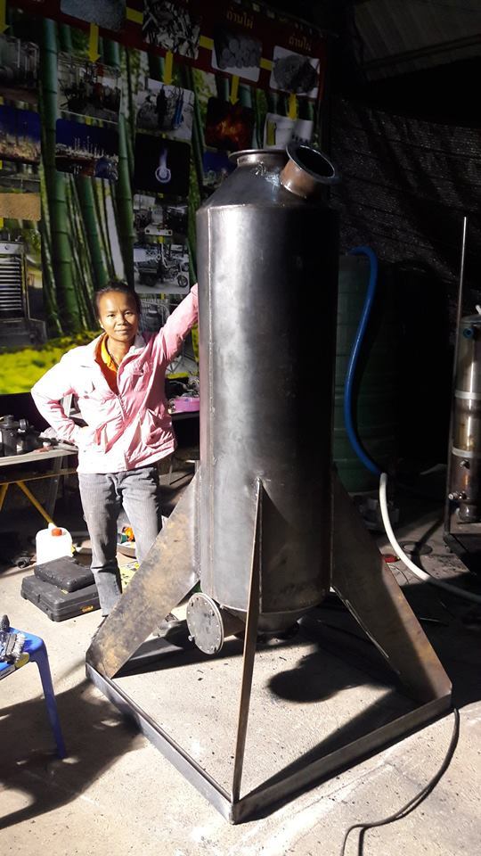

yup, i am learning how to weld the bigger things …
and she’s happy with it :wink:
Ow yeah, this one is for a huge distill / cooking set (booze) , to provide the heat for the cooking
Welding it on the chassis, next the small one, learning by doing…

Koen; One thing that jumped right out at me with this build is, 3 legs might work better than 4. You know that old saying that 3 points determine a plane. The 4th leg might make it harder to sit steady on a floor. TomC
Good point Tom, I build 3 legged log tables because they stand on uneven surfaces much better. Oh yea it is way easier too.
