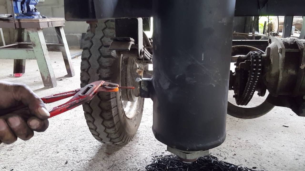

Some like it hot inside…
These pictures to show how big the glowing mass is inside the gasifier, pulling at 5 Kwh cooking stove.
Inserting a welding rod thru the nozzle, size of the reactor tube is 5"
