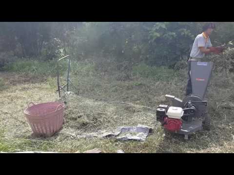

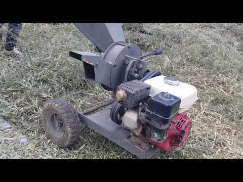

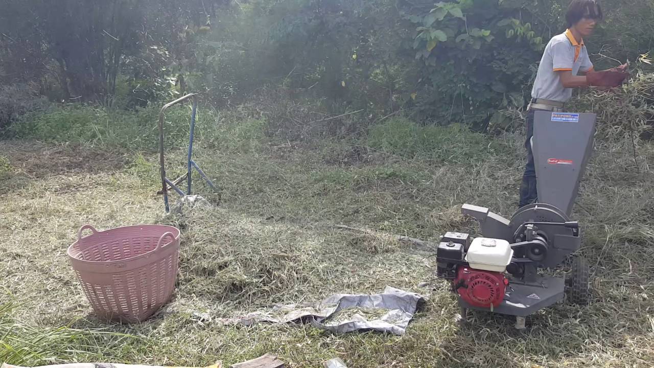

I have my little chipper up and running for the bamboo waste / fuel prep…
Its another candidate for a gasifier…

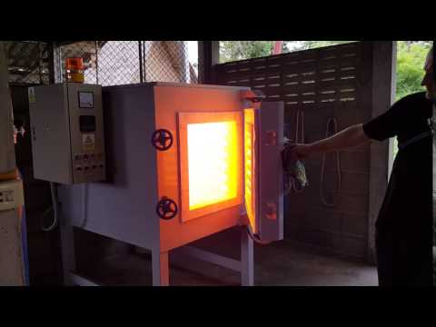

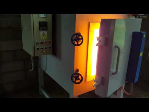

New toy arrived, playing already…
How hot can it be inside ![]()
Upgrading and testing from charcoal…
up to 1400 degree celcius… and some more applications ![]()
