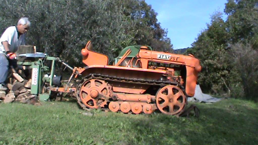

yesterday was the transport of the new old fiat tractor from 1950 with hand-cranc…like tone´s fiat…but in what conditions i dont know…mabee i must refresh the ignition magnete with the reciepes from our swedish engine doctor göran…
the owner secured me at the phone that the engine runs, so , because not having car for make a visit before( it is a bit distant), i had to go immediately with a friend with his military truck to load up…but there the tractor notstarts, also not drafted by another tractor…the owner says because of cold freezing weather, and showed me a short film from yesterday???
(who knows) where parts of the tractor were to see, and some noise of a motor…but maybee?? the noise was from another tractor nearby, this would be typically italian…
anyway,half drive was done, so we loaded up hoping we bring the tractor to run…next days i will try if the spark plugs make a spark…the rest of the engine looks good, the exhaust pipe is always complete original , what could be a sign that the engine not has worked too much…the chains are a bit down, but this is not a problem for my use…

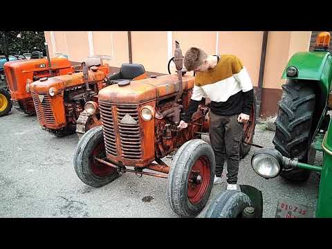

That is a really nice tractor Giorgio, congratulations! (Im very jealous)
Is the magneto a Bosch or Marelli?
If you got no spark, check points for corrosion first, can be a very hard layer, best is to use fine sanding paper, 800 grit, the type for metals, or the “wet sanding type”.
Does the magneto have a “impulse-coupler”? (Makes hard, clicking noise when engine turns over slow)
Giorgio, I’m glad you got the tractor, I see it also has lights, mine doesn’t have them. The first series of these tractors were without lights, but then a dynamo and lights were added. How do you feel the compression (sealing) of the engine when you turn the starter handle? Is the clutch soft, or do you have to use a certain amount of force when pushing the lever forward? I look forward to your posts about this tractor, 100% wood gas. :+1::grinning:
tone, the compression seems good, the crank handle goes strong…the clutch lever needs a bit of force at a certain point when pushed forward…i think it is from the second series 25C , maybee those have the gear a bit slower as your 600?
the left hand chain clutch goes more forward, maybee this is more consumed from working on the fields with the plow…there must be always turned to left side, when it is not a reversible plow…
doctor göran, the magneto is a marelli, has a impulse coupler like tone shows on his video starting the fiat tractor by hand crank

A working impulse coupler is very good if you intend to hand-crank start it, otherwise you probably need help from strong-man Tone, spinning it like a drill. Always a good recomendation to only “pull up” the crank, with thumb parallell to fingers, minimizes the risk of broken thumb or wrist if engine backfires.
If magneto is totally bad (broken or bad windings) there is possible to “convert” a magneto for battery ignition, drawbacks is a battery and alternator/dynamo is needed, but a very cheap way to get it running (have done that on my volvo t31 tractor)
