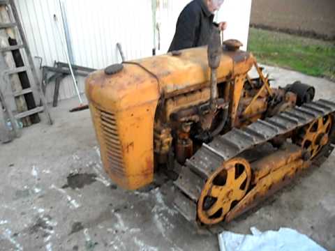

nearby -50 km- someone sells a fiat 25 c petrolio chain tractor…but a bit expensive..

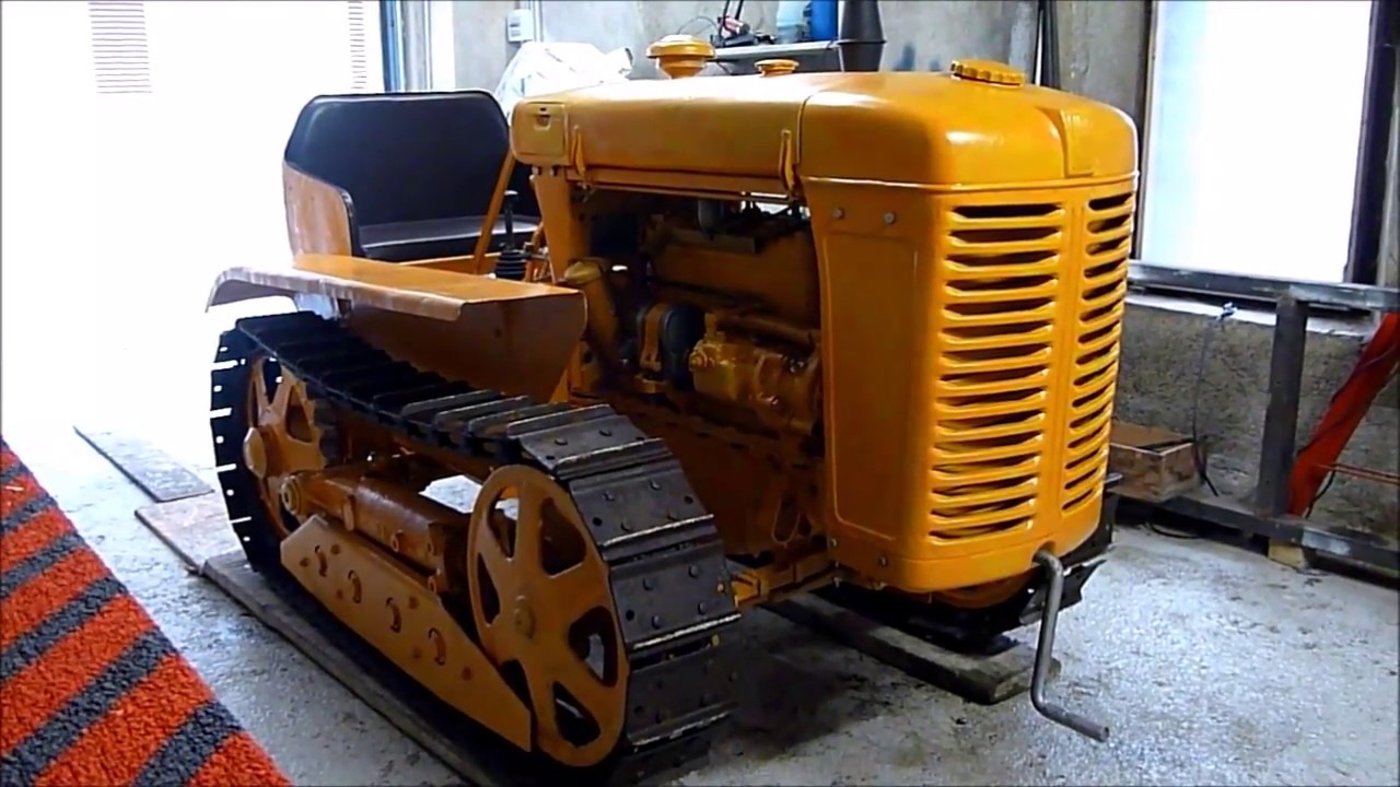

and here the same as tone`s tractor…only chain version…
and the model from tone…
