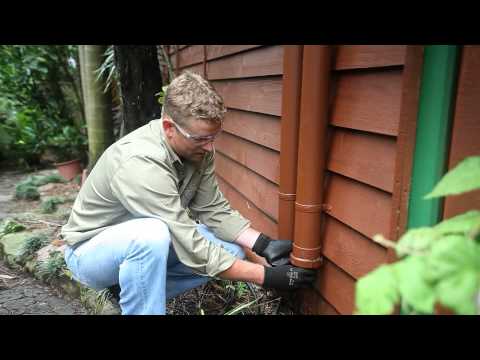

Hi Chris, I built a first flush device for my rainwater. Mine does not even have the ball. Here is a good video explanation:
Very nice David. I’ve finally got the WISY filter installed, it handles everything large and small down to a very small size, and is self-cleaning to boot. It also seems to oxygenate the water really well.
