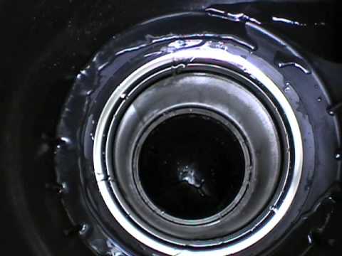

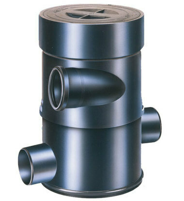

Here’s the coolest part, the WISY WFF100 roof washer. This guy is not cheap, but will be the heart of my rainwater collection system:
Check out how it works:

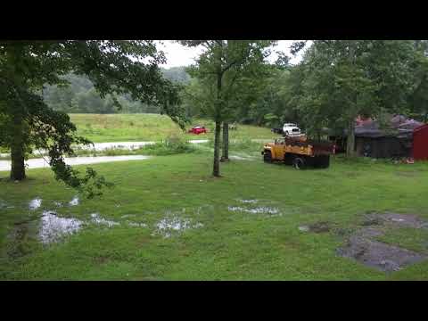

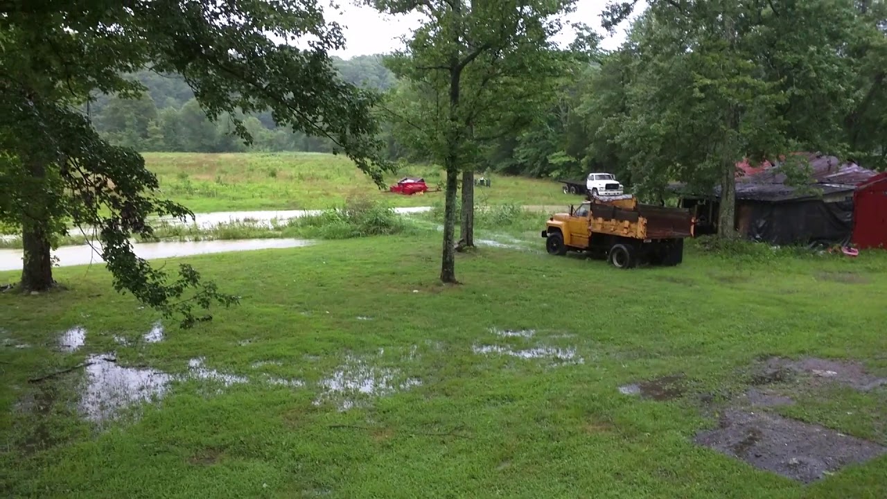

Drainage is another project. Every time it rains heavily, water gets right into the basement. This should not be the case since the basement is at ground level on three sides. But the surface flow is so fast and poorly graded, it just runs up against the house and inside. There is a drainage ditch we can send the water to, although it gets very full.
Here’s a short video I took last year showing what happens in a heavy rain. Note the standing water.

I would look into a French drain here is a good discussion of drainage.
