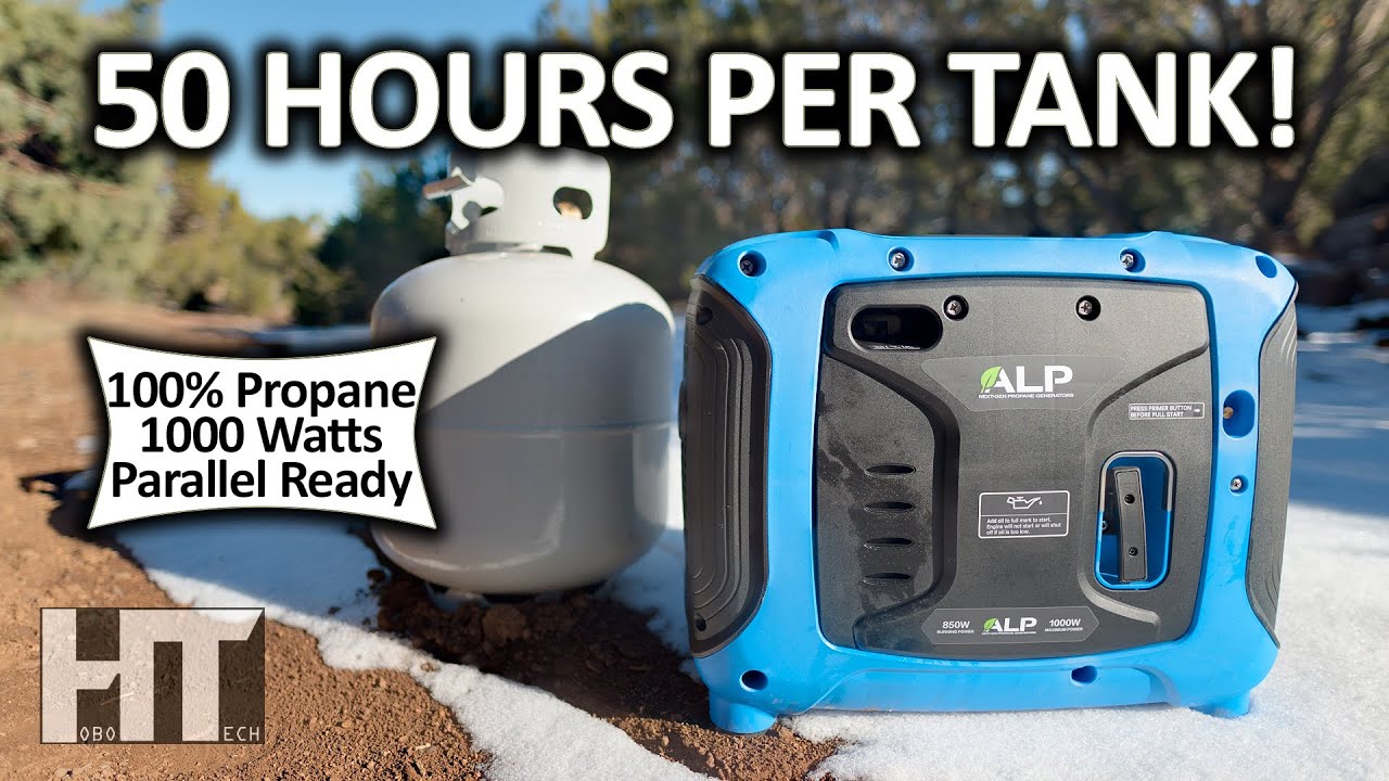

Kind of an interesting inverter generator:
Hey JeffD,
good find. The video you put up links to this one:
A bit long but the best subjective details in the last two minutes.
And propane as a fuel skips around all of the long term gasoline in generator problems.
He did an update because he did not do the sound test correctly. He was too close with his sound meter. Really not much of an update. I bet the engine has a higher compression ratio for propane.
Ok please don’t run that thing inside the house .

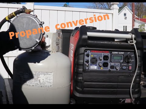

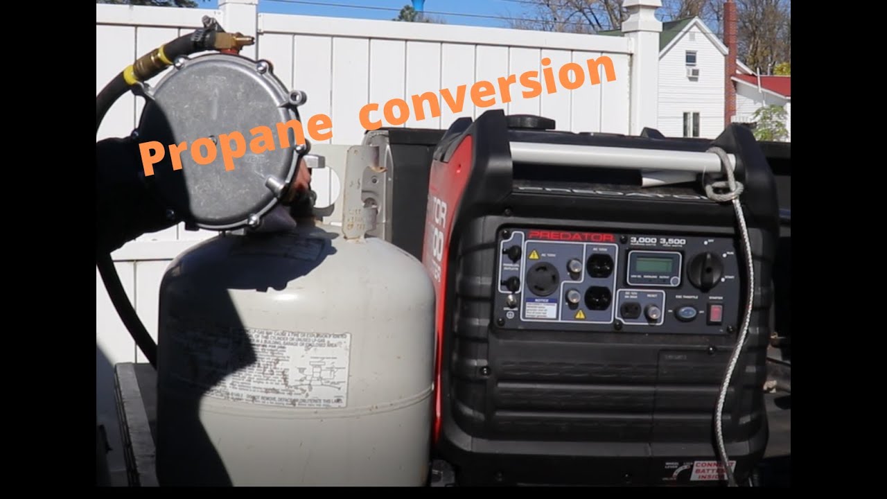

Propane is an excellent idea. Here’s a guy who converted the Predator 3500 I got to run dual fuel propane/gasoline.
I always have propane around here, so it seems like a worthwhile upgrade to be able to run both. I’ve ordered the conversion kit here:

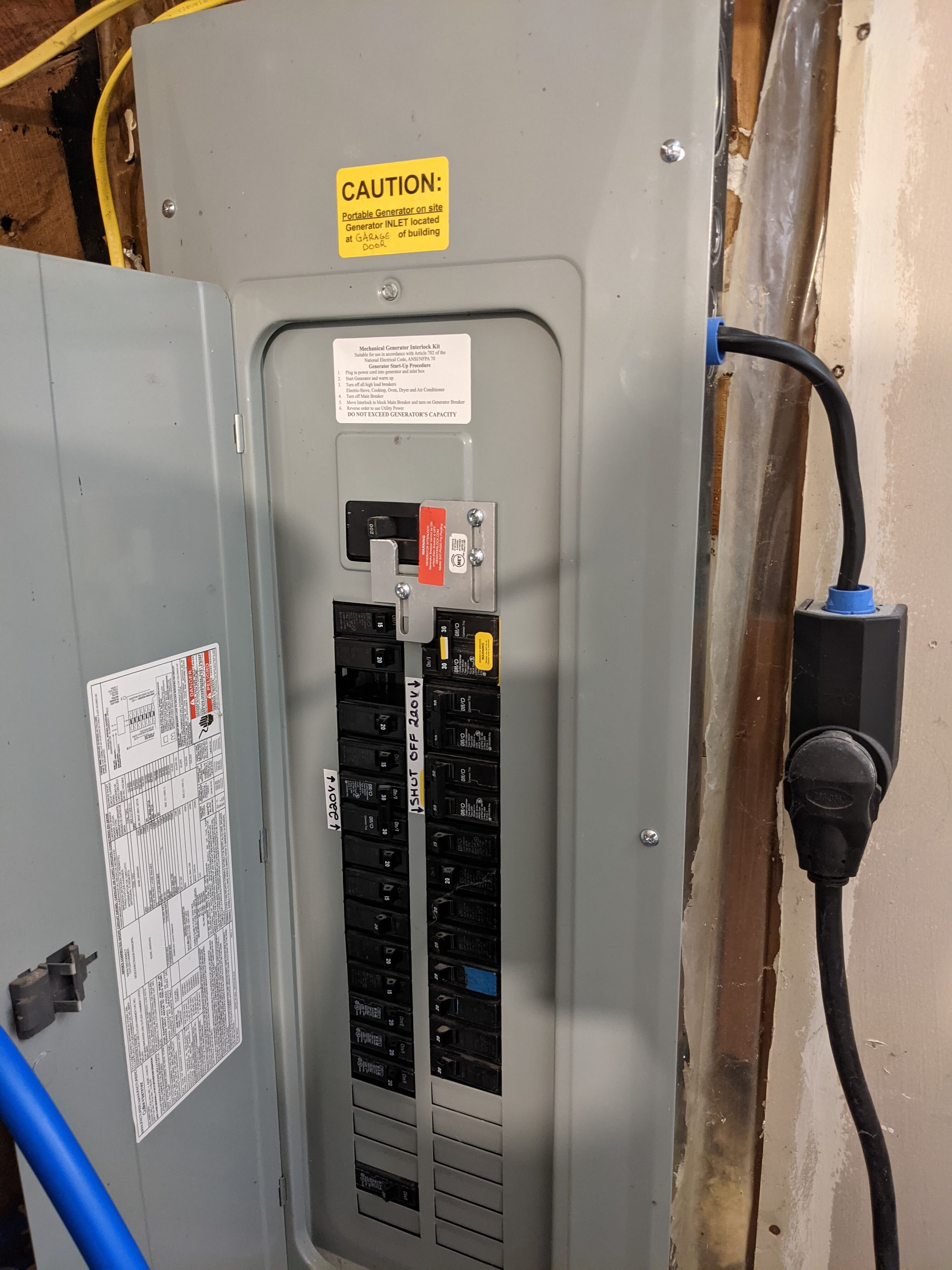

Progress with the generator, I have wired things to my satisfaction. After some research, the breaker panel interlocks are acceptable where I’m at, and they satisfy the real-world safety issue. I installed this kit from GenInterlock.com:
It requires half a brain to shut off the 220v breakers before running the 110v-only inverter generator, but that’s simple enough I can rely on the wife to do it. And if we ever get a bigger 220 capable (probably tractor-PTO) generator, I’ll be ready to go.
So, I’ve tasted being off-grid, and I like it. I successfully ran the entire house (minus the 220 stuff), which fluctuated around 700 watts, about 25% of the gen rating. That’s powering 3 fridge/freezers, lights, ceiling fans, a TV/stereo, and my computers. Very good power quality! We will be quite comfortable should the power go out, and my fuel-sipper seems to burn about one quart per hour making that much power.
More to come, once the propane kit arrives…

Outstanding Chris! Fair warning the off grid taste of independence is hard to get out of your mouth once you see the return on your pocketbook! Leaves some extra cashola for the fun projects later down the road :+1: side note I sure wish that switch was code compliant here, the enforcement folks would crap a cow if they saw one

So Chris is that the type of Panel we talked about? It looks like you have the double lockout breakers. Did it have the neutral from the generator going to a lug on the generator breaker? Apart from the loose plug next to the panel it Should pass the most stringent electrical codes. Plus it leaves you a lot of room for growth down the line. Won’t be long til you hook up an inverter for those loads, then panels, then a gasifier charger then a bigger array… :grin:

Hi David,
No, the neutral goes to the regular neutral bus, is that wrong? it’s a standard 30A breaker. I wired it just like a welder plug, two hots on the breaker and the neutral and ground going to the bus bar.
Is there a different type of breaker I should use? I’ve never seen what you’re describing.
The generator itself is floating (not grounded), which I think is correct in this situation. Both hots are joined using an adapter cord. The house wiring is ready for a real 220v generator.
Oh, and the plug to the right is mounted to the wall, maybe it looks loose but it’s bolted down.
