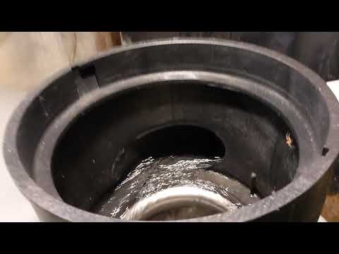

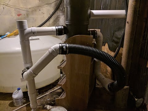

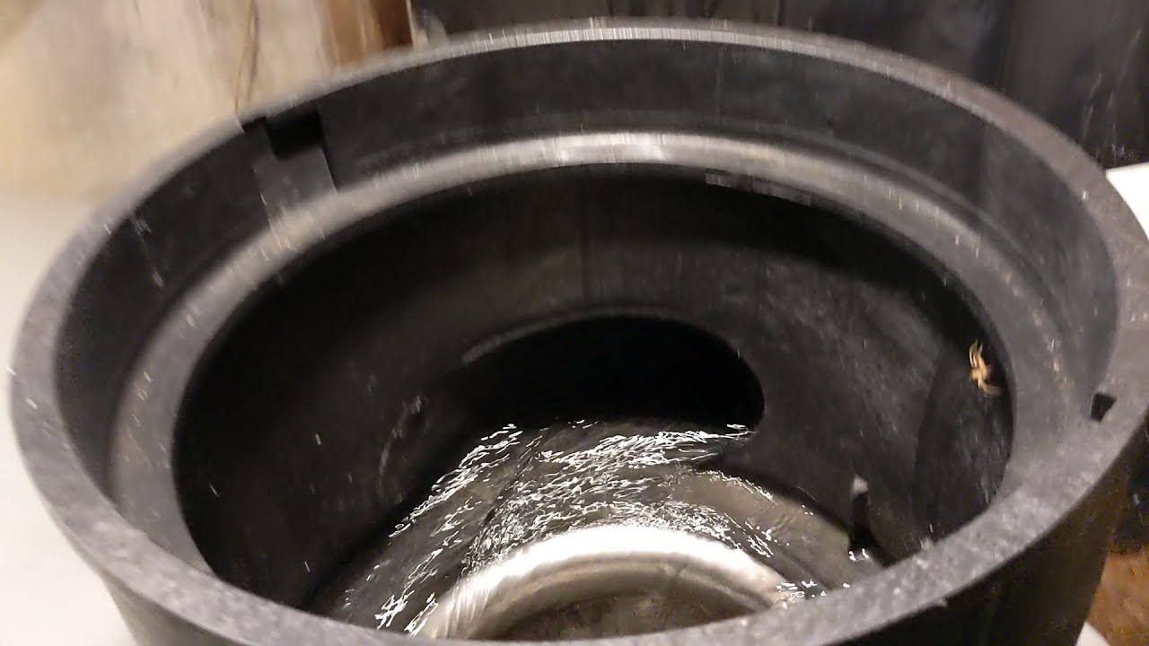

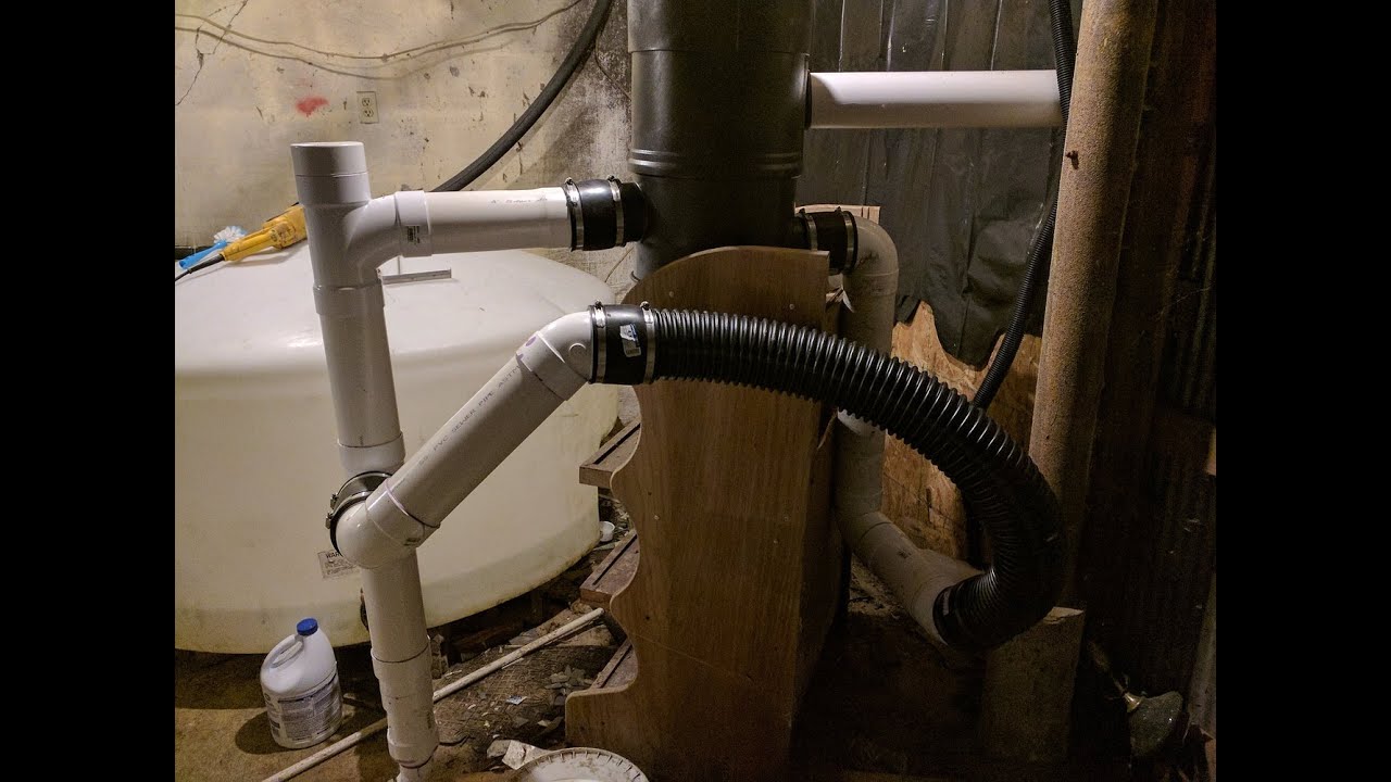

I did a walkaround on our current evolved rainwater system. It works very well for our purposes.
Then it started raining! So I got a little more video.
Enjoyed the vids Chris, caught them on youtube before I saw them here
I had intended to merge them, but apparently Youtube doesn’t allow that anymore… Oh well.
As pricy as the wisy is, it sure looks like a skookum setup. Is the filter mesh removable as an element or is it a life time fixture?
The mesh is a removable stainless insert, in case it needs cleaned or replaced. You can also get a solid insert for it, to bypass the filter entirely.
The WISY is actually intended to be buried and driven over, it’s extremely thick sturdy plastic. The major benefits are the water oxygenation and the self-cleaning screen. It’s the key to a hands-off system.
Hey chris, I finally got around to watching this; great setup!.
The only thing I think I would have added would be a way to move the shurflo intake from on tank to another and a way to isolate tanks. My thought was that you could run one dry from time to time and bleach and clean it. Or a second pump with a filter to transfer to one good one for the house maybe chlorinated from time to time when the weather is hot… just thoughts.

I can. The suction tube can be moved easily, and each tank has its own shutoff valve. I have in the past shut off individual tanks for cleaning.
I have the parts to make a filter pump. More to come on that one.
