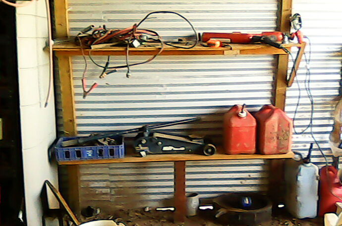

I think I’m going to be ok. Haven’t felt dizzy and decided to go out an work a bit but it was one of the worst “dings” I’ve had for sure. I didn’t do as much as normal and I’m definitely not 100%. I’ll know tomorrow. I have been icing it down here and there - I actually think it’s better to stay alert and do lite things if I can. Thanks for caring! life is so precious isn’t it.. good news is my welder showed up and i made the bottom shevle in the picture after injured. I have 2 more shelves to go and this isn’t going to stop me. it does hurt though and i’m working slower. this only happened because my place is a mess.
Neal, the bottom shelf looks functional. Seek help if you need it.
Welding splatter can go a ways. The spray from a plasma cutter or torch can too. Be careful with the wood, flammable items in the area you’ll be cutting and welding in.
Ouch. That picture hurt my head.
