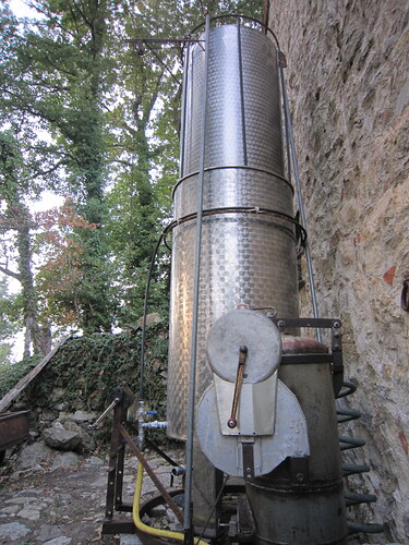

here the gas store tower. the upper barrel is near 500 liters full with woodgas, the under barrel is full with water and the water works like a flexible gasket so the gas cannot escape…the upper barrel was lifted up with a little winch while the gasifier delivers the gas.
the stored gas but is only sufficient for circa 50 minutes cooking with one burner.
i thought it would be longer because of the corner dates i found, i thought 3-6 days for cooking, but i think i have not considered the relative weakness of the woodgas and the nearly half volume of not burning nitrogen…for cooking with two fires it is shure best direct producing and using the gas with electric blower

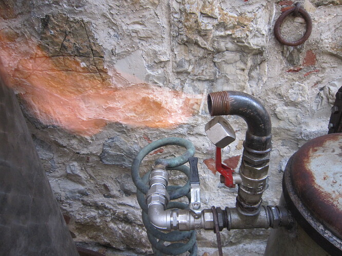

interesting to see- the fresh produced and burning gas has an orange flame, the storaged gas burns completely blue how you can see on the fotos of the burner cups…
A Gasometer! Very cool. Does this give you enough positive pressure to run the burners?
This is indeed an incredible build. Good job. I posted an idea to run a winch powered gasometer a while ago here but never got to build it. But now you gave me courage
Just one suggestion thugh. I have found an charcoal gas powered burner works much better if you drip water in the gasifier. Not only is the gas more caloric, its also faster burning wich helps to dump its energy in the cook pot more efficiantly.
An even better way wuld be to use pyrolisis gas for this. No nitrogen and it alredy has a smell to it!
Theoretically with pyrolisis gas you wouldn’t need to lift the Gasometer as the pressure from the gas exiting kiln would lift it enough. Maybe that depends on how heavy the storage bell is. I know Nighthawkinlight on youtube managed to let it lift itself.
That is the only gas storage device I would ever endorse. Thats pretty cool and well if there is a booboo, Rockets are cool too!!.

the upper barrel has a weight of 20 kg and gives enough pressure. for make more pressure one can regulate with for example iron pieces on the barrel or for less pressure some pieces of iron on the chain of the winch

another thing with the gas tower with the “water gasket” in winter it can get frozen the water and the system not works because the upper barrel gets blocked…
we made the observation with ash-water, also water with added wood ash in quantity that the water after a few days becomes like detergent-like soap water-not get frozen at -7 degree celsius… it was not colder last winter so we couldnt make more obsevations …
this ash water in the under barrel could work well for not get frozen…and also is a good detergent to wash because you can make it by yourself , cost nearly nothing and is free from poisoness chemicals…

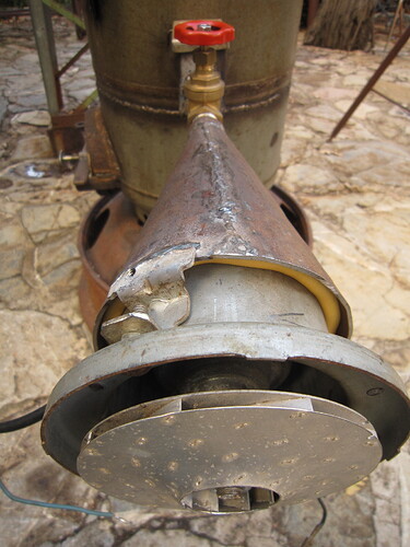

hello woodgas friends,two days ago we made the first try with a electric fan for blowing the gasifier, the experiments wit propeller shaped ventilators were really disappointing…they were not able to move the air throug the conus pipe. yesterday we tried this kind of ventilator what you can see on the foto and this works really very brilliant!!! lightning the gasifier throug the glowing charcoal in the retangular box works pretty well, after very short time good gas was produced with nearly a half meter long flame, i think enough pression for two cooker cups.

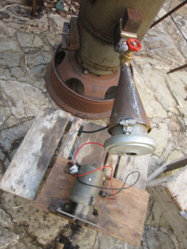

on the foto in front is a 12 v electricity hand generator made from the motor and gear from a window wipper from a truck, we use always for experiments… for working than with a fotovoltaik panel how explained…combined with a regulable current delivery system for regulate the turn of the motor.
the motor is 12 v from a car… from the propeller application what cools the water refrigerator when the engine is off. the 12v motor in this way we use is cooled by the airstream.
the air shuffle wheel is from a hoover , i think my 12 v motor needs about 40 watt?
it was no sun so i could not try by solar paneel the electric need, only approximately by the needed power to turn the generator by hand…

You may be carefull useing ash as your antifreeze. The compounds that prevent freezing like potasium and calcium hidroxide will react with the CO2 in the gas. Great for extracting the useless CO2, but the resaulting products will fall out of solution making it useless as antifreeze… Since you got stainless vessels, maybee just use salt? Theoreticly shuld last till - 15c…

salt water is with my stainless barrels not the solution, because it is not aisi 316, it is only 305… also not salt- sea -water resistant…but freezing here in middle italy is not so a great problem , only maybee for some days or a month… in this colder time we cook on the wood stove and on the gas storage i can leave the water when is frost -danger-because of eventually damage of the barrels, they are relative thin walled…
because of the relative short time -50 minutes -of using the stored gas i think so…bigger cooking how lunch i use direct the gasifier for cooking and have gas a lot, when not more used for cooking i fill up quickly the gas tower, and this gas is than used for short cooking as breakfast and dinner…so i think it makes sense and i must light the gasifier only one times a day…it remains only to resolve the problem with the security switch what needs a greater diameter…

hello bruce, water is the cheapest, the barrel has 700 liters… fill with for example oil or others what not get freeze is expensive…only solution would be to use a double walled container, where the “gasket” liquid is only between the two walls , so is needed less liquid…
but i think gas pressure is less …
