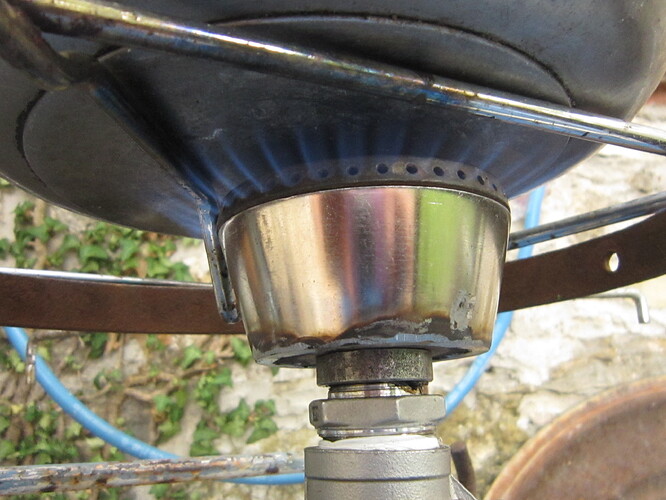

on the foto the first try of the burner “cup” with woodgas flame…
here the air for burning comes from outside to the gas…the same system when we burn the first gas at the gasifier start.
often is to see that the burner cup has holes for air near the bottom. who knows the difference of these booth systems- what is better?
ciao giorgio

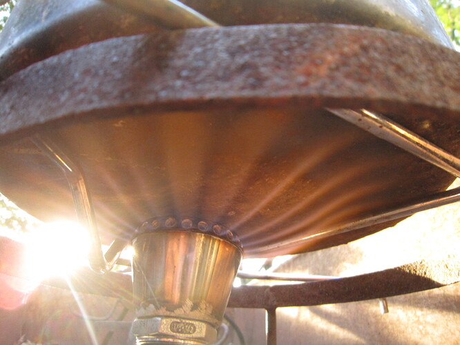

yesterday i made another try with the burner cup, because it seems not enough gas can pass through the holes and the flame remains more or less weak… so i drilled up the holes at 3,5 mm and this works really well how you can see on the foto, very strong flame and the wind was not able to blow it off , in opposite to the original holes- see the other foto, where the flame was very sensible to go off with a bit wind…

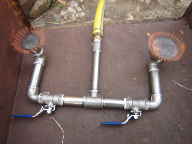

the base of the cooker with mostly 3/4 " tubing

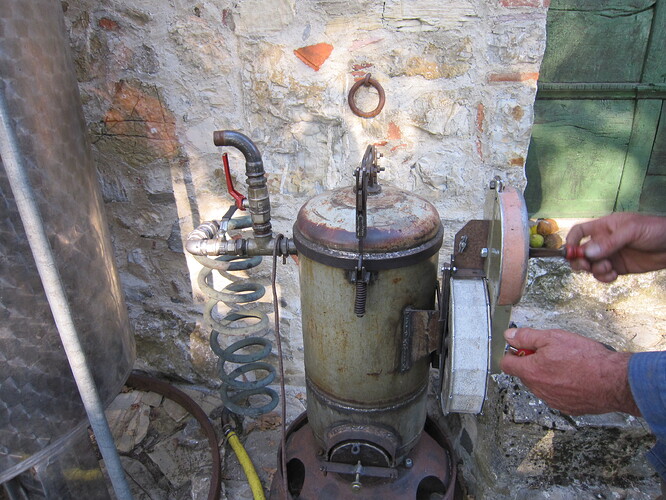

here the updraft charcoal gasifier, at left the gas-cooler unit, at right the handblower with about 1200 turns/minute- the gear is from bicycle sprocket. for cooking the handblower will be substituted by an electric 12 v fan, powered by a little photovoltaik paneel
here a detail of the gasifier… on this retangular box is fixed the handblower…

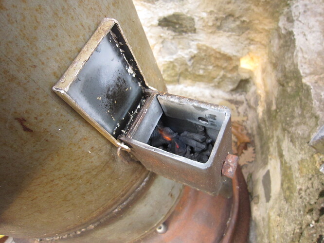

for lightning the gasifier from outside the box is filled with some charcoal pieces, than some alcohol on the coal and lightning with a cigaretlighter…when the coal gets a bit read, the blower will be fixed on and after a short while with open top of the hopper the coal inside begins to glow and smoke comes up, then the lid of the hopper is closed and so on flaring the gas…next foto
