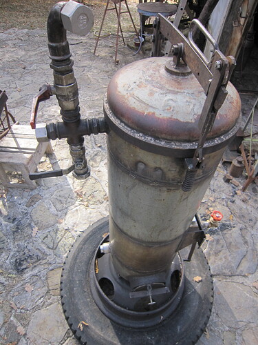

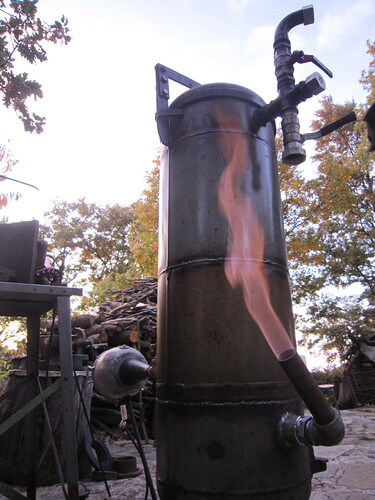

now i made a longer test with the gasifier… the electric blower works very well and also the regulation by the reostat, and consumes very less current.
but the gasifier itselfs makes problems with bridging, so after a while comes also bad gas out and the flame goes off … the goal with the gasifier was that he needs no shaking or simil operations during cooking. and also should not have stirring mechanism with electric motors ecc…with the handblower was different, this makes a bit vibrations caused from the gear and the coal falls down and not bridges. the electric blower makes nearly no vibrations, so comes up the problem…
i made some try with an inner pipe of diameter as the glowing area in the hopper inside down near to the nozzle, but not works, and also weights on the coal in the hopper, but without success…
i must look for another solution now to have a non vibrated or shaked gasifier during operation…maybee like matt ryder or kristijan leitinger and koen van looken …
maybee it depends on the fuel, i use charcoal, the other builder experts seems to use woodchips for cookers??

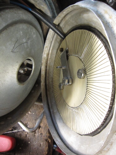

Hello George, you are using a motor from a 12V fan for the blower and you have limited the speed with a resistor made of 45 Ohm wire, which acts as a voltage divider or pre-resistor. I intend to say that if you usually drive your blower muffled, you can replace your pre-resistor with another more powerful 12V motor and an eccentric weight on the shaft, ie two motors in series. The blower will run at almost full power and the vibration motor with very limited power, but the total consumption will be less than the blower itself at 12V.

Giorgio, are you blowing into the nozzle or sucking through the grate with your blower?
hello don, the blower blows into the nozzle, not sucking, and the gas stream goes upward, not through the grate, because it is an updraft system…today i have seen the pages from koen van looken in thailand, he uses a 5 inch diameter pipe as hopper and oxidation. i think in this design the fuel slides down because the fireball in the oxidation has nearly the same diameter than the 5 inch diameter pipe…bridging is like a vault of bricks, for example , and this can only stand when it has a basis besides, so i think when the pipe is narrow like koen`s design, the fuel finds no basis besides and cannot build a vault-bridge, because the wide as the pipe burning area not allows this. my theory.
my other gasifiers are downdraft and sucked by the motor, and also when the gasifier stands beside and is only connected with a longer hose to the motor - also no motor vibration on the gasifer- the gasifier works for a longer time without disturb, i think because the sucking effect of the engine helps to bring down the fuel and dust and ash and so avoids bridging.

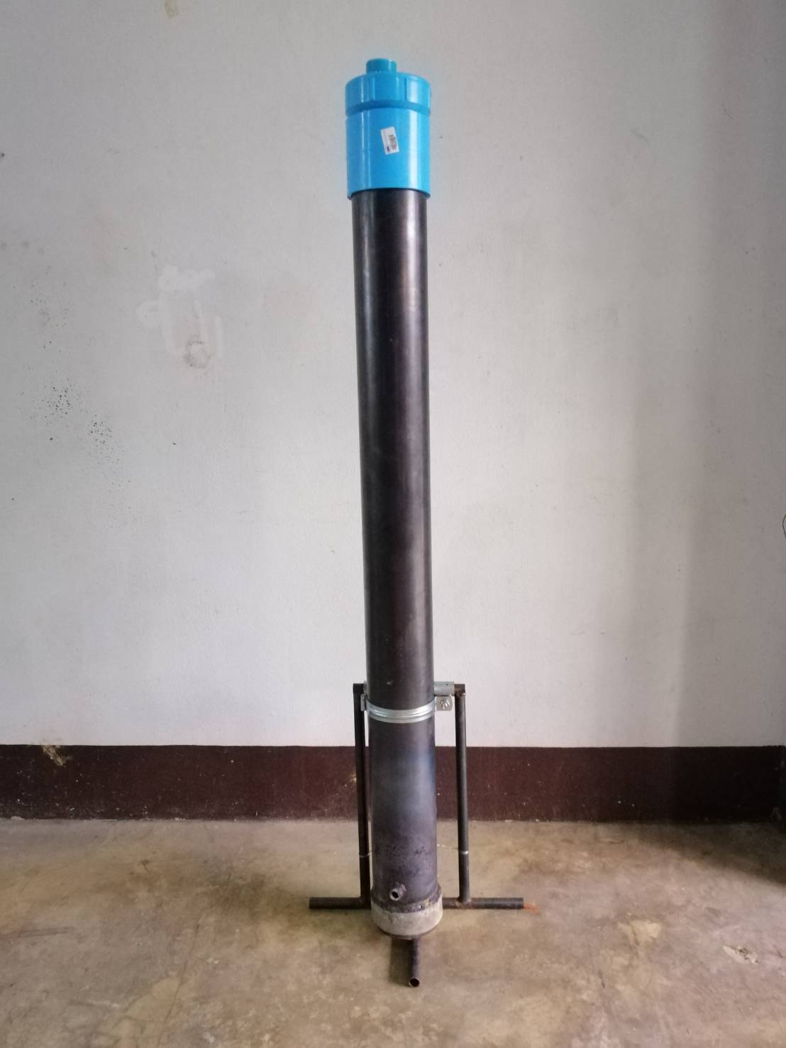

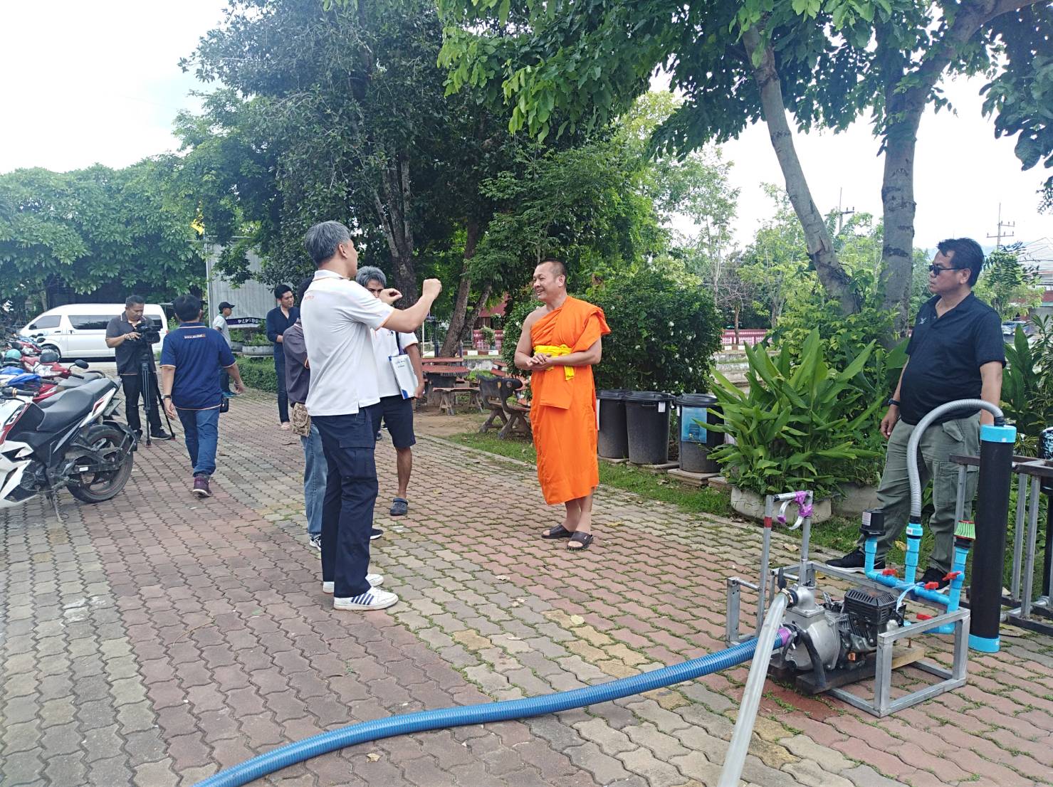

koens design seems -see fotos- to been not vibrated, they stand besides when cooking.

to joep and tone, the gasifier is heavy, and i dont think additional uncentric motor or weights would make a lot of sufficient vibration, actually the gasifier -hopper has double height because i made him higher of the lenght of a complete propane tank for the try with the inner pipe…i think the design of koen is at least the solution, my theory on the response to don mannes …
first i will try to modyfie in downdraft, that is not so difficult, than i see if something changes. one thing was nice with the actually higher hopper - the gas come out very cold, one can let the hand on the lid, it was no difference of temperature burning or not burning-of course with fullfilled hopper, with half full more heat comes up…
i have just a nice 5 1/2 inch pipe besides for a koen design, both usable updraft and downdraft…

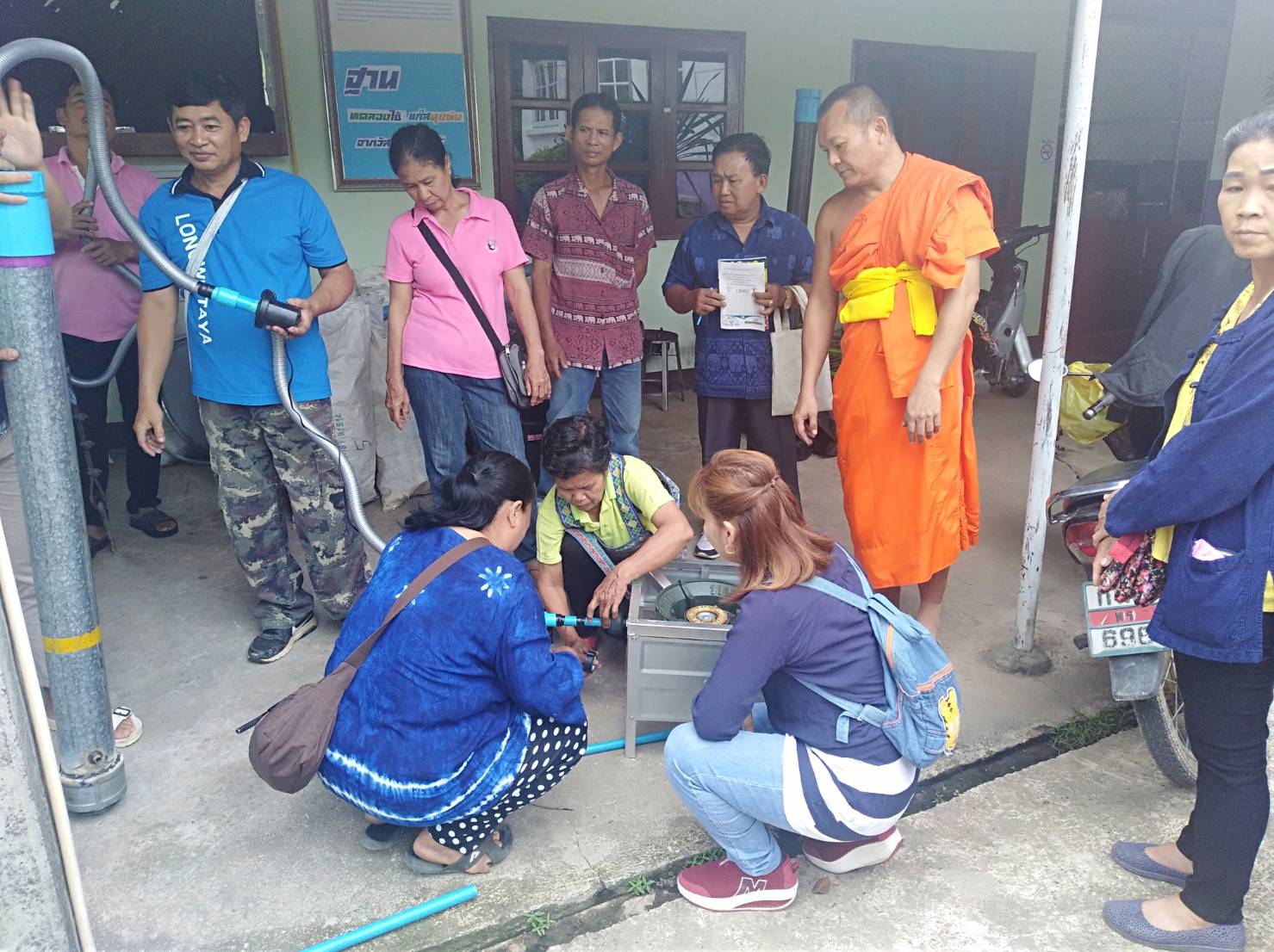

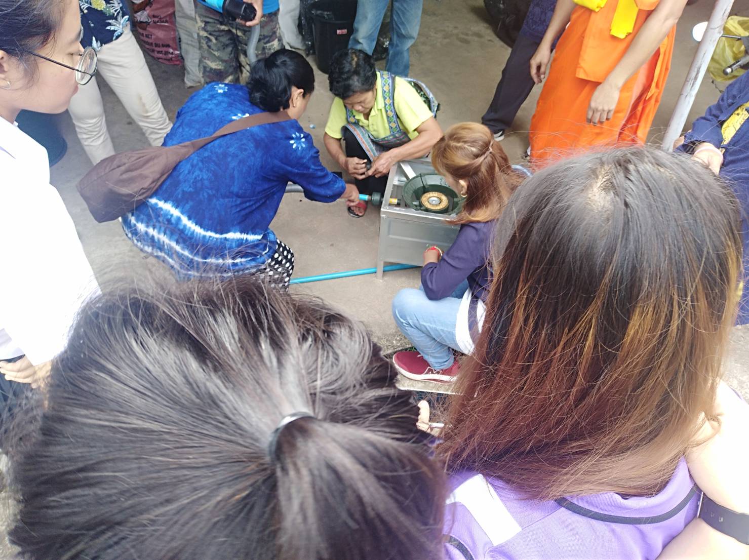

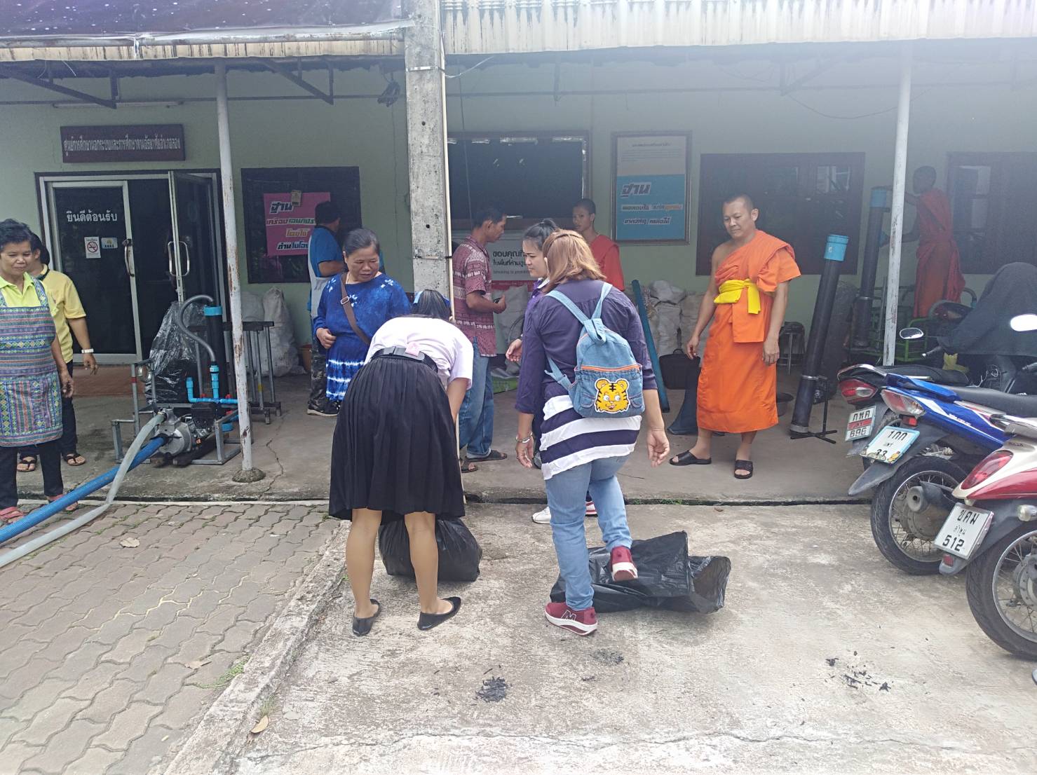

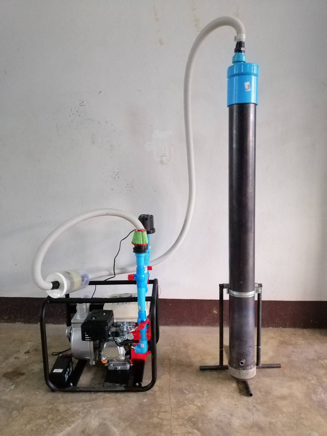

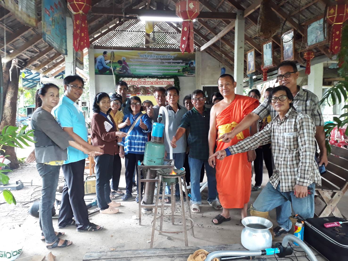

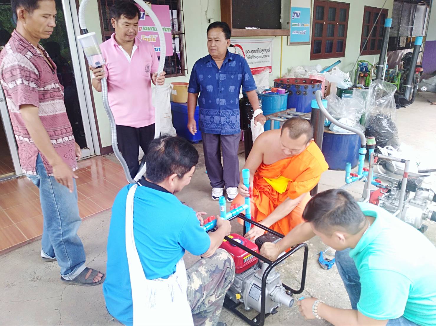

here some pictures of koen`s small pipe gasifiers…

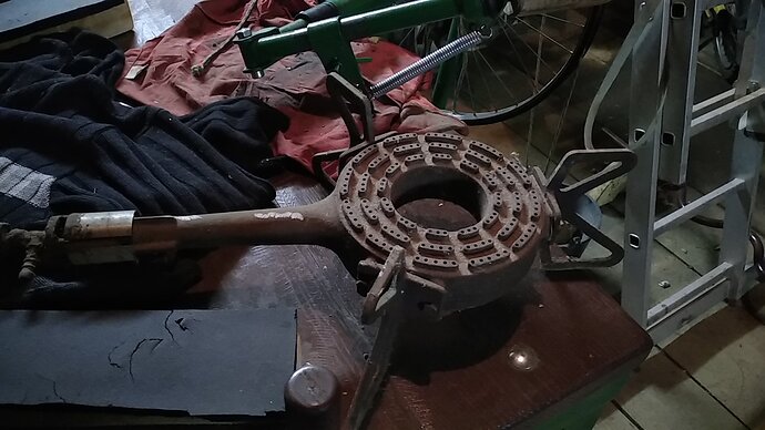

Maybe your air would blow through this burner, the burning zone turns into a wide layer, …
hello tone, i think you mean like a ringfire? like in woodgasifiers, more nozzles, i thought also about this, a ring pipe with 5 or 6 nozzles, but the glow than would be very weak, because of 5 holes instead one, and for the kitchen cooker a soft airstream that comes from the blower seems more than enough for cooking.
the full power of the blower i use only for lighting the gasifier…
Kristjan used a flute, a tube with holes, for his rectangular carburetors, to blow in air, where it worked well. A round unit of larger diameter, when yours is, needs a ring-shaped air intake, so the fuel collapses evenly, at least that’s what I think. Even 5 to 10W of electric power to drive the engine with an eccentric boldly shrinks your gasifier even though it is massive, if you have the engine on hand try it. :grinning:

an old bigger sized tire as base under the gasifier makes a very elastic unit, what can be easy combined with a excenter-electro -motor to create vibrations- only a idea from yesterday…but in the moment i will try the design with a small pipe first…
the blower though works really well, see flame on the foto, and this is not yet full speed, in every way seems more than enough for two cooker burners.

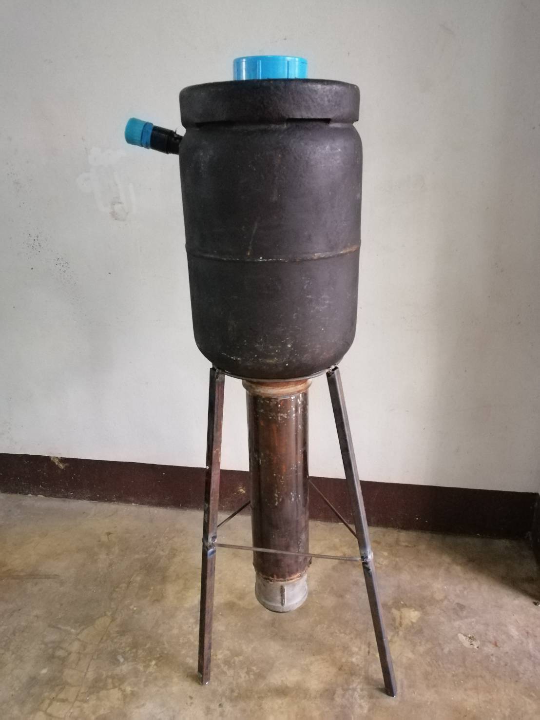

here on the downdraft connexion…
