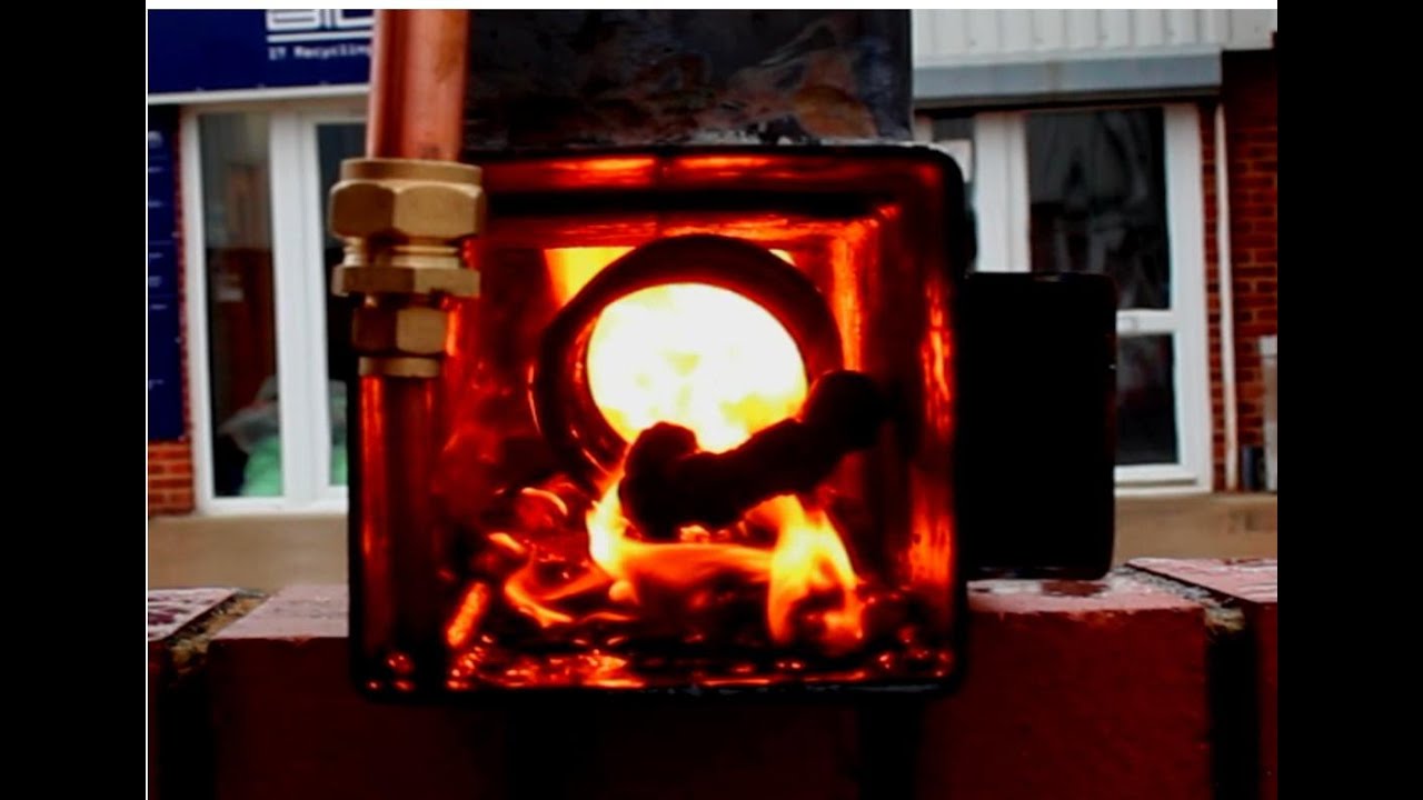

I need to design a rocket stove for my dad. He likes to make gallons and gallons of boiled peanuts.
I have a failed steel rocket stove, but I may be able to salvage it with insulation and an air inlet.
How is it not working right? Like you say. You may want to make an air inlet in the horizontal run.
It isnt getting flame out the top, it’s also not getting a draft very easily. I think I need to add a secondary air.
Also insulating the chimney area would help, I can do a wrap of ceramic wool and then skin it with some sheet metal.
This was something I had made in the spur of the moment after seeing that 4" square, has 1/4" wall too.
