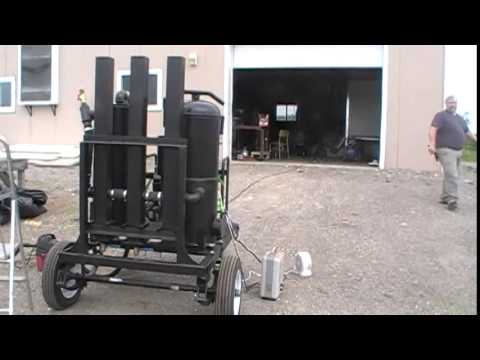

Hard connection between gasser and cooler is made… everything from here are soft connections so it gets easier.
Arid
Are you using the trailer frame as part of the cooling system? Tough for me to see on my phone
No. The trailer is just a trailer. I’ll post more pics as I clean it up.
First stage cooling is the gasifier lower body. It also acts as a cyclone. The 3 cooling towers in the back have over a square meter of surface area. They also act as drop out boxes. Final filter acts as a cooler with another square meter of cooling surface…

Sounds nice and healthy!
Nice, but not very nice of you chasing your friend around with the camera like that
@tritowns That’s a slick looking unit you got there.
I agree with J.O., that’s not very nice to chase him around with the camera.
thanks… Richard and I had that conversation… he thought he was getting out of my way…
so, about 3 and 3/4 hours run time and used about 60 lbs or chips. for the most part it was pulling a 3000 watt load. I guess it works
