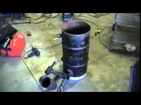

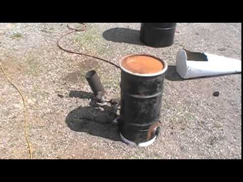

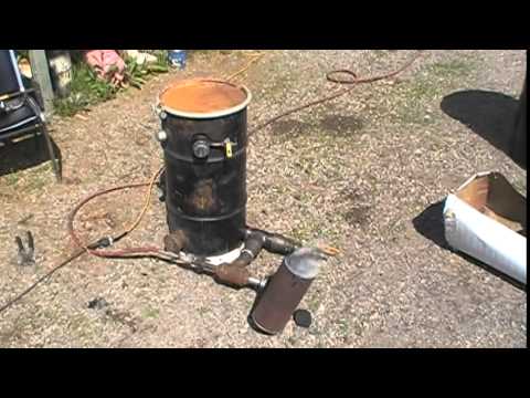

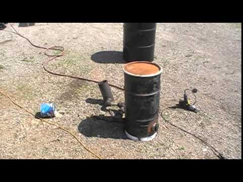

So the new unit as built only has 30% more hopper capacity. It does now have air pre heat, has a grate but is still concidered hearthless. It doesn’t have an ash binn. Everything goes out the gas outlet… it ran better than expected but it did seem so have some plugging after about an hour and a half of flaring. Its been left capped off air tight till tomorrow so it can cool down and I can go all csi on it.
Working hard at trying new ideas… don’t know if it’s better than what I already make, but it sure is lighter…

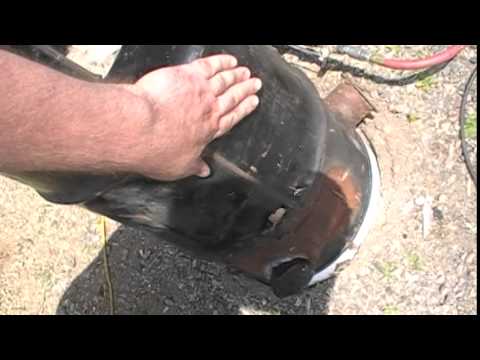

So I took the gasser apart, as much as I could as it is welded into the bottom of the drum that houses it.
Everything looks real good inside… I was kinda starting to think I had a grate meltdown. My gas evacuation tube was somewhat plugged… I figure the grate openings are just a bit too big and let some of the larger char I had loaded it with slip past… I can fix that in a hurry and i’ll be back to testing…
More than a little pleased with the new unit so far… it was all my fault… I thought better and didn’t change it before testing… shows to go ya… if you hear that still small voice… maybe you should listen to it.
