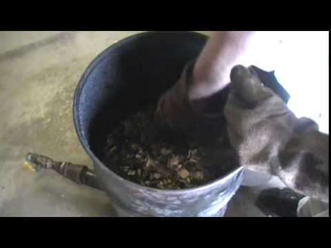

burned it for about another hour today… hasn’t exhibited any plugging… shut it down as air tight as I could make it… gonna try one more thing tomorrow and if it’s looks right i’ll see about putting together a filter train for it. It flared huge, just there was a lot of moisture in it as you could squish the water out of the chips we’re using. So I know we’re making some tar… I don’t have any provisions for catching hopper condensate in this unit… I will in the next one for sure. And yes it looks like there will be an next one
I can say even with wet chips this new little reactor seems to make char no problem. Every time that I’ve had to clean it out to make a change there has always been char well over what would be considered the nozzle ring.
Ran for about 2 hrs today. Unit started to seem like it was sputtering near the very end… again, I’ve capped it all off as airtight as possible. We’ll see what it’s like inside tomorrow in the am. I still think that while my grate spacing was too large on the first grate it’s design worked the best. I may try to redo it in a similar fashion but with smaller spacing.

I put wood in the top and it makes its own char… like all gasifiers do… I don’t consider it a charcoal gasifier though it sure makes its share.

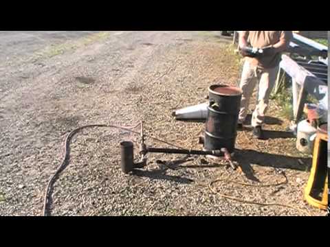

another hour burn time on it… this time with the new grate that I took a couple hours to put together… I think this one might just be the one… here’s hoping at any rate.
I put an extension pipe between the gasser body and ejector… hey look at that, the gasifier body doesn’t get as hot from the flame pouring out of the swirl burner.
Another hour burning… wind is crazy strong so i had to put a cage around it to keep it from getting blown out.
I’ll clean it out tomorrow and inspect the grate… if it looks reasonable I guess it’s time to think about a filter train and cooler so i can try the genset on it.

The latest build that I’m testing isn’t a cross draft… though in some ways may operate kinda like that. If I opened the lid and show you a picture there wouldn’t be any secrets at all… and then I’d have to kill you… lol.

I sure like using bits and pieces that are just laying around the shop… no additional welding required… as soon as some silicone hardens and Rich finds me a chunk of 1 1/2 hose I can give it a go…
Hey Rich!! Get that piece of hose over here. I want to see this thing work. I have no idea what it is but I think I see a horizontal cyclone and a cooling rack What is in the tanks, few people know.TomC
