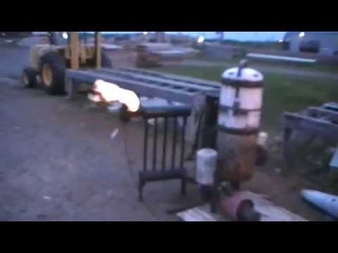

flared the gasifier for over an hour today… no shaking, no poking… just lit it and let it burn… nice clear flare… when it went out on it’s own I just shut everything down. I’ll let it cool till tomorrow and see what it looks like.
if it work the way I’m thinking it did, it’s time to take this one apart, give it a good cleaning and a coat of paint.
I guess we’ll see tomorrow.
Good job Arvid. What did you use for that hour of run time an air powered ejector or a vacuum fan blower? How did whatever you used compare to an engine draw? You light it at the bottom, right?
I still need to make a better cooler so I was just flaring.
I light it through the top then fill it with chips, just like all the gassers I’ve built to date. I may incorporate a lighting port on the next one I build… maybe for my lawn tractor… we’ll see.
I did have to shake the dust outta the chips, but it’s still as good or better than before.
The ejector pulls a lot harder than the small genset we use, but not as hard as the case tractor.
I haven’t lifted the lid to see what was left I it. Just let the flare go out and then shut everything down. I’ll know more tomorrow when I open it.
well, gasifier still had more fuel in it than I expected so I poked it down and re lit it… made good gas till it stop flaring.
Opened it up and there was a nice char cone from the nozzles down to the grate area… i think I figured out the fuel hang up so I’ll let it cool off and then pull it apart so it can get cleaned and painted.
fun stuff.
