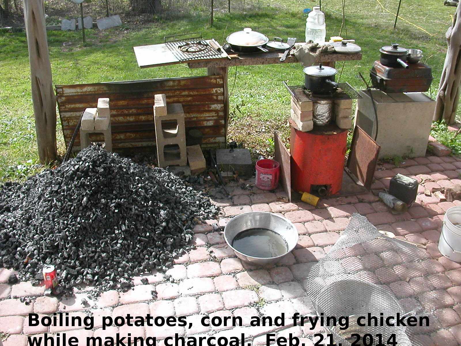

That’s a nice pile of charcoal! All that from that little stove? I’m impressed!
Maybe you could eliminate the soot issue by using a steel hot plate first and then sit the pots on top of that ?
Yes, it adds up. That stove takes quite a bit of fuel because the bottom part is a nine inch stainless steel cook pot with old stove pipe bolted in to give it a height of 20 or 24 inches. Inside that is a sacrificial liner of more used stove pipe that rapidly burns away. The grate is a worn-out ten inch Harbor Freight Carbide saw blade with holes drilled into it. I have recently been covering the grate with a layer of small charcoal brands so it will complete the charcoal making process. I noticed the blade was a bright orange color when I dumped the char, so why not use all that heat to finish off brands. Yes, my pots are covered with soot because cold water in a cold pot over a hot fire collects soot. I use cardboard squares as pot holders when I bring the pots into the house. (These get cut up as more starter fuel for the stove after they get covered with soot.) I also have my own stainless rack to hold all the cast iron pans and soot covered pans while they are in the house. It smells like Mesquite BBQ where the pans are stored. With my grid tied solar panels, solar clothes drier. and solar water heating (for showering), we are actually feeding excess power into the grid, even with an electric car. Cooking and heating water out on the patio makes this possible, while at the same time making bunches of engine grade charcoal.
