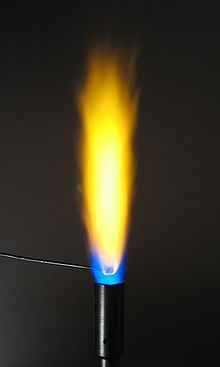

A flame test for sodium. Note that the yellow color in this gas flame does not arise from the blackbody emission of soot particles (as the flame is clearly a blue premixed complete combustion flame) but instead comes from the spectral line emission of sodium atoms, specifically the very intense sodium D lines.
