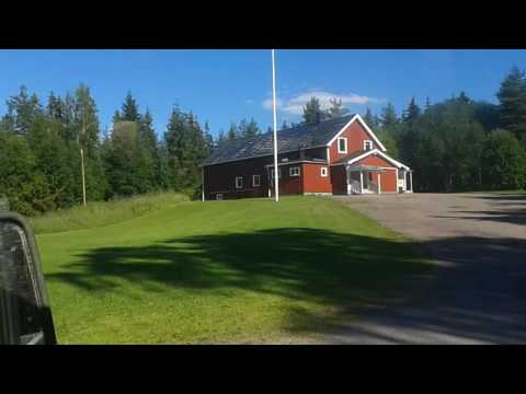

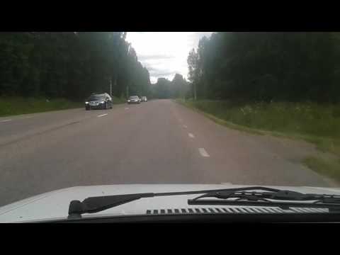

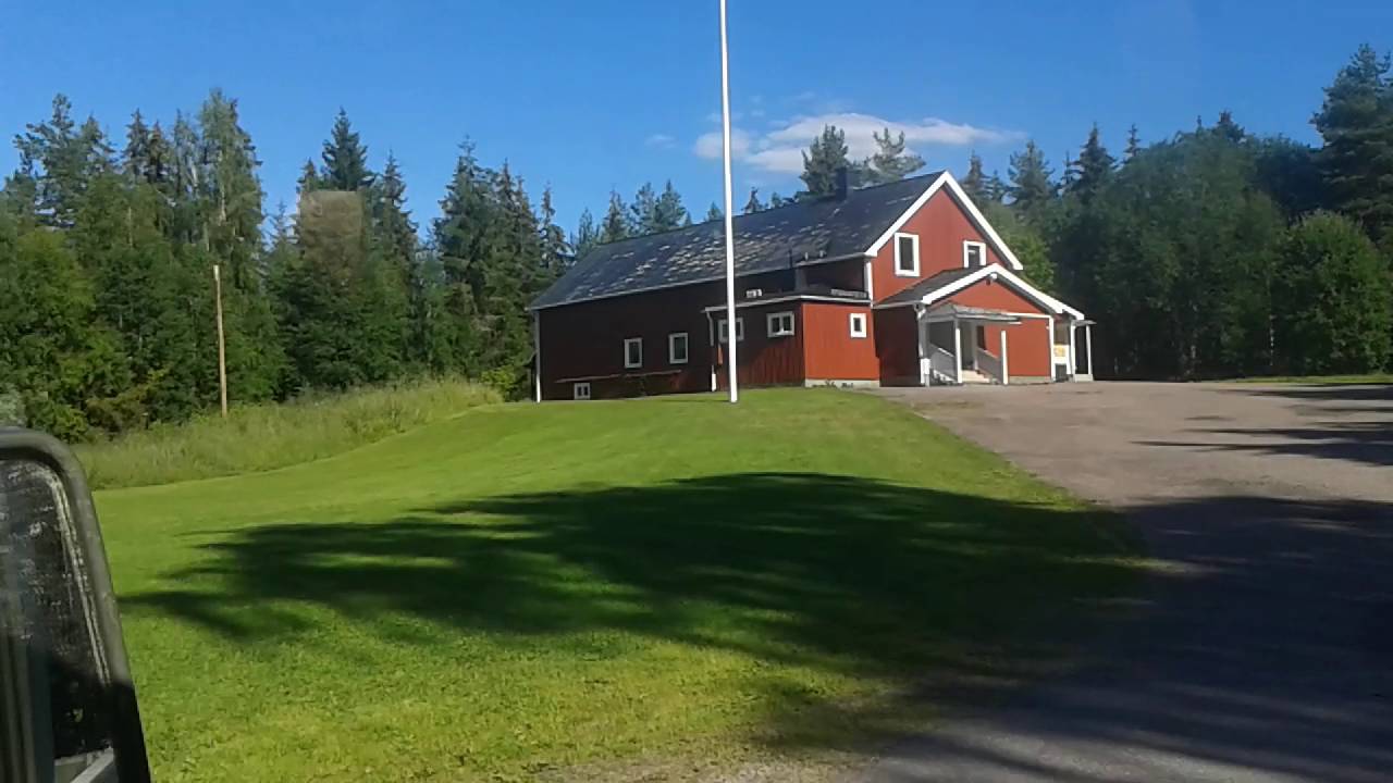

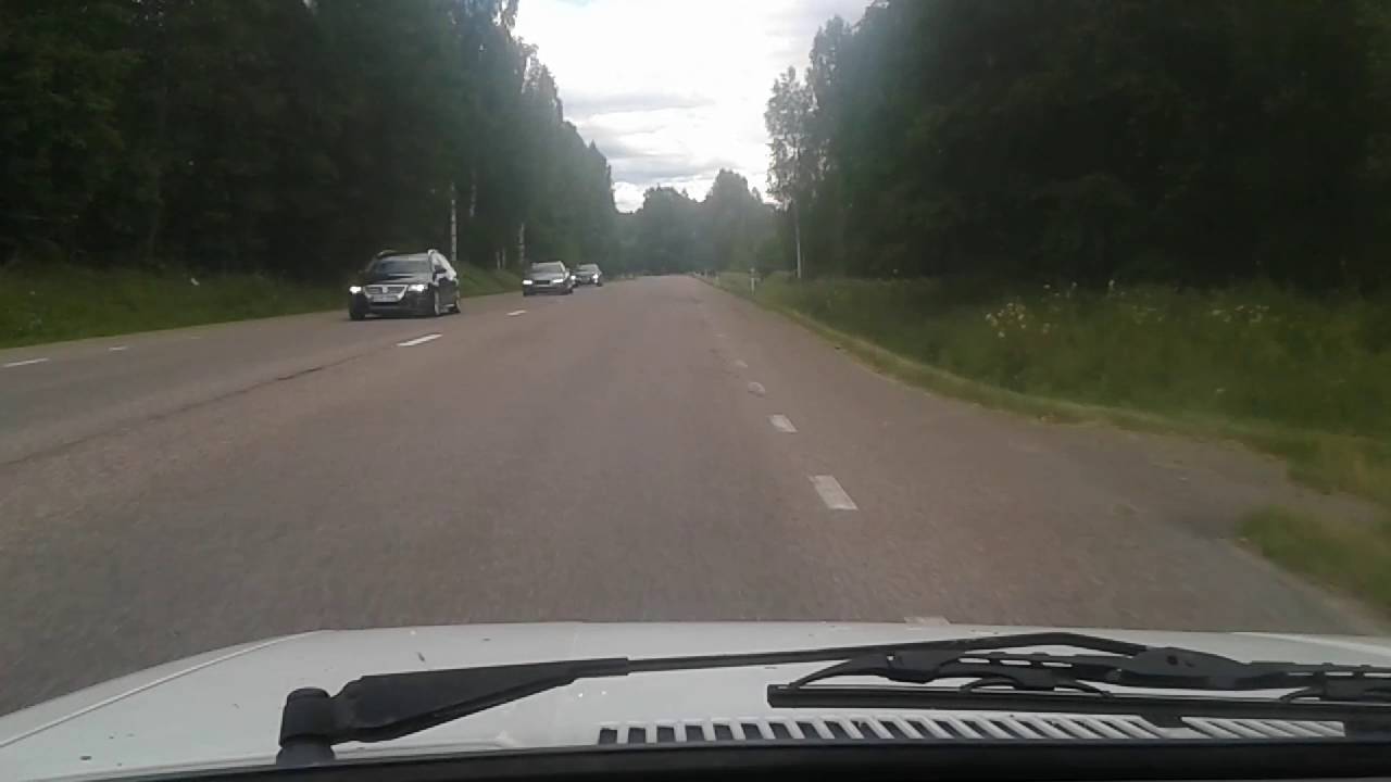

Around the village on wood. No guages (almost).
Thanks for the ride Jan. You sure have pretty countryside there. It looks like red with white trim is the favorite color for buildings there.
Wonderful trip around your village. Thank you so much. Beautiful to look at and gives us an idea what the country is like.
Thanks for the ride JO!!
Beautiful area !
Oh my gosh!!! I loved that ride through your area. I think Johan gave us a ride on youtube with the old fellow with the grey WWII truck through their area and I was impressed with the simplicity of the roads. I thought over the years that may have changed but I see it is still the same. As a whole, you have to be more relaxed people. Here we allow ourselves on hour to drive if someplace is 60 miles away and if we catch two stop lights in a row we go into “road rage”. There with the narrower roads and the winding between buildings you have to drive much slower and more relaxed. I do envy you that. TomC
Edited; The first time I watched this my audio was not working so I didn’t get the appreciation that you mentioned doing this for me. I even enjoyed it much more the second time. I have to ask— what are all the buildings in you village that look like VERY large garages or more like small barns? Go rent out that “party house” I think we would all like to come and see this in person-----during the summer. TomC again.
Hello Jo , I sure liked that ride .looks like your truck is running good to.
Calvin…
The copper mine in the town of Falun, 20 miles from here, was the world’s largest copper mine. It shut down 1992 after being active for more than 1000 years. Recidual product from the mine was " iron vitriol". It turns red when heated up. 300 years ago people started mixing that with rye flour and water and painted their houses. It has a very preservant effect on wood. Most people in this part of the country still use it. It has become a tradition.[quote=“TomC, post:236, topic:1928”]
[/quote]
They are mostly old barns or outhouses. People like to preserv them and make them into garages or guesthouses. Most want them to look old on the outside, but inside there is floor heating and modern standard.
