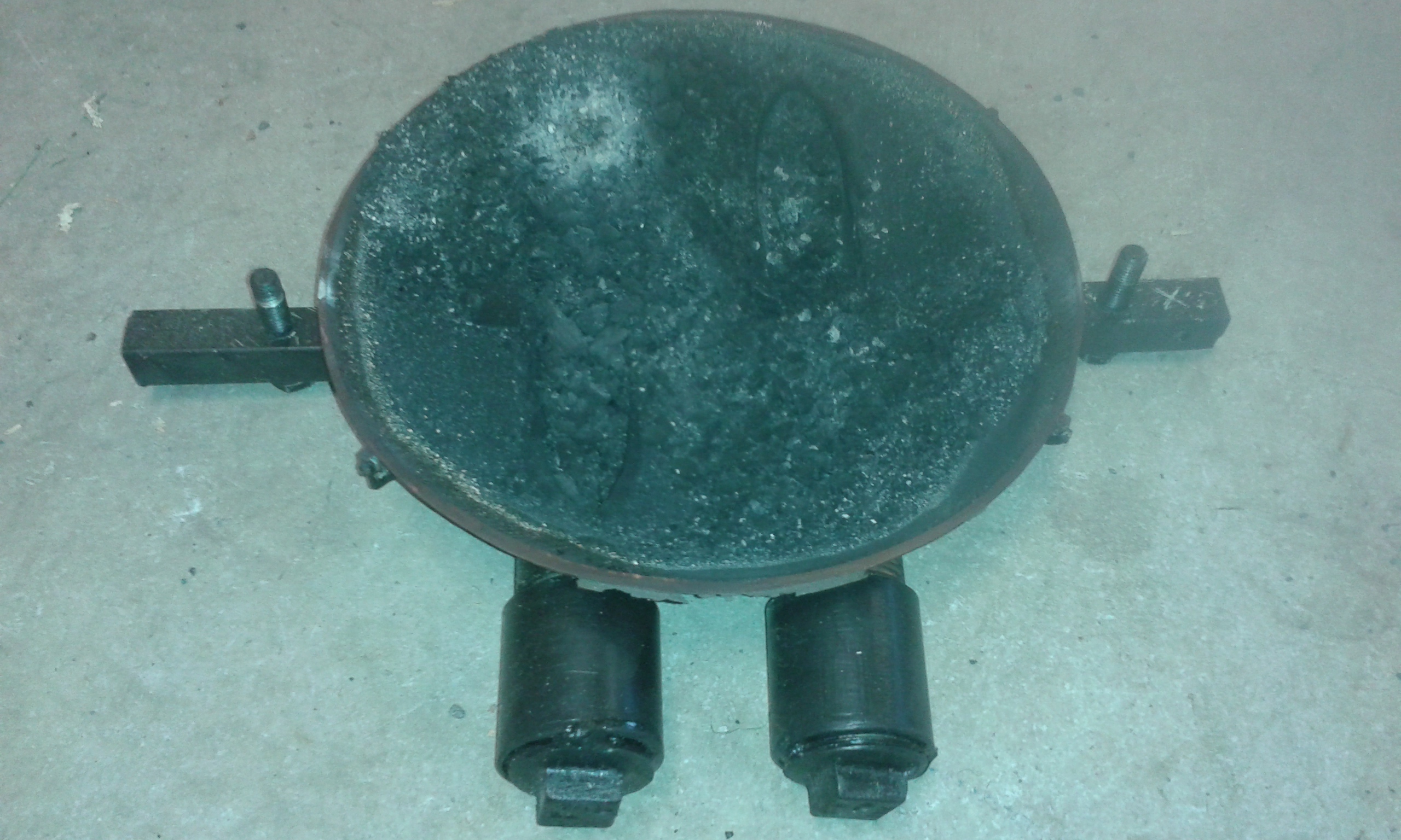

You may want to check to make sure ash has not accumulated up to your grate and if so empty ash and char,
You can also use your poke rod and with a twirling motion drill down to your grate and find a few holes and push your rod through . Also peck on the grate but try to avoid letting wood chucks fall in.( leaving a void.) . The intent is to give the air a less restricted path to the grate area.

Shake the grate and raise it considerably, until the pressure-drop ratio approaches 1:2 – 1:1 region.
Observe the grate temperature if possible.

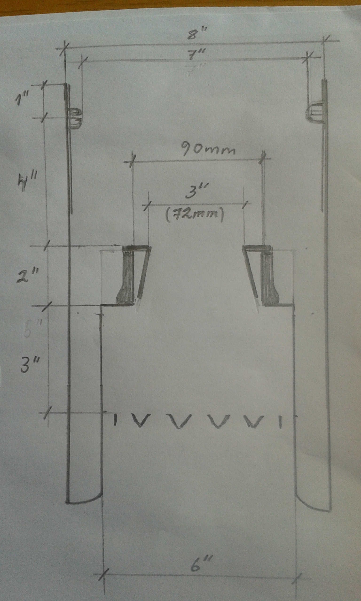

For later consideration: What is the diameter of the restriction?
I’ve heard about the female mind beeing simular to a gasifier’s, but what you suggest puts things in a new perspective :smile: Mine has a 3 inch restriction :smile: :smile:

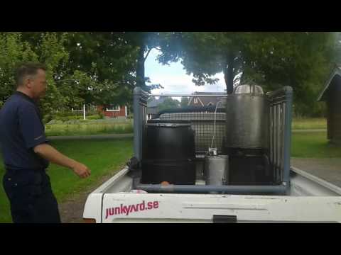

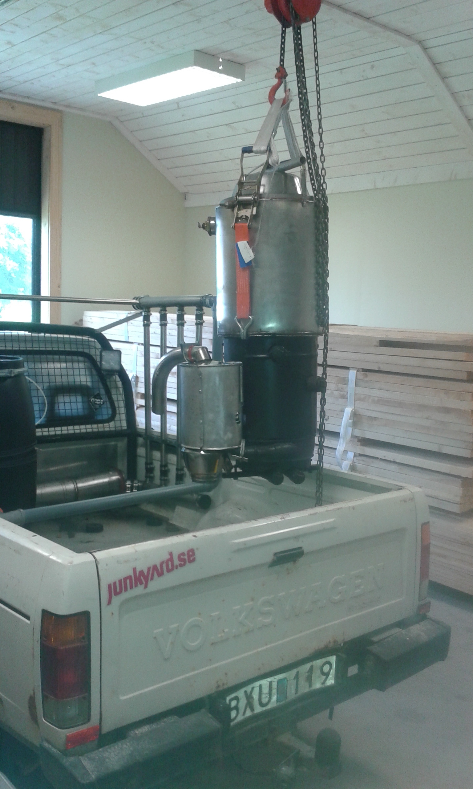

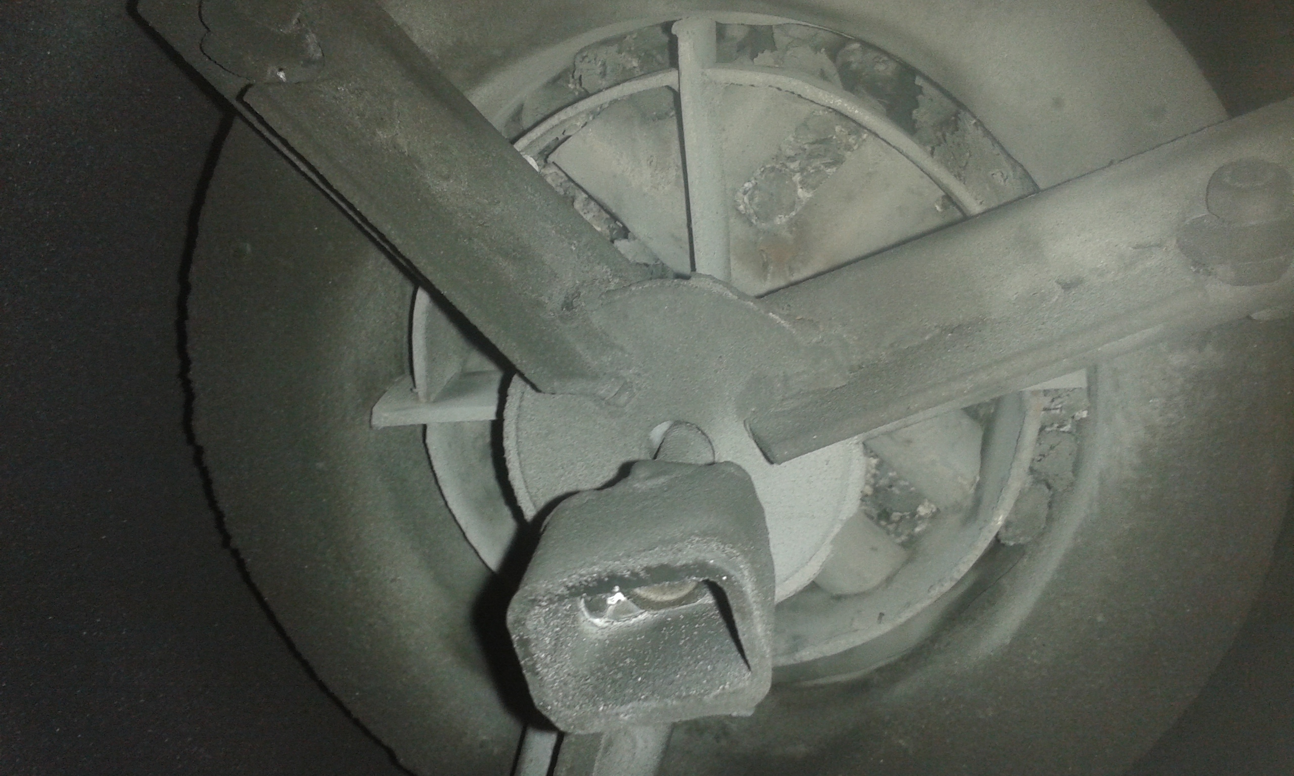

Opened up the bottom of the gasifier this morning. Discovered signs of a small wormhole at the end of one of my auger pipes. Patched it up.
Raised the grate 2" up into the reudction tube, put things back together and went for a ride :grin:
In the video I keep talking about inches of vacuum. My guages are mbar. 100 mbar = 40 in H2O.
The battery in the camera died after a while but after holding it down for a couple of miles I seemed to be able to burn out some fines and ended up with a 4:1 to 5:1 vacuum ratio.
I think I’ll leave it this way for a while. I can cruse at 60 mph with half the vacuum I pulled before. At 50 mph I pull less than 10 inches at 1/4 throttle. Outgoing gas temps from the cyclone are 30% higher than before and peaked at 300 C (572 F).

Another “Shocking” matter: I just calculated the volume of your hearth; it seems to be 1,67 times bigger than optimum on your admitted RPM for 100kmh… and egg-sized fuel.
Don’t worry, it can be “compensated” with taking off in the reduction end and using a bit bigger fuel and a few details.
Don’t rush in anything yet.
Satisfying the low end first… probably 1" more off.
How much is left after one more inch is taken off?
Another question: What is your nozzle-tip inner diameter?

Went to visit my sisters at their forrest lake cottage last evening. 60 km on gravel roads. I was afraid charbed would get compact but instead I got 3:1 readings. Engine seemed to like it but gas temp climbed more easily. I think I’ll stay at this grate height for now.

But, also the nozzle-tip inner diameter, (hole) ?
What is the condense water temperature under the cooler at the end of a longer road trip?
Have to re-calculate, as the nozzle-tip circle has been reduced… getting better.
Nozzles are 7 X 7.5mm ID.
