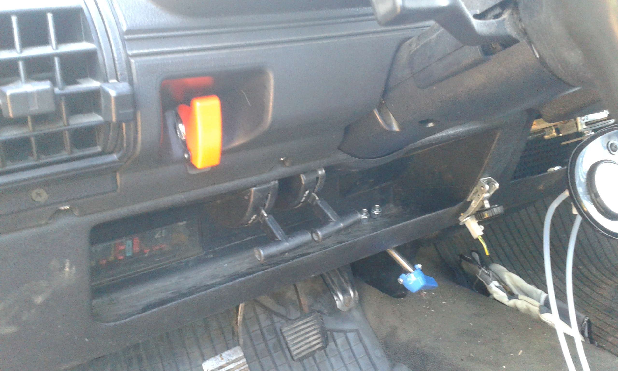

maybee l missed it but how do you set the air/gas ratio? l cant realy see a lever or anithing in the video of driveing.
I have two old lawnmower levers. One woodgas, one air. Both forward is gasoline setting (gas closed, air open). Red switch to the left is fuel pump. To the right is the idle knob. The blue handle is an extra air valve, which is not in use. I thought I needed that for hybriding since this is constant spray Bosch K-jet. But lambda seems to by able to compensate somewhat for rich mixture, lowering fuel pressure.
