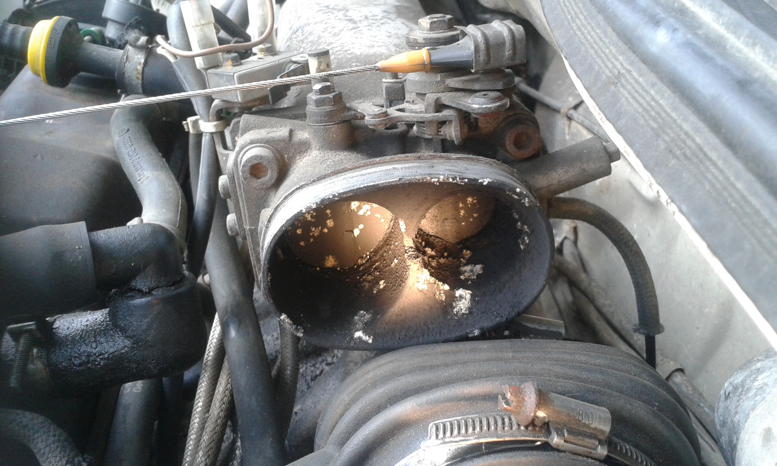

When out for a ride today my throttle got stuck wide open.
I actually have two butterflys. The big left one only opens when more than half throttle. It stayed open and the truck kept running 50-60 mph.
This is when you are lucky running woodgas and you have a few extra levers to put in use. Went the rest of the trip home hanthrotteling with my woodgas (and air) valve. No big deal.
When I got home I discovered some soot bildup. Not much but enough to get stuck. Still only just above 1000 miles on wood.
Cleaned it out a bit before the next ride - going to work. Gasifier still hot. SWEM.
Is this white stuff oxide? Was it been there before the woodgas?

I was surpriced when I discovered it. I was in hurry fixing the stuck butterfly before going to work and I didn’t wear my glasses but my first thought was mold. Max is probably right about it beeing ash. It does however look like it’s created on the spot(s) and I wonder if I I’ve had some small backfires lighting the soot. I recall some small stumbelings when going WOT.
Anyone else having these white spots in your intake?
