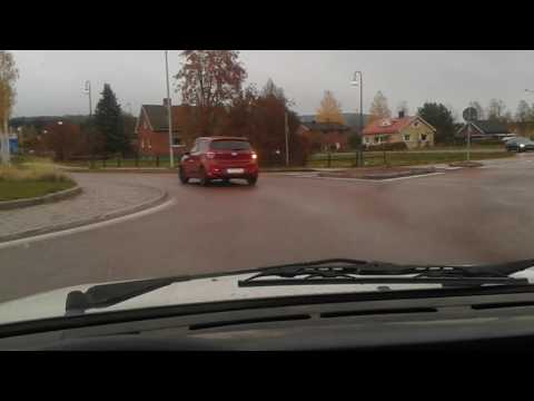

I’m at 2235 miles on 99% wood since July. In fact I haven’t driven on dino at all since then, apart from startups and minimal hybriding. I’ve consumed maybe 3-4 gallons tops. Oh, maybe another 3-4 gallons for firewood gathering with old Fergie.
This is a typical drive. This time going to the store.
Apart from adjusting my air valve pulling woodgas to the engine leaving home during warm up, I didn’t touch it again. Not even leaving the parking lot at the store. Apart from lighting up and adding wood there is little difference from driving on gasoline - much cheaper of course

Thank you for the early morning ride. Always enjoy it. How do you hold your camera while you are driving??? I have tried videoing while driving and if I posted it you would get “sea sick”.TomC
I just hold the phone in my hand. But yes, I could use a third hand from time to time. It gets a little shaky with a stick shift and all.

I have never seen my rails go over 15" of water vacuum. Is your gauges in MM?
I noticed your gauge approach 40?
Nice ride JO. When the motor dies as soon as you shut the inlet air, and no smoke shows, it’s a good sign of a tight system. Your English is very good. Driving a WG Rabbit, filming, and translating in you mind all at the same time is enviable.

Thanks for the ride JO. Seems like I was sitting right there with you. What makes that ratcheting noise at 2:45?

They are in mbar. 100 mbar = 40" H2O
The 40 mbar in the video means 16" H2O.
This means needles move the same as yours ( If you have 40" guages)
Only England is consevative enough to stay left
Lot’s of noice in this vehicle. I think this was only something rolling on the dash. The camera picks up more than I hear.

I think this Rabbit has a very primitiv computer. I wouldn’t even call it a computer. It’s a lambda and a regulator that adjusts fuel pressure, nothing else. Lambda has to be warmed up of course, otherwise it’ll run very rich when hybriding.
I like to keep it simple. I feel no need for automixing. I don’t move my air valve a lot while driving.
I’m sorry to disappoint you but there’s really not much to tell about the air/gas mixing. Homemade valves/dampers inside pvc tubing. Air and gas meets in a Y.
The valve butterflies are made of a plastic paint can lid and pressed into slots in the bolts (shafts). Slots are made with a thin blade in the grinder. Rubber brackets on the ends of the bolts. Lawn mower cables for operating. Nothing fancy.
