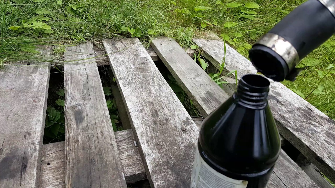

The new pine slab fuel sure generates a lot of tar. Seems I’ll be able to collect a pint a week from now on.

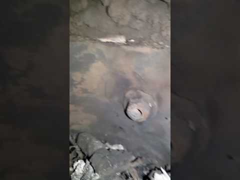

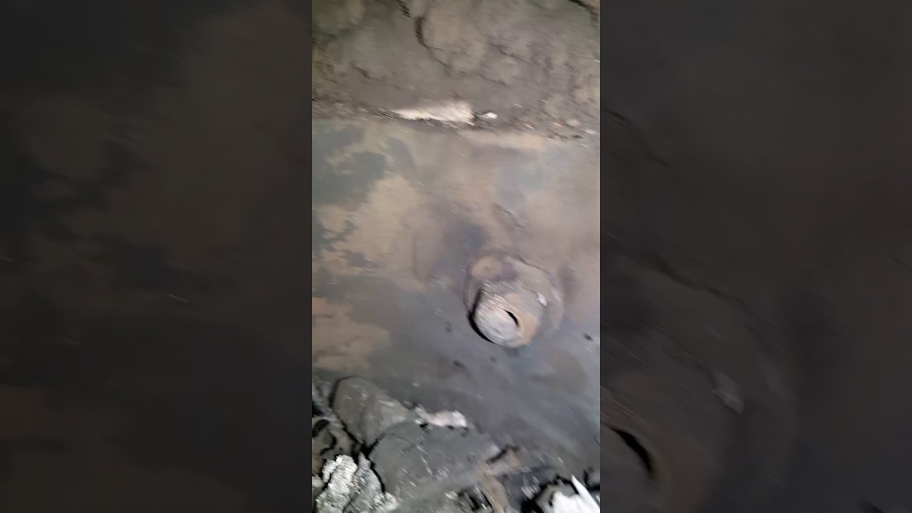

A full year of every day DOW is getting close. 7k miles and a sudden power boost yesterday made me want to check the state of the firetube. I wouldn’t like to see a burned out wall and a super nozzle.
I’ve got thin ss plates as protective shields and they seem to be in good shape. I can’t see no wear and tear what so ever in the hot zone.

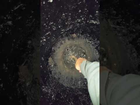

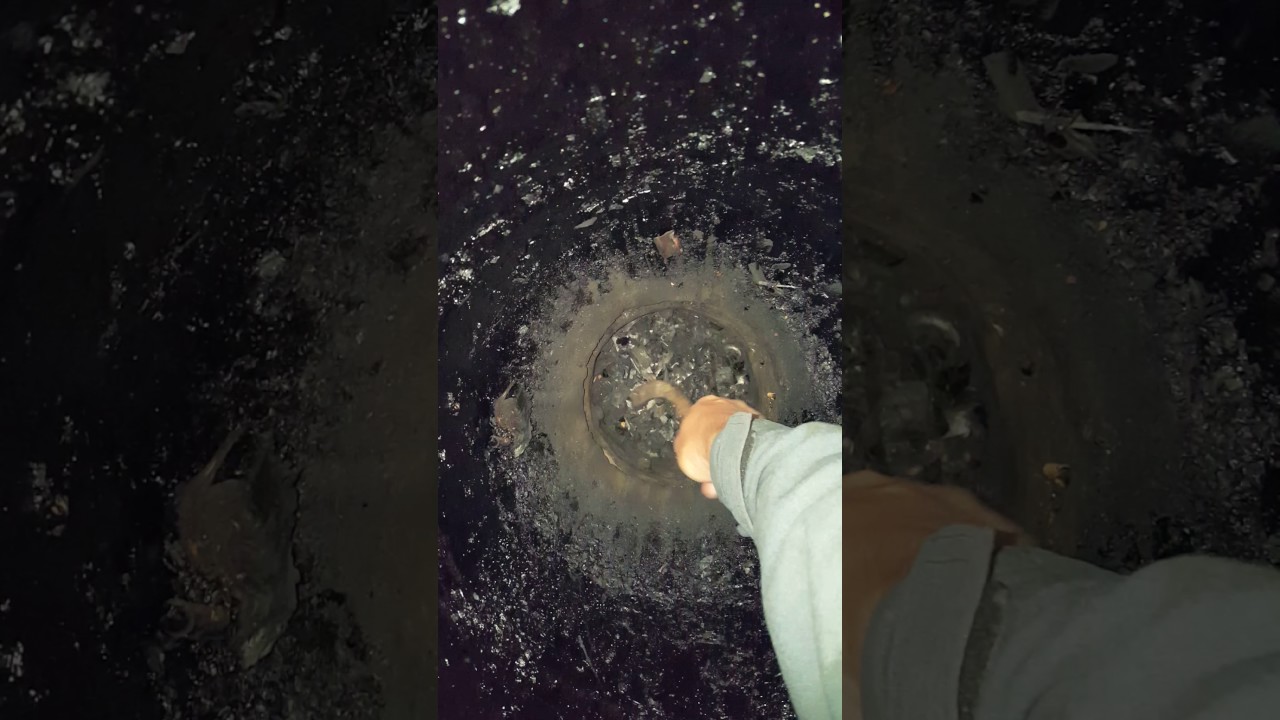

Also I took the oppertunity to punch a few holes in the tary crust under the funnel fingers to get the hopper circulation going.
The camera mekes the hearth look 30" not 8"
I see those hard crusts everywhere in the gasifier. Wonder what they are. My guess is its a cheramic made from iron carbides/oxides and ash fused together by extreme heat.
Ok. No supernozzle. Whats next?
You´re the chemist. I´m fine with just a “protective crust”
Well, I shouldn´t be trouble shooting when things are running at its best. I think I´ll settle with the combination theory of high quality pine slab scrap and that I reasetly cut open my air inlet pipe some.
