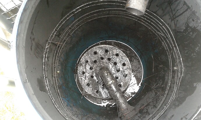

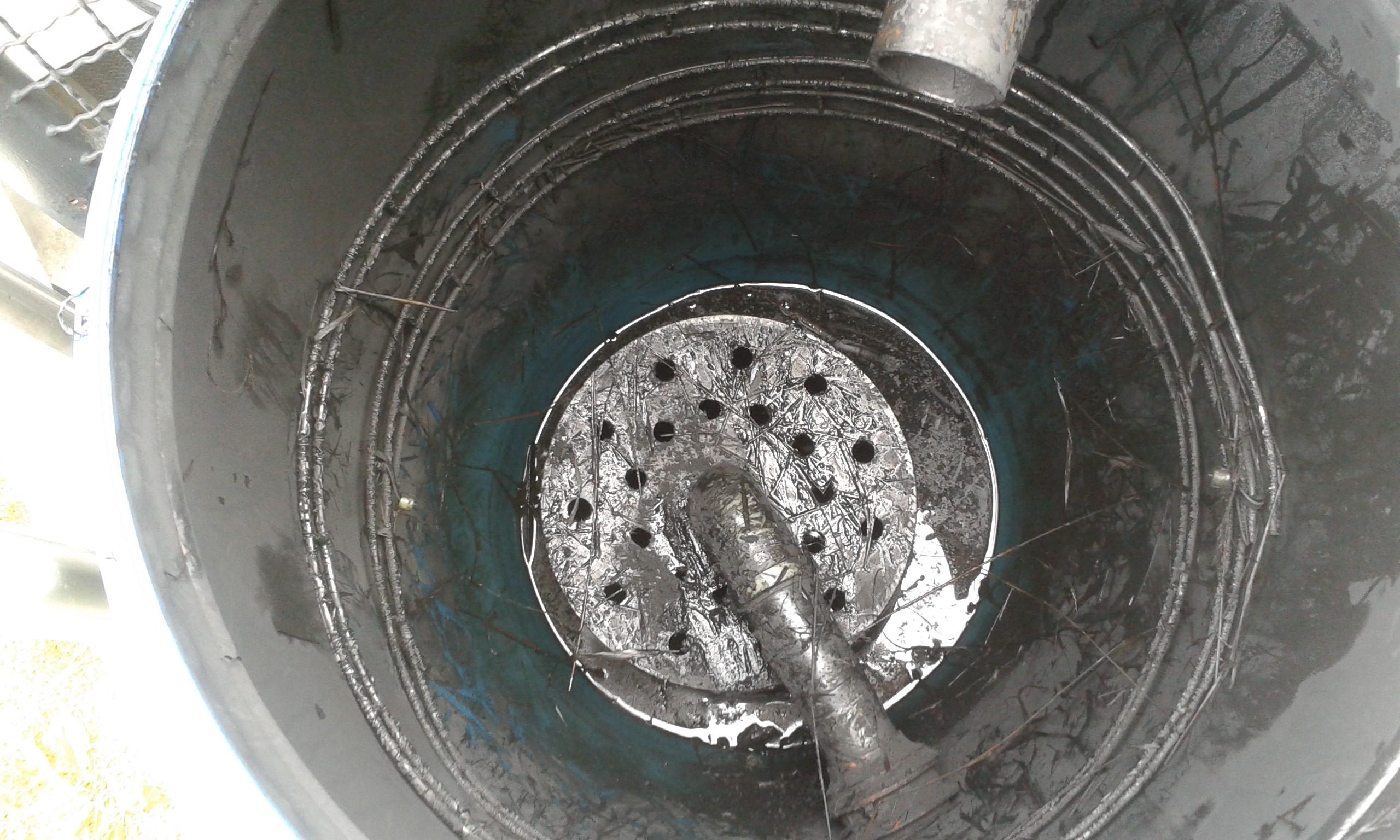

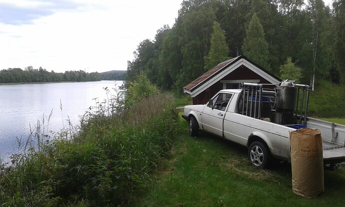

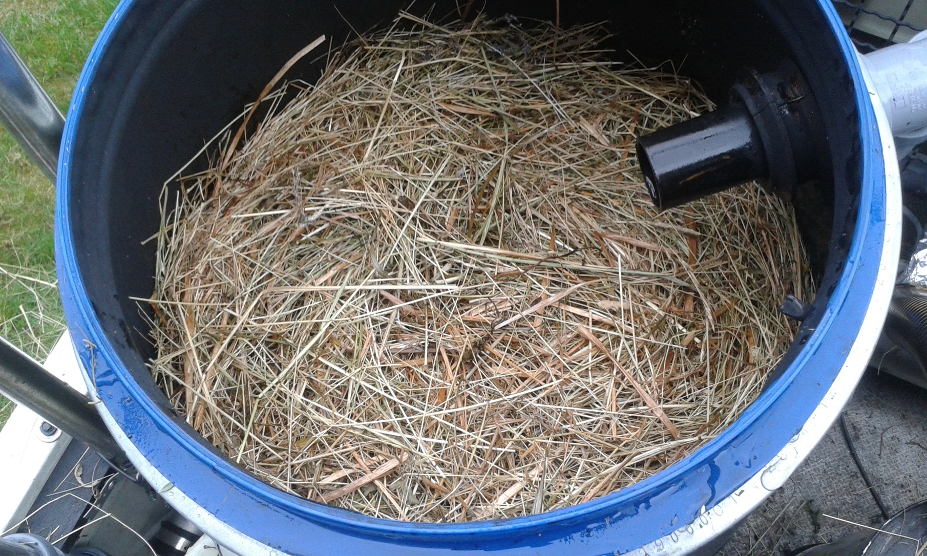

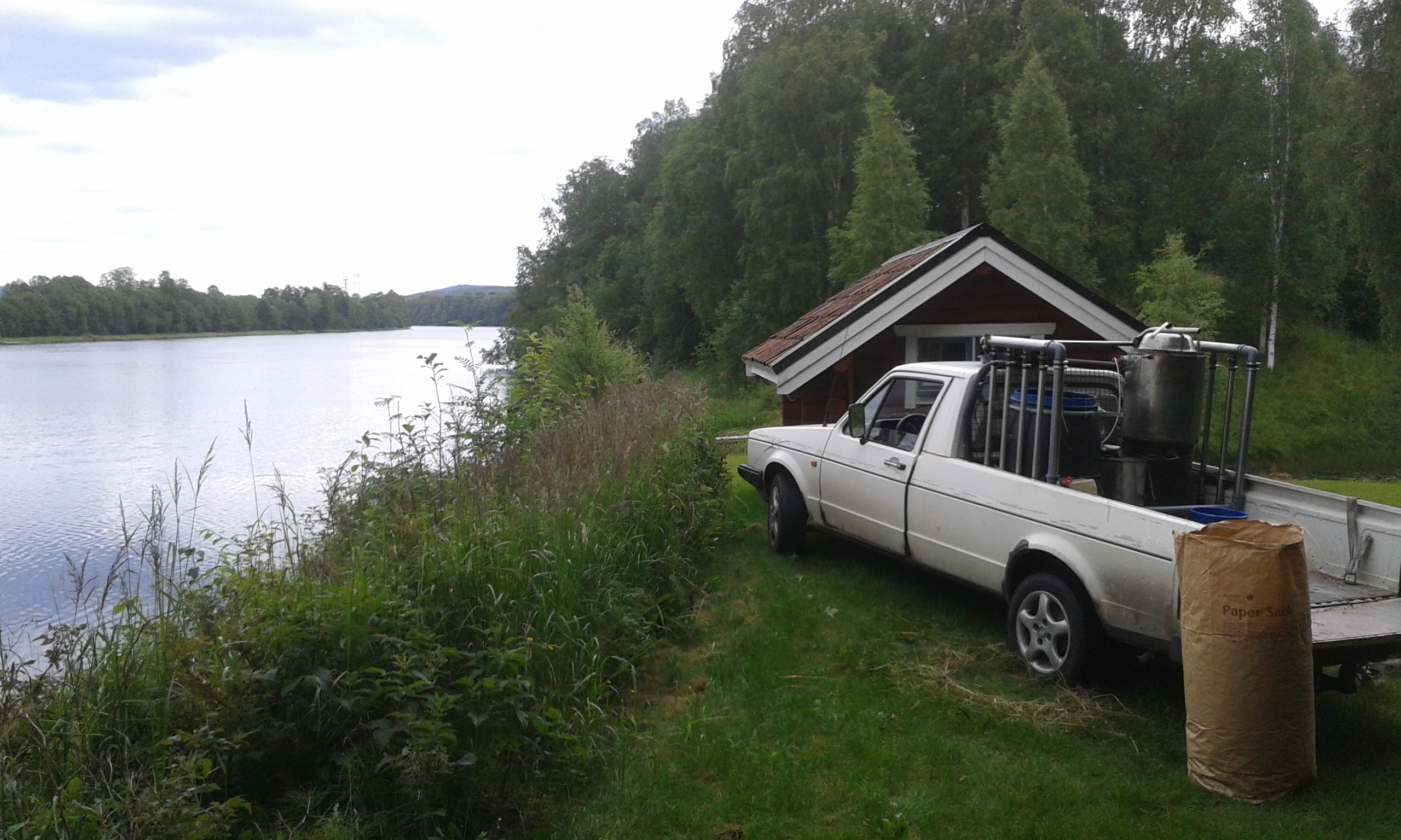

The one and only annual hay harvesting up here is complete. Fresch gasifier filter material available. Went down to the river to change it out. I was about to take a dip as well, but I chickened out
Water temp is probably less than 15C (60F). We have had no real heat this summer.
There was really nothing wrong with my old hay. I´m sure i could have used it another full year. Woodgas and the lack of oxygene seem to do a good job preserving it.
2 inch outlet from the barrel?
Yes, one 2 inch in and one 2 inch out.
Interasting solution on anti barrel colapse. I had 3 rings of 6mm rebar in, got constipated once, pressed the gas pedal a bit harder once, BANG, the barrel looked like a vacuum bag
you have thicker ones?
Thicker, I don´t know. Mine did implode some last summer but I´ve managed to get away without any colapse ever since i installed the reinforcement. However I try never to pull more than 30 inches of vacuum.
Time to gather some spare hay for replacement or a second filter?
Already done
