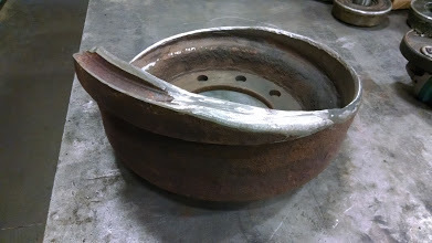

Good ideas guys. Yeah I have another truck drum that I could maybe use. At least I know that it would be balance. I am also using one of those for my cutter however I had to cut about half the weight off. The outside of it has that ring that makes it about 1 inch thick of steel.
Took me one and half cutting discs to remove that band. Hmm wonder if you could attach that band to the other drum to increase the weight
Same for me Tom, lots of grinding bu worth it, it is some tough metal.

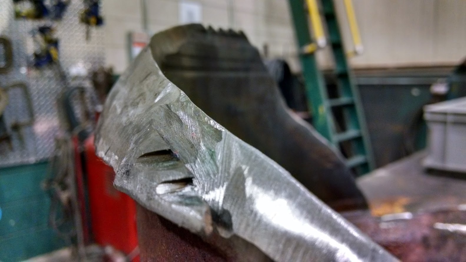

Here is my blade, before and after grinding… Still have more to grind. I heat treated some of it as well. (where I am done grinding)
Good luck with the new blade idea. i was thinking on adding supports too the truck rim and useing that for the cutter chunker. Not sure if that was tried or worked or not.Actually the drum like you are grinding would be harder steel i suppose,and take longer too dull.
I can’t help but notice that you put your bevel on the outside of the cutter edge, while I believe everyone else has sharpened the inside. I’m interested to see what kind of effect this has.
