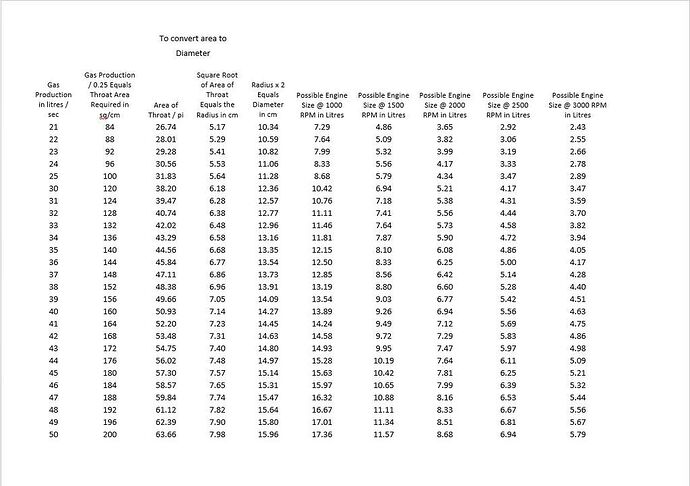

Interesting table that was posted on the yahoo groups by my buddy Stephen… nice to see that my spreadsheet i use adds up to the same.

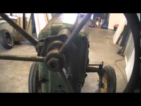

Got off the phone with my customer and it looks like he’ll be bring the tractor up so I can have it tuesday morning… almost excited even
Good Arvid! Keep us posted including pictures. Those M models have the vertical inline 2 cylinder engine with the narrower stance that gives more room on the sides for the gasser and filter/cooler stuff. Good displacement size for a smaller gassifier too and with the heavy flywheel it should turn good on woodgas.
Cant wait Arvid driving the Farm All M was a blast!!! this alone was worth all the hard work!!!
Look what showed up this morning.
Get ta work man, the clock is tickin :slight_smile:
How’s the engine sound?
TerryL
Looks good Arvid. Did you put the front platform on it or did the owner do it to your size specs?
Nice project Arvid !
Thanks for the video , keep us posted
Terry, the engine sounds very nice… old tractor sound, but right… if you know what i mean.
Don, customer built the platform based on my recommendations… he knows i’ll probably cut it up some but he’s more than ok with that. He attends a lot of steam shows and is looking for something that will spend most of it’s gasser life idling, and maybe doing the occasional parade. Compact is what he wants so that is what he’s getting.
I’ll post stuff up as I get it done Wayne… I’m looking forward to hearing this thing run on wood.
