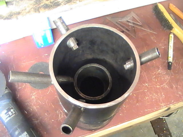

I know I know, it doesn’t look like much… but the main parts of the hearth are there as well as the parts for nozzles. If i can find a 1/2 drill i’ll get atleast this buttoned up today.

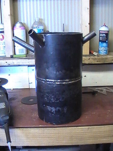

bit welding done… just need to fully weld in the nozzle tubes and then i can start lookin at the hopper and lower mantle.

Are your nozzles made out of sparkplug sockets for a ratchet set? Awesome.
Great looking tractor too.
lol… no just inside threaded pipe… pipe plugs will be drilled for nozzles after testing for air tightness…

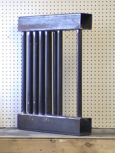

Can anyone explain the reason for square tubing with round pipes for me?
its a double row of tubes… total of nineteen… would be hard to do that with round manifolds, there will also be a top and bottom cover plate that can be removed for cleaning if need be

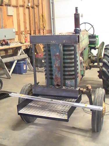

12 tubes welded in… 7 more to go…

slowly… getting there… 5 more tubes to weld in… and you can see the top removable plate… once it’s all welded together i’ll cut out the access openings under it.
Looking good Arvid !!
Thanks Wayne… i’m trying…
