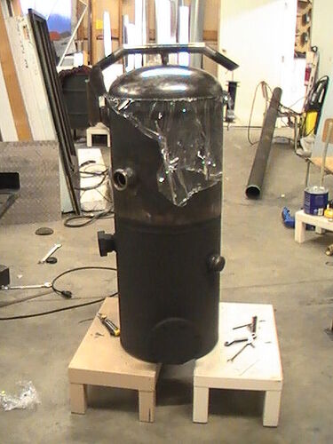

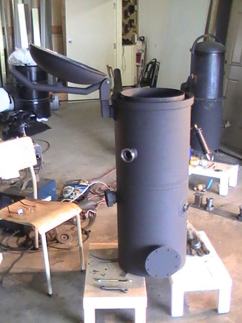

lid parts coming together… rope and silicone for the win.. cling wrap between anything I want to separate easily :slight_smile:
I suppose if I get the lid hinge and hold down finished nothing is really stopping me from flaring… Hmmmmm we’ll see…
Like the concept
Hi, Arvid!
Let the silicone stiffen throughout before applying pressure, otherwise the “internals” may spray out!

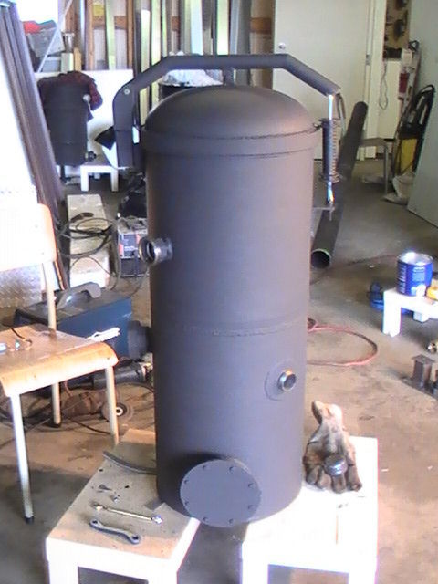

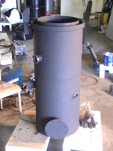

a few more pics of the finished reactor…
painting some parts

Would you show a pic of how the lid gasket looks done?
I did mine kind of like that but used wax paper, pulls off ok IF you put the dullest side towards sealer. Does that plastic pull off good?
You are doing a real nice clean job!!!

new pet peeve… flat black paint that isn’t flat…
A little shine won’t hurt - it won’t stay that way anyway :slight_smile:
